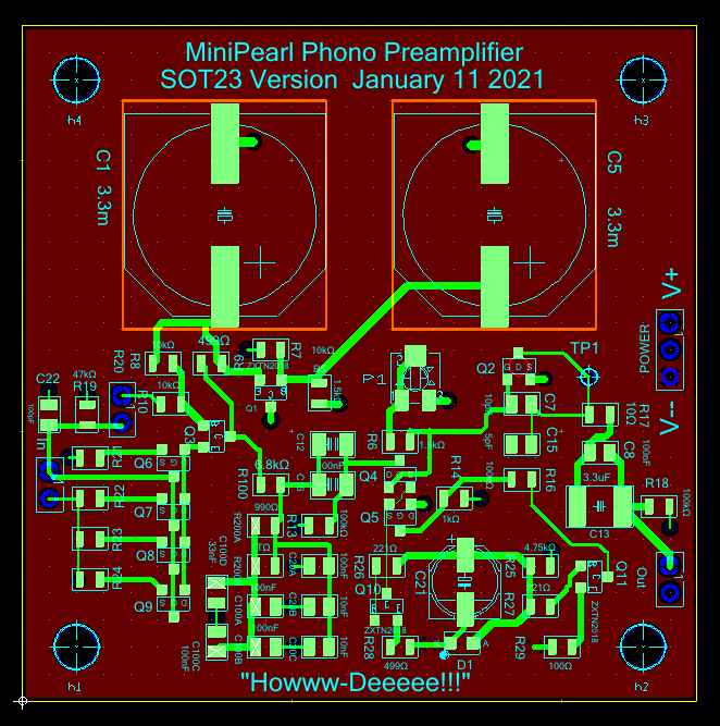

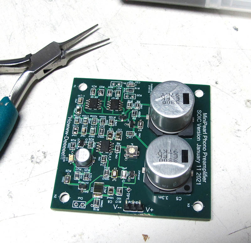

Almost all the passive parts are 0805, save for some of the caps which SYN08 had recommended -- these are acrylic and a bit larger and more expensive.

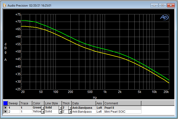

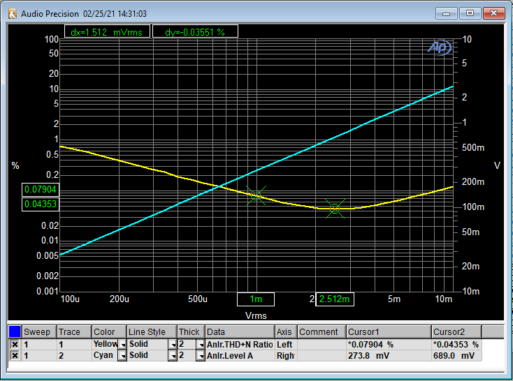

Output stage works like a champ! +40dB on the nose. Comparing the SPICE models for the through hole and surface mount output MOS are identical.
The passive RIAA network -- will need careful selection of components as it's time consuming tweaking SMD. I might even go for through-hole components.
I used a 270 degree SMD trimpot, this will have to be changed out to a multi-turn trimpot.

NAC Semiconductor is now a distributor for LinearSystems. I've ordered some LSK389 which is SOIC8, and LSK170B in SOIC.
The footprint would be a bit larger, but perhaps 1206 instead of 0805 passive devices. I think Jan had mentioned that the 1206 have better thermal performance, not that we're gonna be cooking!
What kind of IDSS matching did you get between the LSK389 SOIC8 devices from NAC?
Darned good, each half of the '389 +/- 0.1mA Idss.

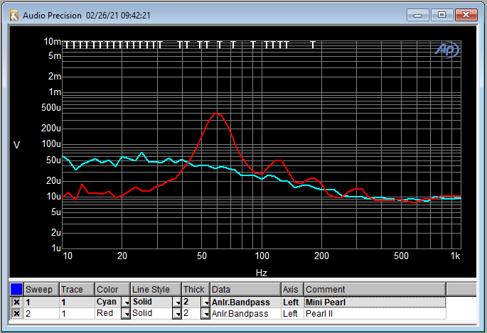

The point of the exercise is to use a board which minimizes mains pickup and retains the great qualities of the PASS design and put it in the public domain.

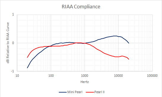

Here's the RIAA compliance without trimming, just measuring the capacitance and resistor values to get close. The rolloff to 20 Hz is attributable to the 2x 100nF capacitors feeding the second stage.
