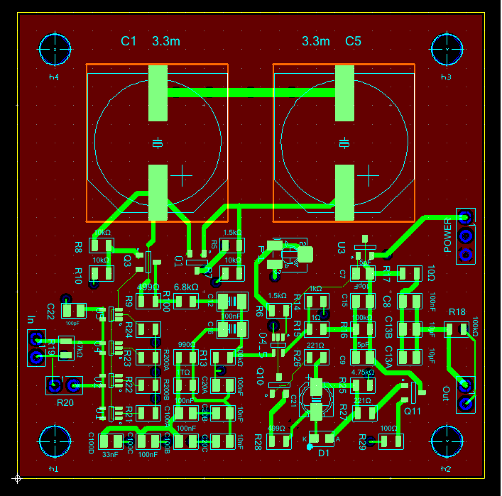

pretty much Wayne's design except for the use of NSVJ5908 dual JFETs throughout, and a SMT P-Channel similar to the ZVP3310. The NSVJ5908's have a 1dB noise figure and transconductance of 35mS.
It will have to run cooler than the "real" Pearl as the OnSemi JFETs have VDS limited to 15V. The 3,300uF caps are also a limiting factor.
Made the decision to keep the regulation off this board, and to use a 4-layer board.

I tidied it up a bit, and have had the time to work with the NSVJ5908 JFETs -- they are only slightly noisier than the BF862, and in quantity of 10 about $0.75 apiece. (I did get an SMT test adapter which allows rapid matching with my Peak).
Placed as many of the circuit traces as possible on the topside. Inner Copper 1 is Vcc, Inner Copper 2 is Ground, Bottom Copper is Vee.

The JFETs are RF devices, in most of the low noise amplifiers it's sometimes necessary to isolate each gate with a 200nH ferrite bead. I am trusting to the fates that the low impedance of the damping resistor and capacitor attend to this.
The boards are designed 2.500 x 2.500 inches. Ebay has quite a number of sellers of "Rectangular tin box" that would fit a pair.

What’s the intended PSU voltage?
Not +/- 24V!!! -- the NSVJ5908's are good to 15V.What’s the intended PSU voltage?
Perfect. I have a SuperReg needing something to do... 🙂
You could also run it from a "Silent Switcher" --
There may be one or two resistor parameters which have to change, but it simulates pretty well @+/-15V
