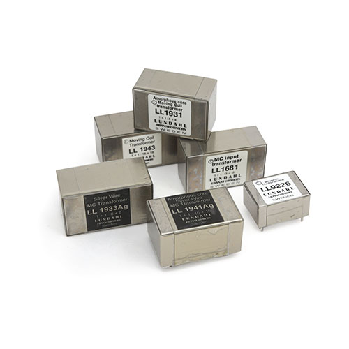

Easy way is to use a special transformer for this(mc stepup transformer).

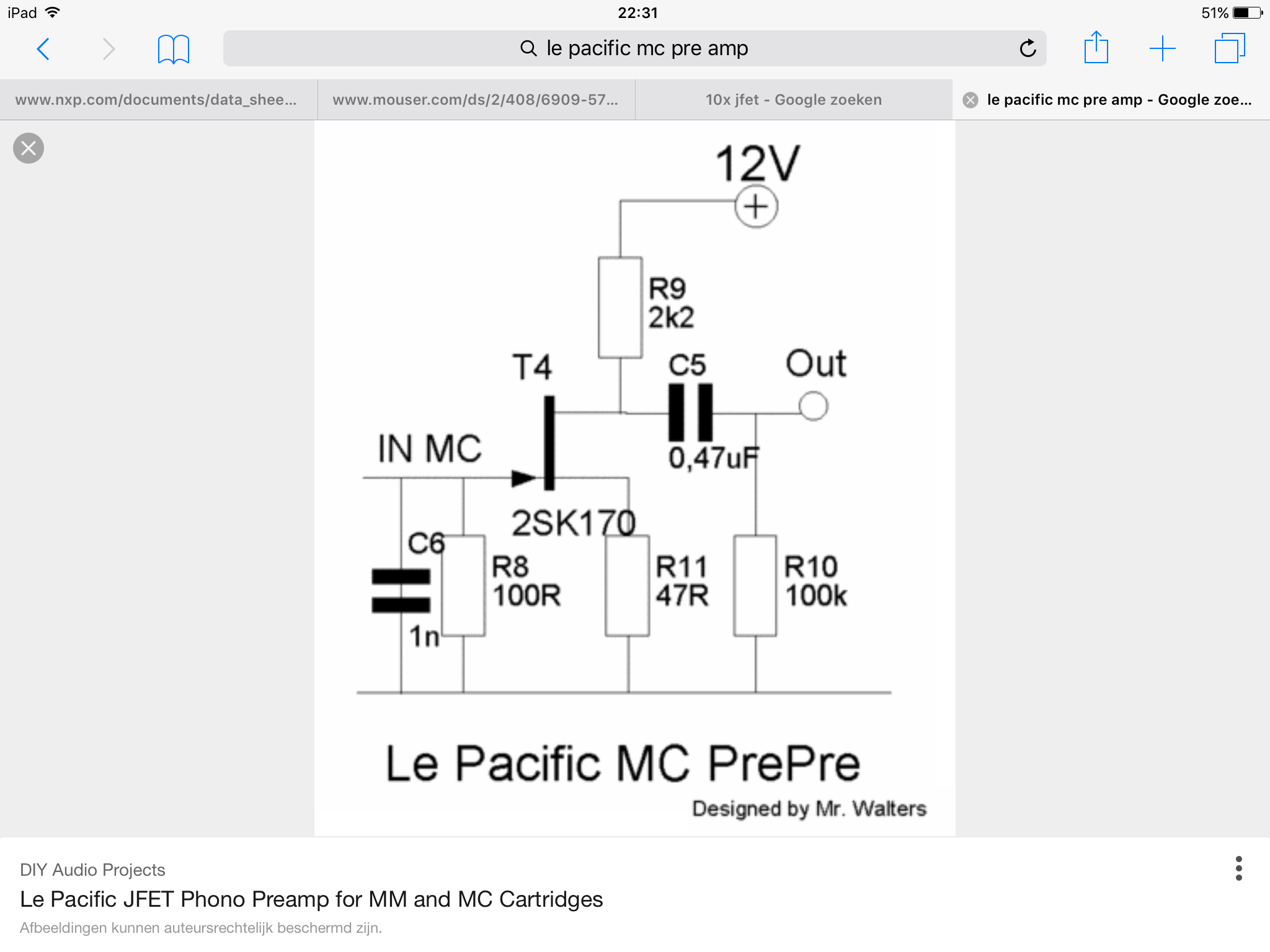

An other good way is to use a FET preamp stage like the Pacific MC pre pre.
