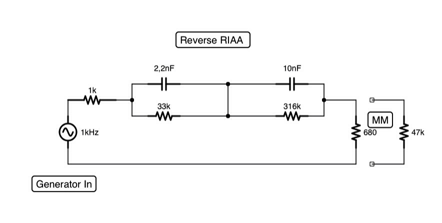

Today i did some measurements with a reverse RIAA circuit(+/-0.1db).
I like the results.
I like the results.
Excellent result!
What is the tolerance of your reverse RIAA? My best one (commercial) is +/-0.1dB.
I'm too lazy to do this, but many audio test programs will allow you to run a generator sweep file with as many points as you can stand to calculate values for. (Probably write something for excel or the open office equivalent) This of course would remove the uncertainty of the reverse eq.
FWIW I've never thought it worth the trouble. 😀
The reverse RIAA circuit is better then +/- 0,1 db. Beter then that i can not verify because my measure equipment is not better.
A lot of people use ARTA software with a good soundcard on the PC. They use then a inverse RIAA file.

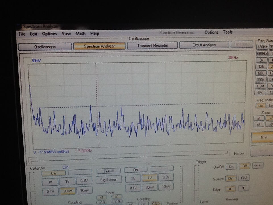

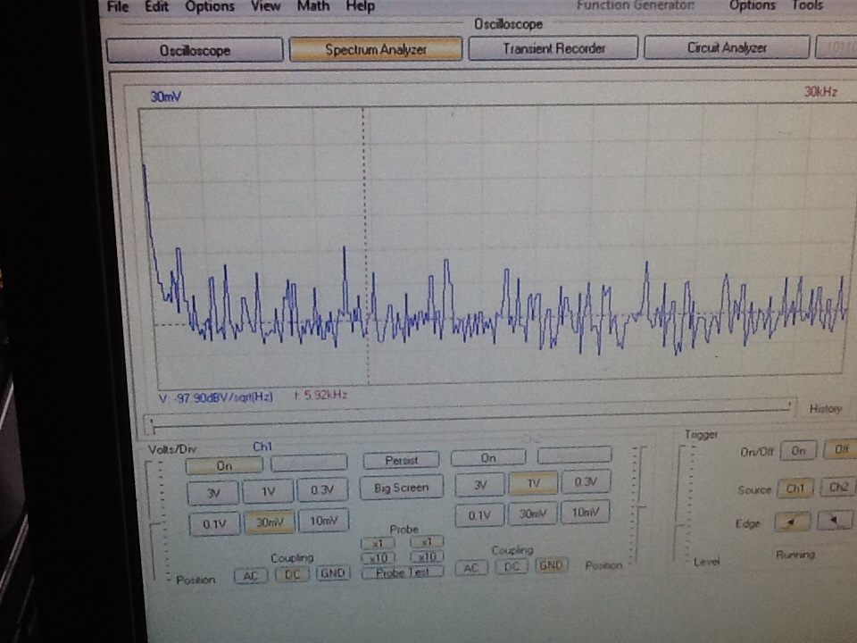

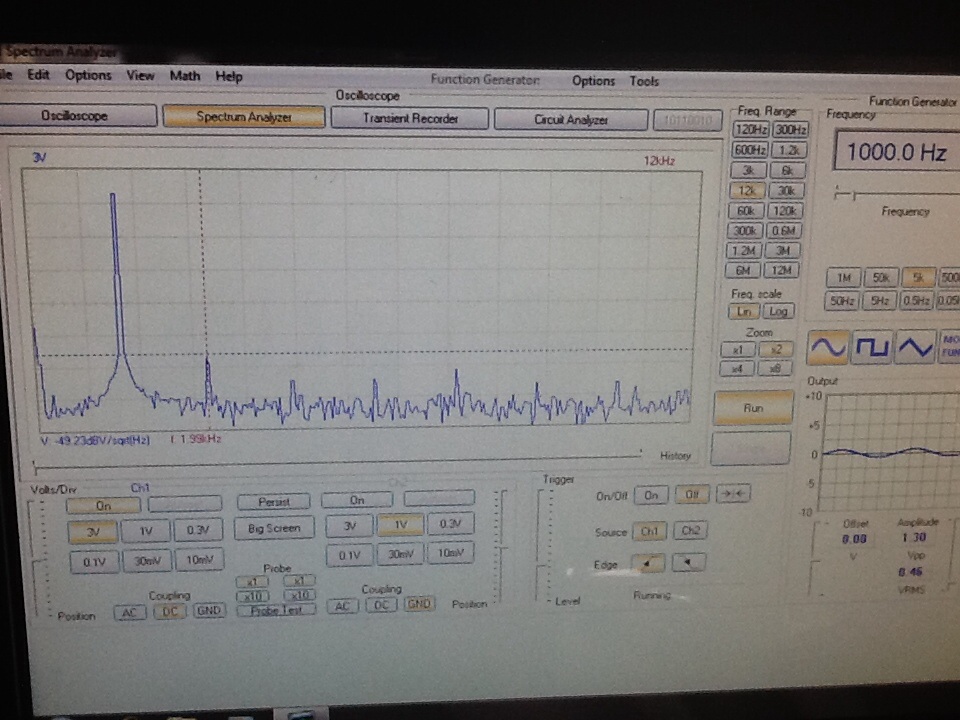

I did some more measurements.
But i do not know with one is good according the noisefloor.
Graf 1 = -78db
Graf 2 = -97db
There is also a graf with harmonics.
2nd harmonic = -50db
3nd harmonic = -60db
Graf 1
Graf 1 = -78db
Graf 2 = -97db
Graf 1

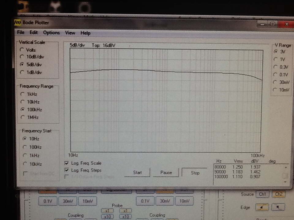

Here the specs according to the measurements at the MM stage,
Amplication = 350x
RIAA curve = +/- 0,5db
SNR = -78db
THD+N = 0,0135%
Channel separation = 47,3db
Total cost for the project, about € 100,-.

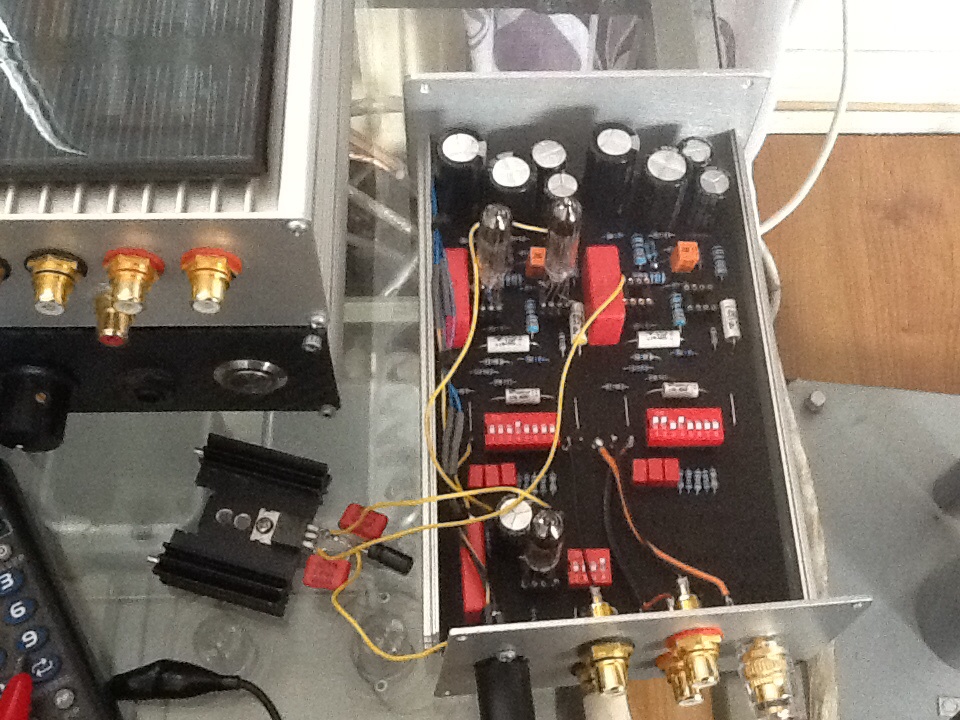

Today i build one MC stage for testing purpose.
I discovered a fault in the PCB at the MC pre input, i shall correct that a.s.a.p.
I am very happy about the 6N16 tube. This tube has in the MC pre very little hiss, no humm, very little microphonics.
