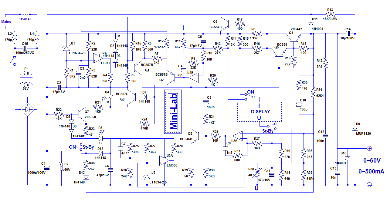

Here is a small (but important) revision of the main section.
I noticed that during power-up and down, the output voltage became uncontrolled.
As it could damage sensitive circuits, it was necessary to fix it.
The cure is the addition of a resistor R45 of 1K8 in parallel with the diodes supplying the reference for the CCS biasing the output ballast:
attachment.php
This forces the ballast to shutdown earlier than the rest of the circuit, thus muting the output when the non-regulated voltage is too low

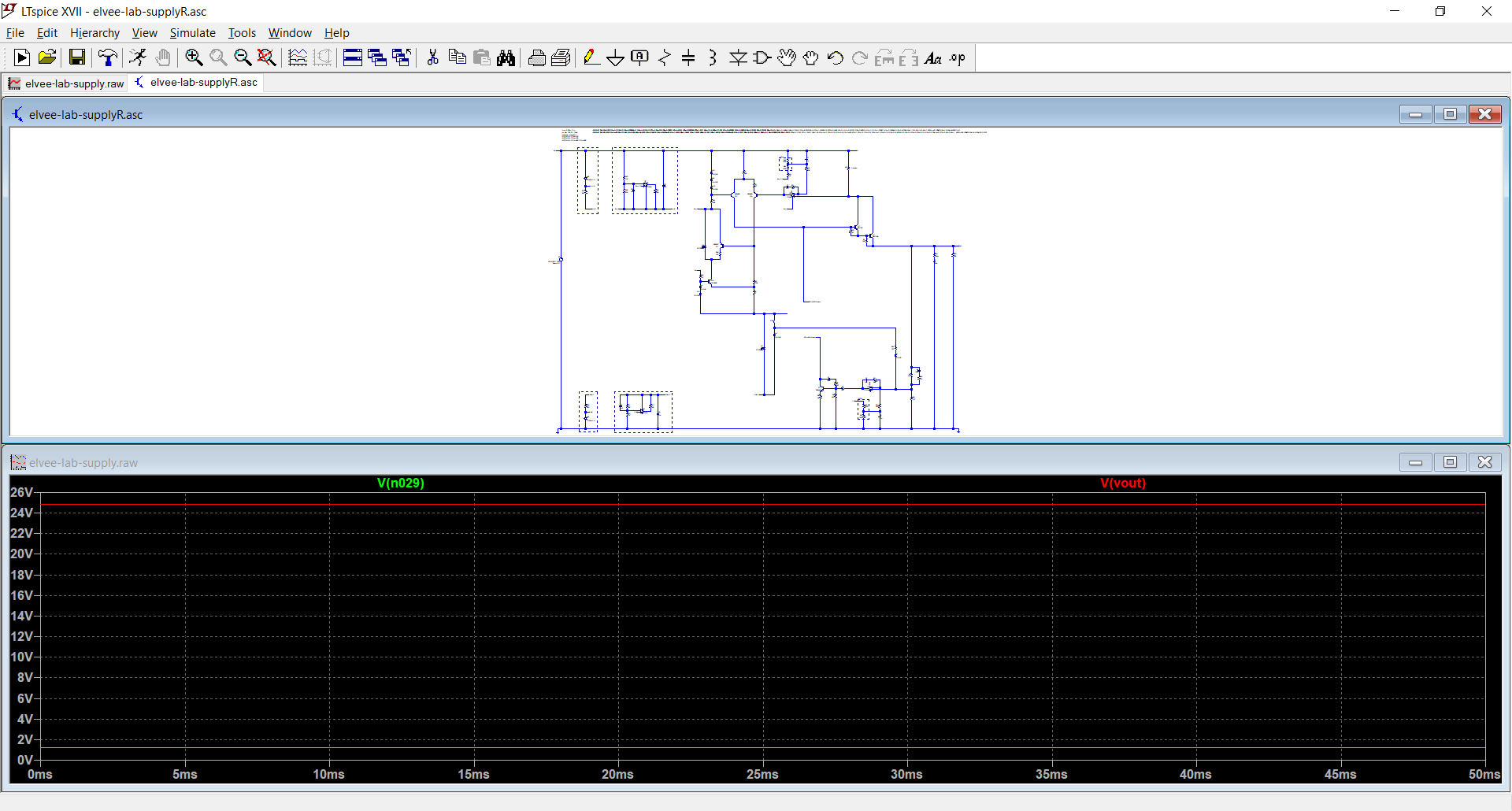

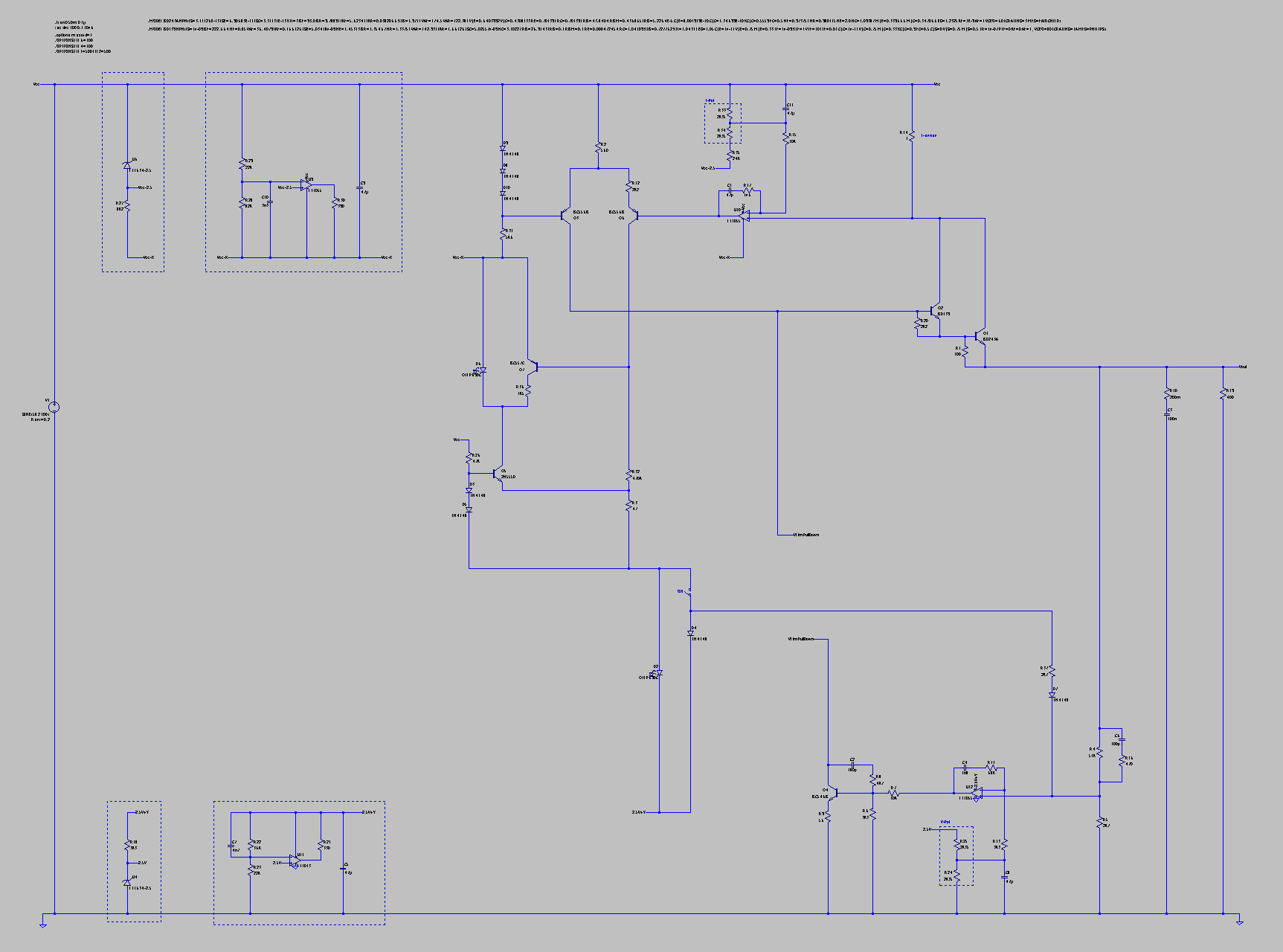

OK, it took some time but I managed to review your schematic: mine was too cramped, because I wanted everything to be easily legible at a glance, but yours is somewhat ...aerated, which isn't easy either.
The sim is "repaired", the problem was simply the use of a LT1055 in the voltage controller: its common mode doesn't include the V- rail.
Instead, you should use the other half of the LT1013, as I did:
attachment.php
Note that the parts of the circuit you have omitted play a non-negligible role in practice, and should be included in a real build, even if the sim appears to work without them
