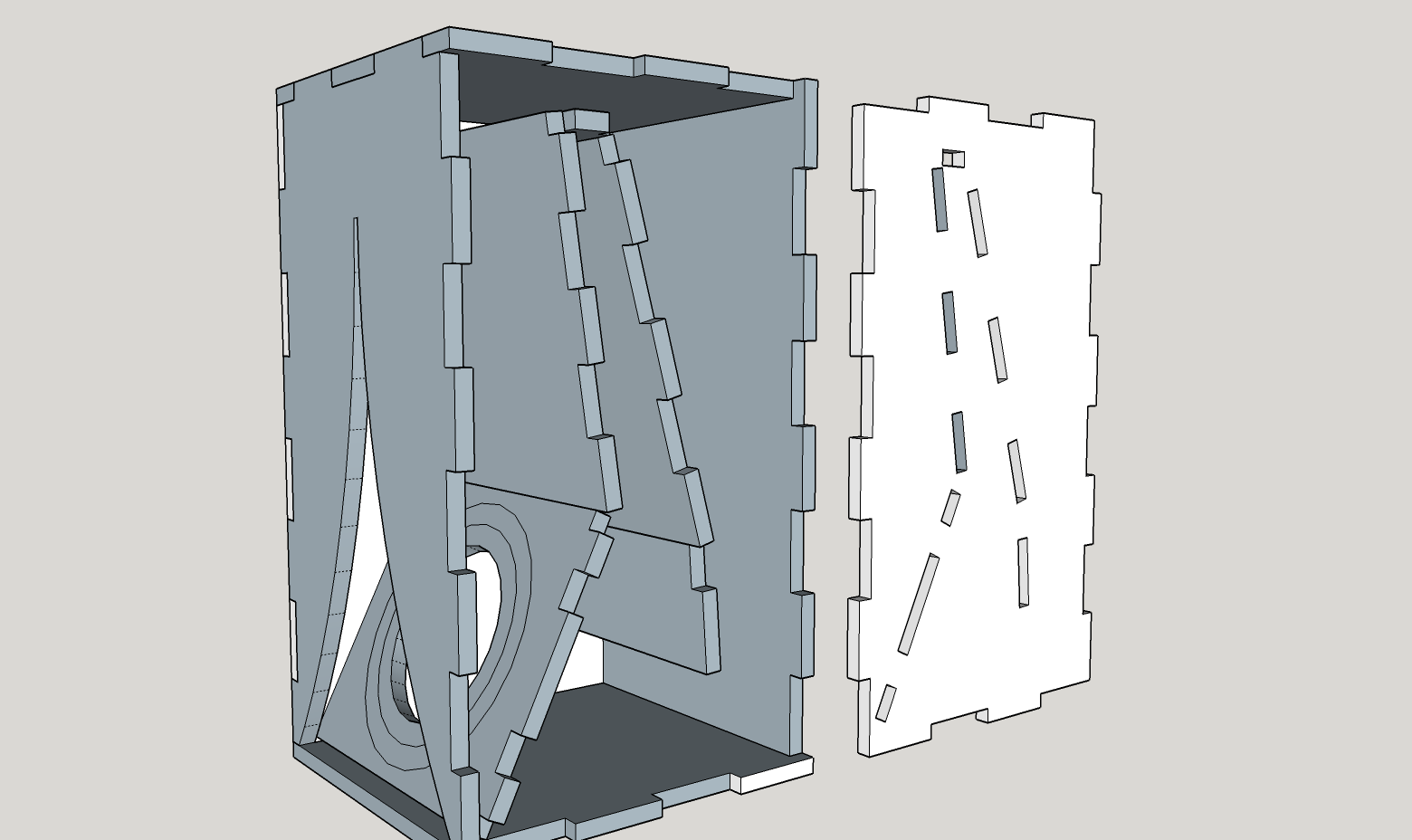

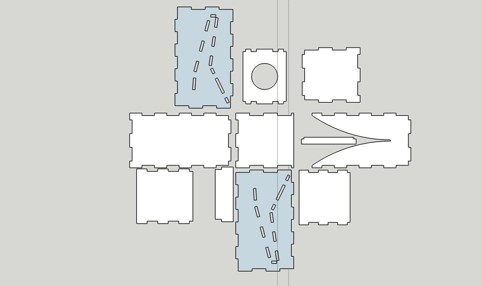

I've been learning some sketchup and created the fullsize Karlsonator as a lasercuttable self-bracing puzzle. It's easy to scale down to 0.63 for 12mm plywood.
The bad thing about lasercutting is that you're stuck with 90 degree angles, so some gaps have to be filled.
I might make a 0.53 version with 6mm plywood and some bracing. 6mm plywood should be stronger than foamboard, right? 🙂 But that will require some resizing of the drawing.
Sealing the box might be get tricky due to amount of holes in side panels.
Good point. With good plywood and kerf adjustment I should be able to stay within 0.2mm accuracy. Some filling glue should do the job.
