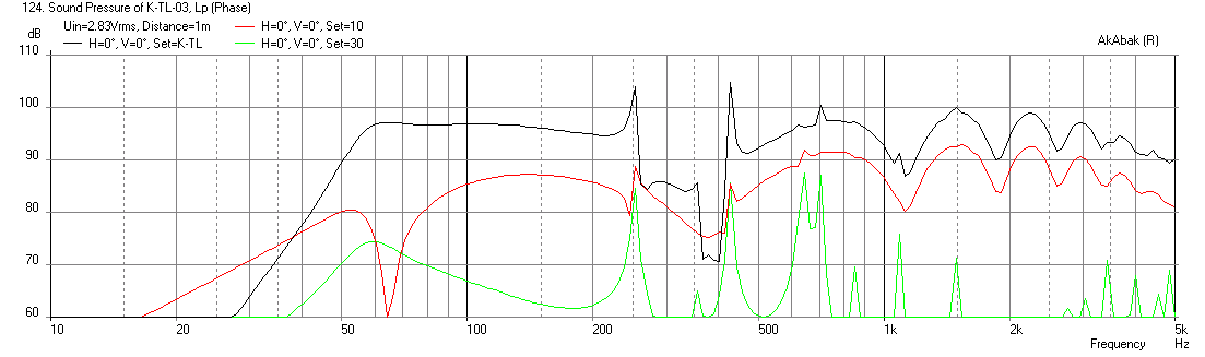

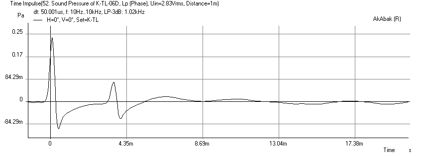

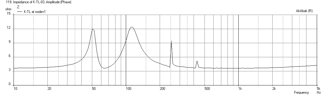

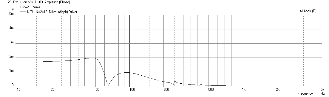

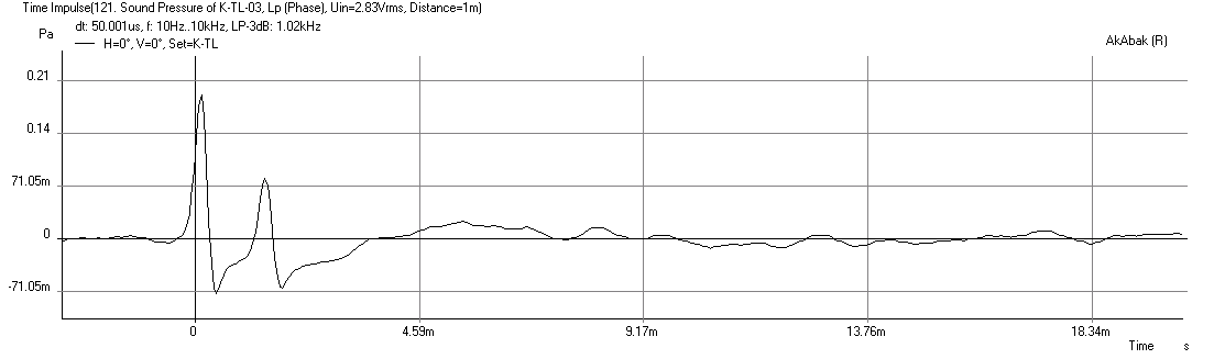

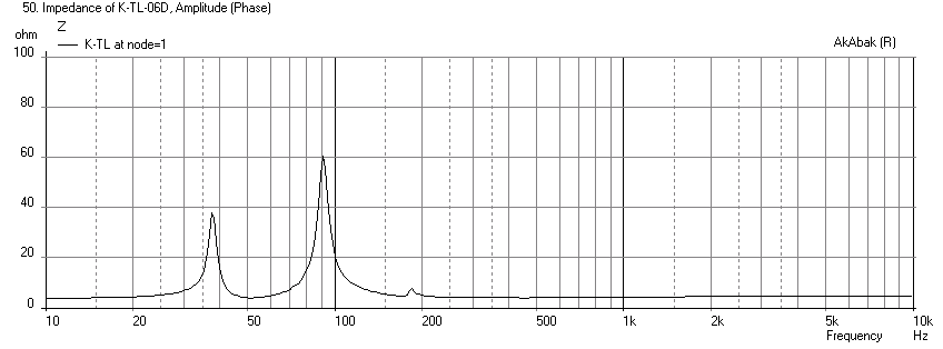

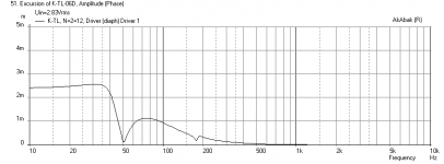

Nelson,
Here is the simulation of the mini Karlsonator with the FE126EN. The scaling dimensions that I arrived at are a little different due to the low Qts nature of this driver. It probably is not the ideal cabinet for this driver in any event but here is what I came up with. Length scaling is 0.5X, width and depth scaling is 0.43X, and then scale the vent width by 2X (after the length scaling). The FE126EN has such a hot rising response and there is not enough bass gain with this box (compared to a BLH) that I had to tame the upper freq with a 1.2mH//8 ohm resistor for a BSC.
Simulation plots are as follows:
- Freq response with speaker 6 in from back wall mic at 1 m
- Freq response with speaker 60 in from back wall mic at 1 m
- Impedance
- Driver cone displacement
- Impulse response
Observations: fairly deep bass extension to 50 Hz with quite a small cabinet of about 15 in high x 6.6 in wide (barely big enough to fit the driver flange); if you move it away from walls you will get rid of the room suck-out at 250 Hz but at the expense of bass enhancement from wall; the cone movement is a bit too high for the low xmax of this driver (0.3 mm) - but I have heard folks say movement of 1 mm is not bad sounding or damaging; the impulse response is fairly clean since the secondary peak is < 8 ms for minimal group delay.
It might be worth it to try it out in foam core first and see how you like it.

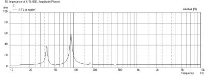

Nelson,
The Visaton FR10 can work reasonably well and is priced just right at $10 ea. Use two of them in a 0.6X scale Karlsonator. I am very happy with dual Vifa TC9FD's - you can certainly go that route.
Here are the sims (the 300 Hz dip depends on positioning from wall).

Nelson,
I forgot to mention that the above sim for the FR10 is actually an additional 0.7X scale by width (the aspect ratio will be taller - the width is really 0.6x0.7 or 0.42X overall while the height is 0.6X overall compared to original), and 0.7X additional scale for top channel vent (final scale is 0.42X on the vent from original). Sorry to be so confusing but it was easier to implement the scaling in the model this way.

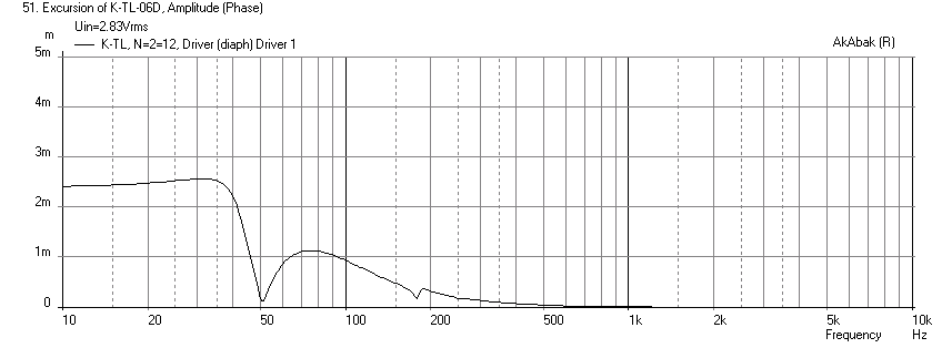

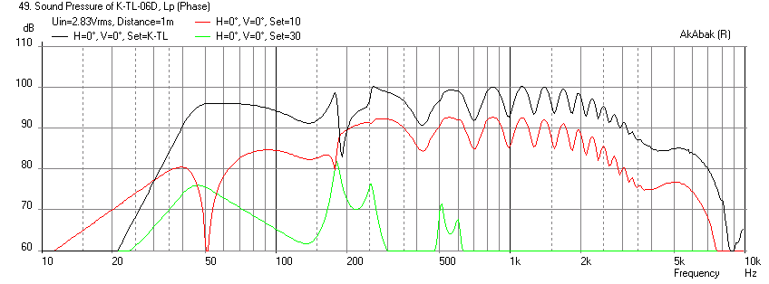

Dual NS525 (budget) mini-Karlsonator
The Aurasound budget NS525 driver available from Madisound for $3 ea seems to be an interesting candidate for a budget Karlsonator that has pretty good efficiency (~95 dB)and reaches down to about 50 Hz with a pretty flat response in the bass region. The Karlsonator plan was scaled 0.8x in length and 0.47x in width and depth, with a scaling of 2.5x applied to the vent gap after the other scalings are applied. The performance/price ratio of this speaker is pretty good.
Plots are for speaker placed 18 in from back wall with 2.83v input at 1m.
- Freq response
- Impedance
- Cone excursion
- Impulse function
