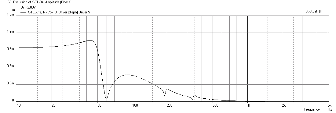

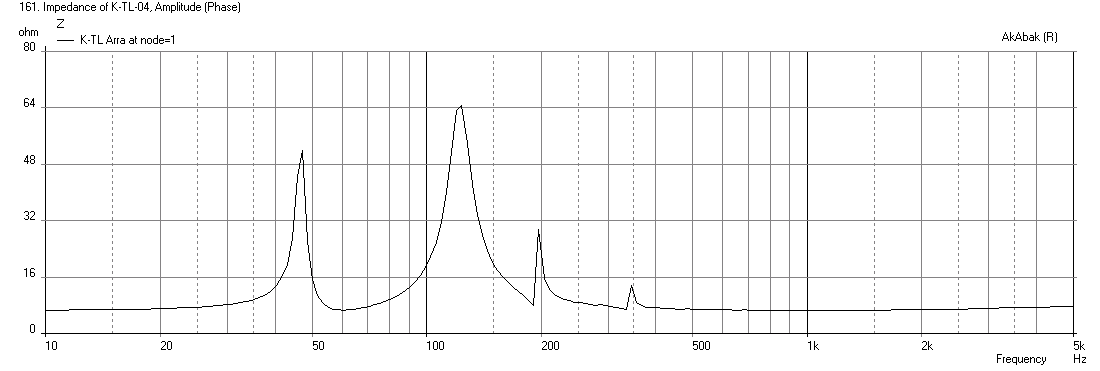

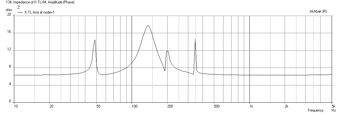

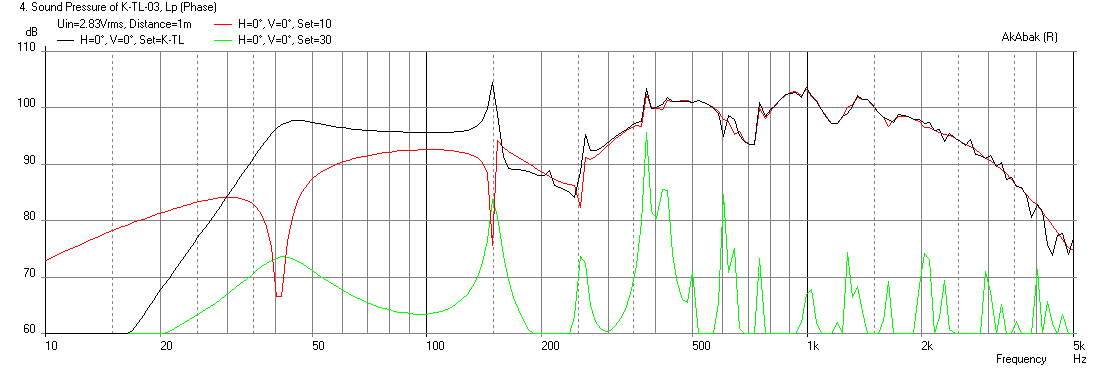

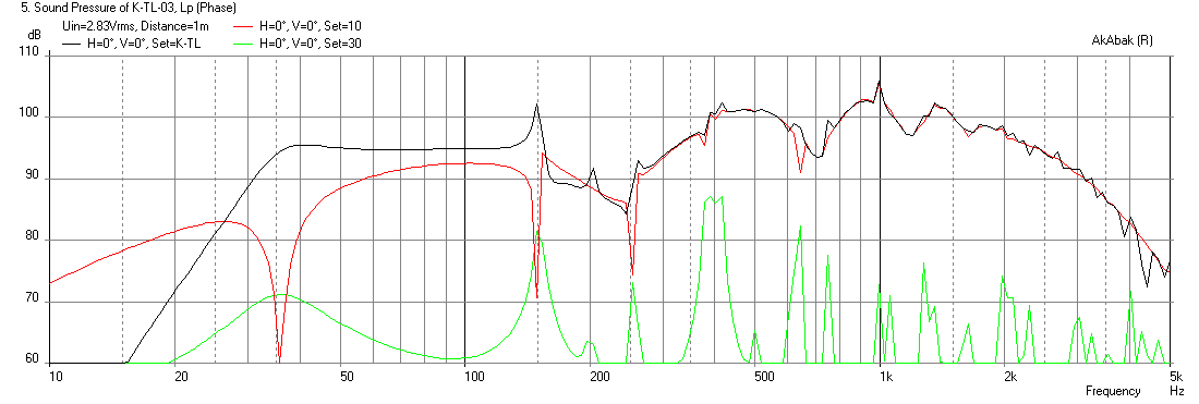

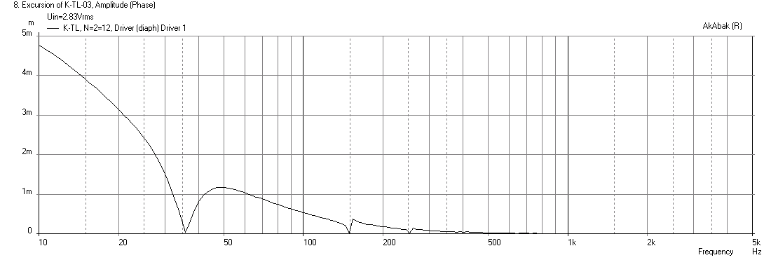

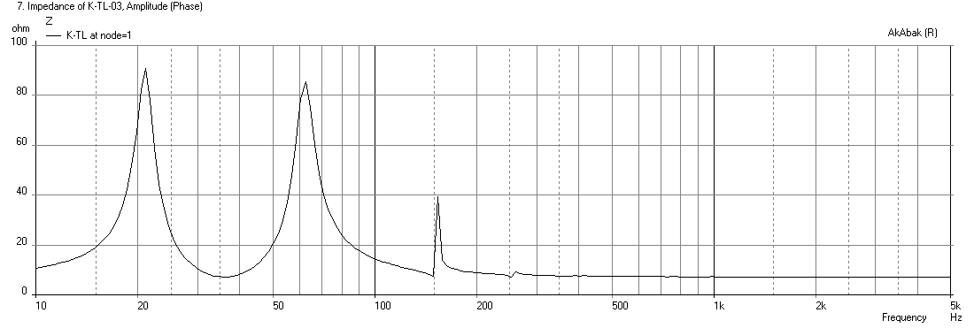

The AN Super8 works quite nicely in the full size 12 in K'nator. It has a high rising response that you may want to tame with some BSC or EQ'ing, otherwise it might be too bright or shouty.
I also tried constricting the top channel to 0.5X and that really helped flatten the response out (second plot). Third plot is impedance, fourth is cone displacement. All for 0.5X choked case with 1 watt in at 1 m.

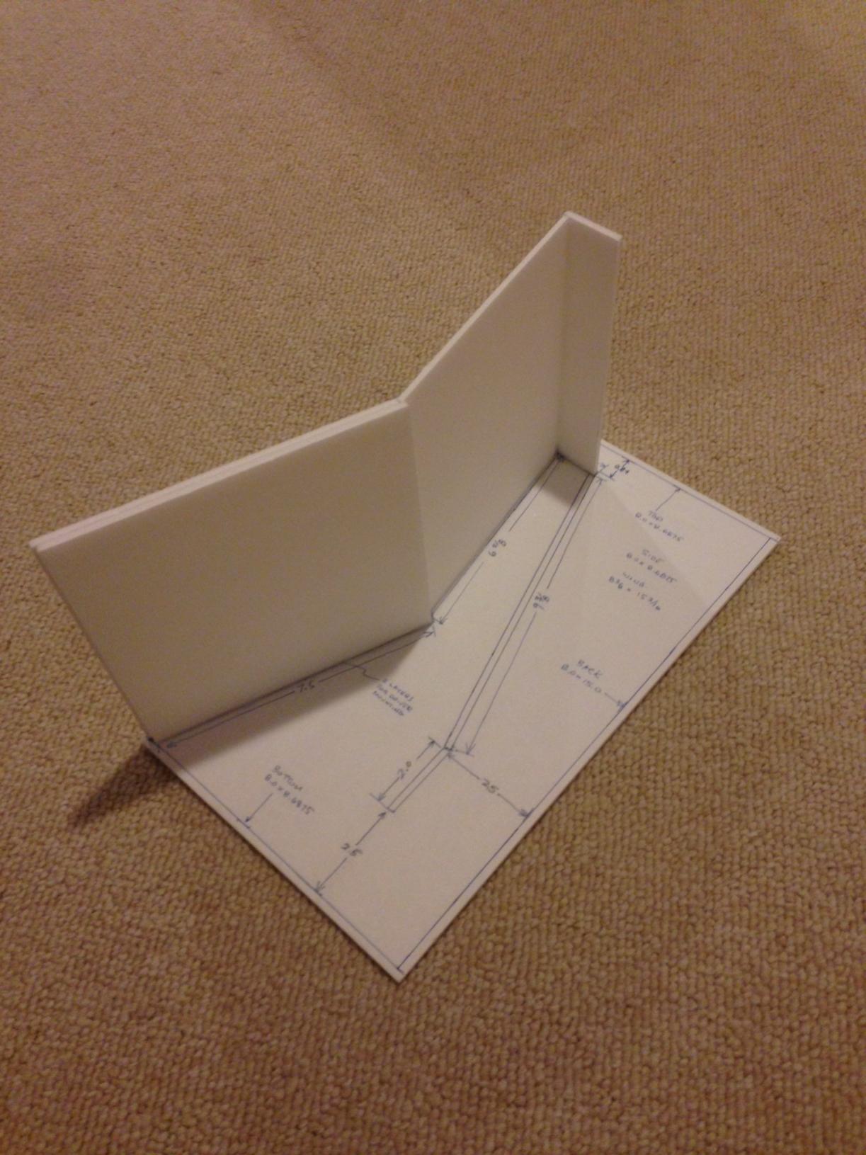

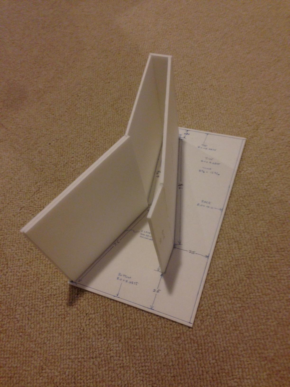

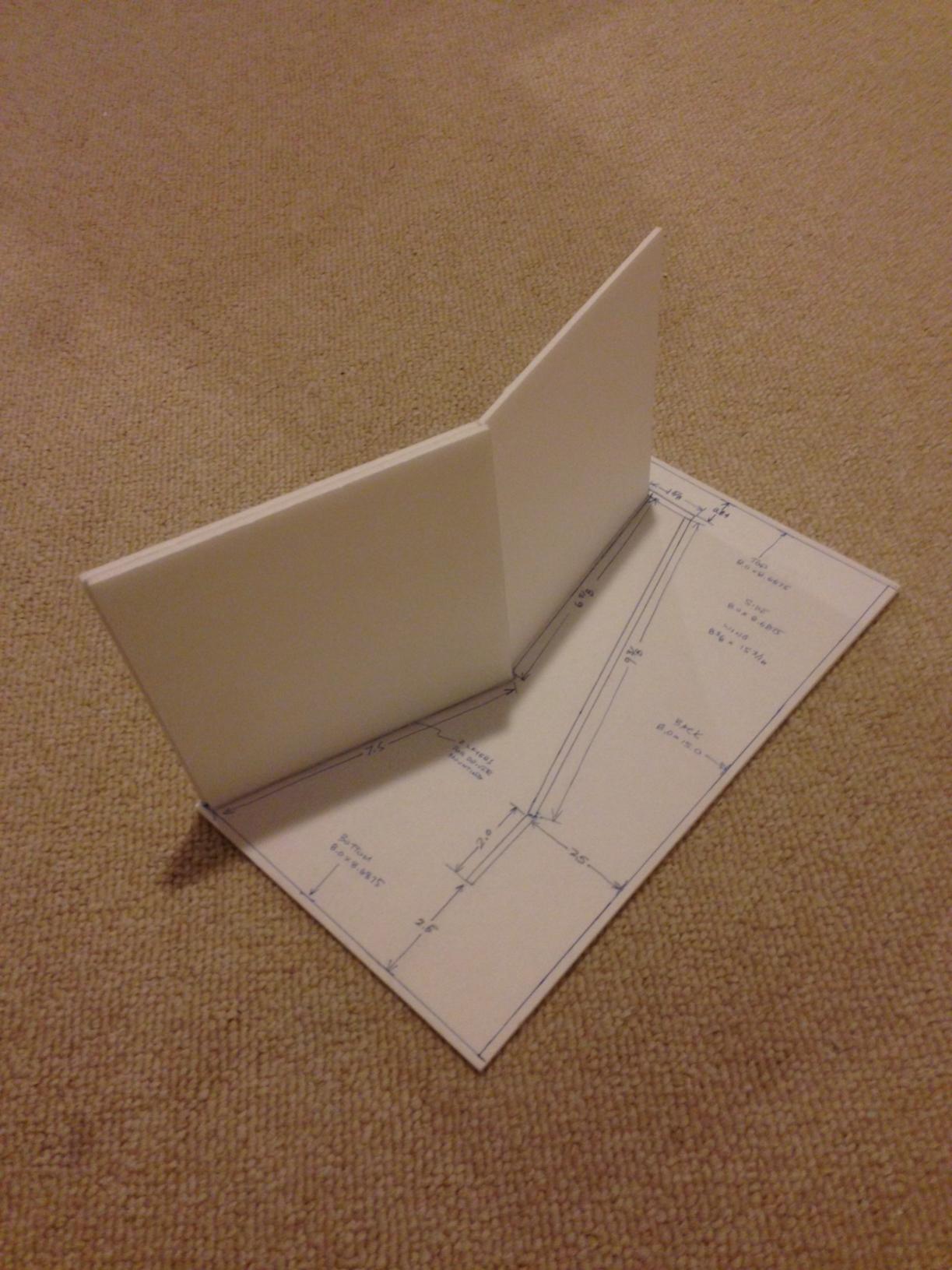

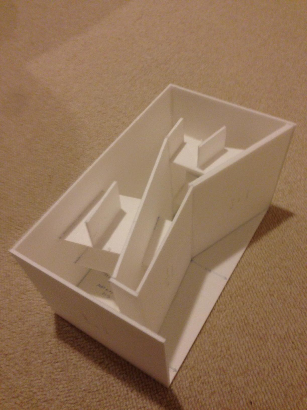

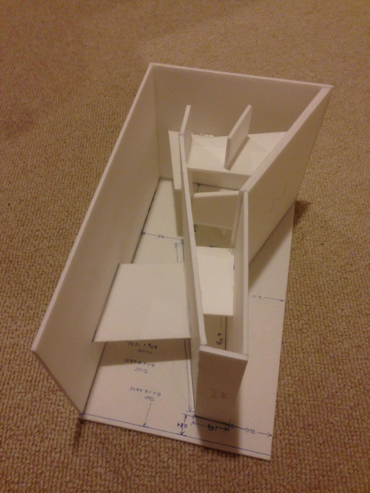

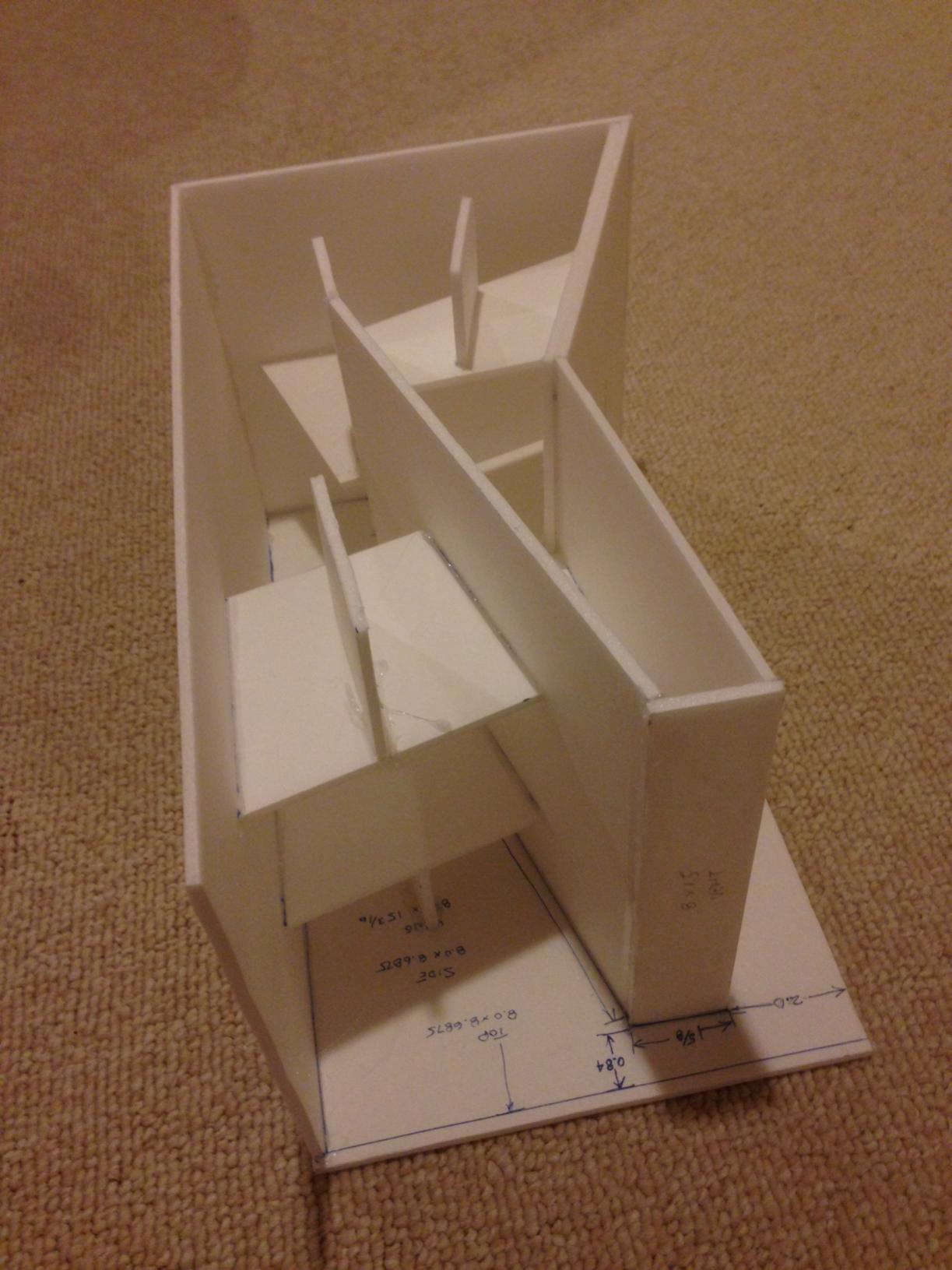

Build Log - No. 1 - Glue Internal Dividers & Baffle
I started by drawing the plan on the side panel (which I have a typo on the plan). It is 15 & 3/8 in tall x 8 and 11/16 wide. Start by first gluing the two driver baffle panels together to double them up. Make sure they are offset so that they fit flush with the bottom wall. Then follow to the drawing and glue the top front panel, then top vent channel, the interior divider panel, then finally the bottom interior divider panel. Make sure you use a 90 deg piece of foam core to align the panels when they set in glue. These steps took me about 20 minutes. Easy. 🙂

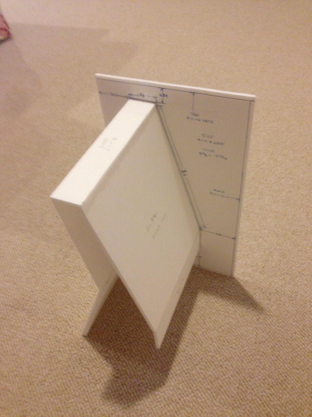

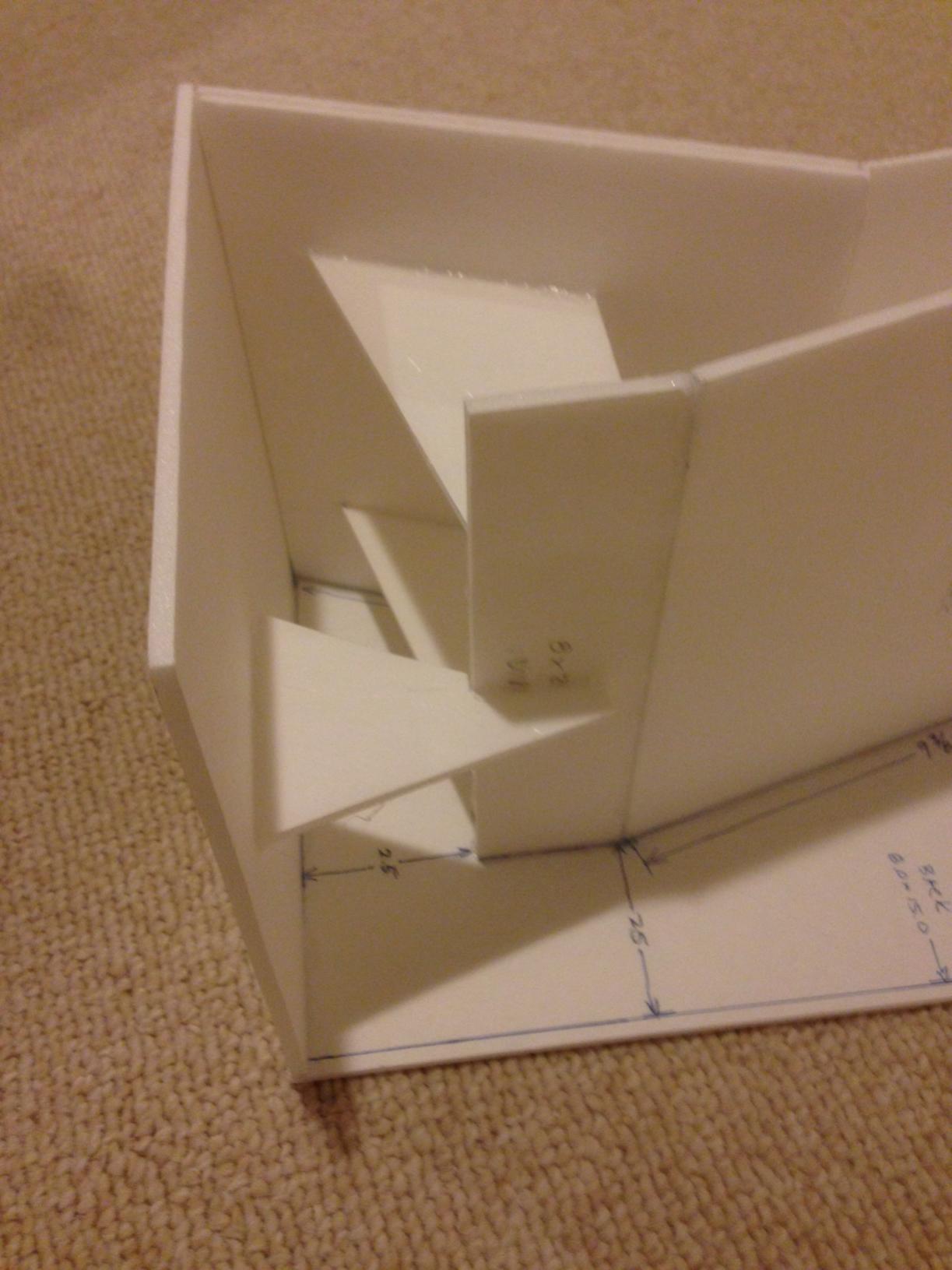

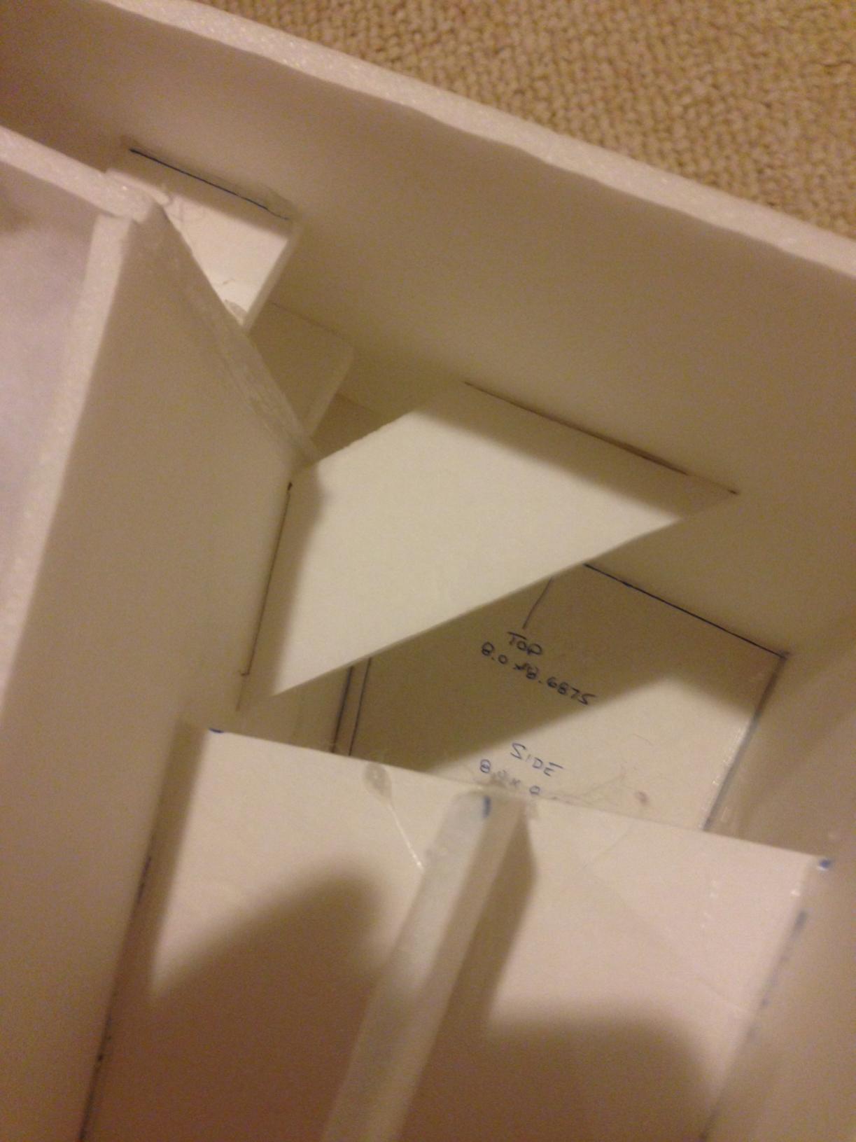

Build Log - No. 2 - Glue Exterior Walls and Bracing
Next step is to glue the internal bracing inside the closed end section. Use scraps of foam core and hold it up to the section you want to brace and draw the outline of where the walls are, then cut the piece to fit perfectly. You can usually wedge it in place a little so that its own friction holds in place as the glue sets. Hot melt the brace and then wedge it in place. Add more hot glue fillets on the brace joint if you have enough room to get the gun in. The add the two braces for the lower diver panel to the front baffle, make sure it is wide enough not to interfere with driver placement. Add pieces of bracing to the side wall and attached to the driver chamber braces, one of them will be standing open for final capping of the side panel. Then glue the bottom wall on, after which add a brace between the lower vent divider and bottom. This will strengthen the bottom panel and keep it from acting like a drum head with the sound pressure. The glue the back wall on, you have to work fast as this is a long stretch to lay down hot glue before it hardens. Then add two pieces of bracing between the back wall and internal divider wall. Then glue the top cover on, after which add three small pieces of bracing between the top channel and top wall. Also add some bracing between the side wall and the back wall braces that were just installed. The top one will be left standing open to be glued when the final side capping operation takes place.
I also added a small brace between the top of the divider and the lid to reduce that large flat area from breathing with sound pressure. I think I have a total of 13 pieces of bracing. This series of steps takes about an hour due to the cutting and fitting all the braces.

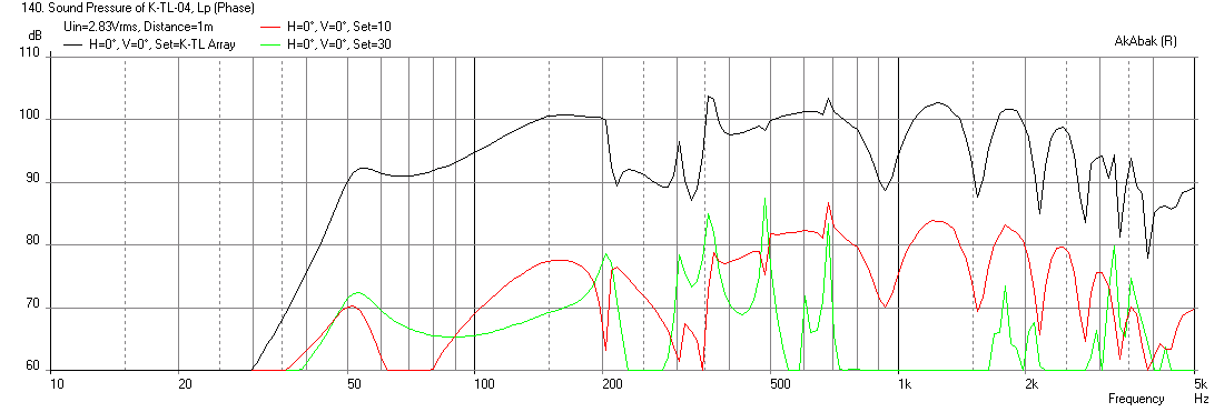

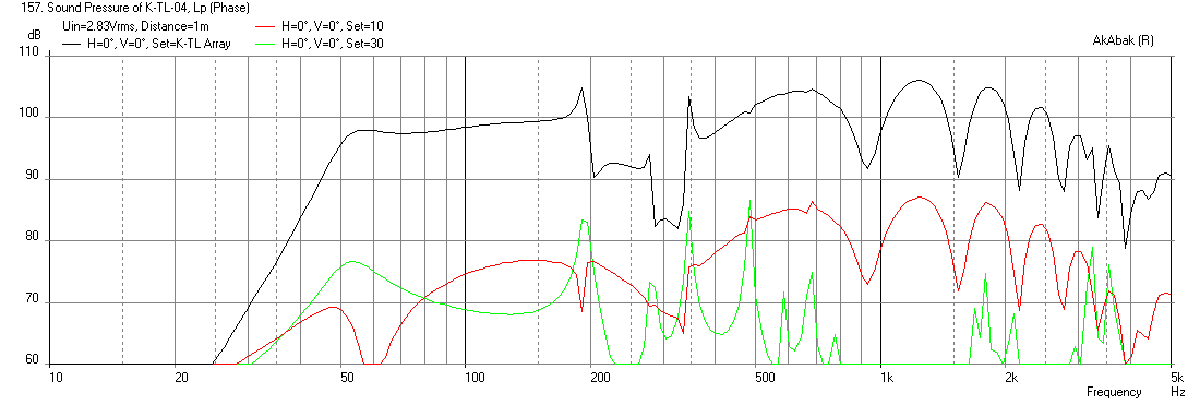

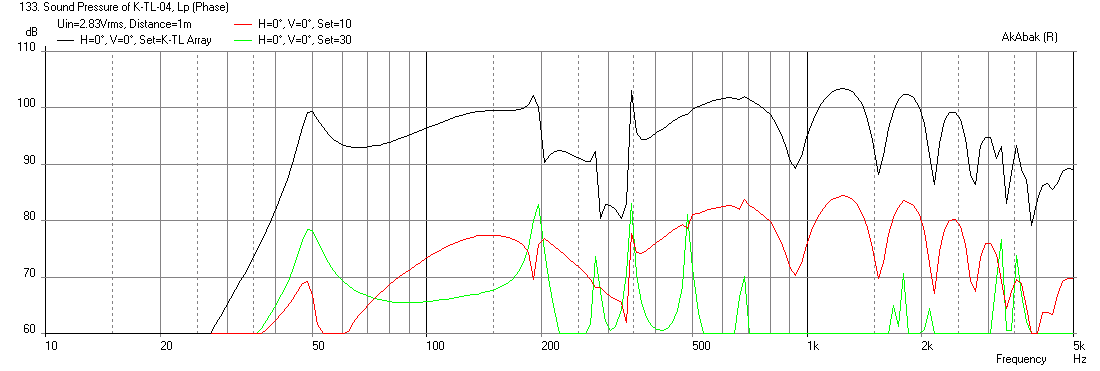

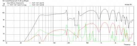

0.75X Scale Karlsonator with TC9FD 3x3 Array
IG had the idea to stick 9 of the little Vifa's into this box (equivalent Sd of a 10 in driver). The advantage would be higher efficiency, very little cone movement so high power handling, and good HF response as the HF from a 3.5 in driver is much better than a 10 in driver. I had to tweak the design a little bit: the vent channel had to be enlarged by 2X (after applying 0.75X overall scale), and the rear chamber dimension and internal TL flowpath had to be enlarged by 1.2X in the channel depth dimension (length stays the same). So basically, the box will grow by 20% in depth. The front chamber and top vent length stays the same. So the results are actually very encouraging. The first plot is the freq response at 1 m, which shows an average SPL of about 95 dB which is consistent with running 3 parallel x 3 series drivers. The next plot is the impedance, which doesn't look too bad, nothing my amp can't handle, and the last plot shows how little cone movement there is as it is shared between 9 drivers. If someone (Melo Theory has 50 that I know of 🙂 ) has a bunch of Vifa's lying around - this would be a fun experiment. I would make in plywood though as the sound pressure is quite high inside the box.
Certainly, a similar thing can be done with an array of the larger NS525's which are only $3.60 ea so you can get the equivalent of probably a 15 in driver. The cabinet would have to be scaled up by 1.2x probably... Should reach 30 Hz and be real loud.
The broad valley and peak tell me there might be too much Vb for the combined drivers. Maybe we could get something flatter down to ~60Hz keeping the line length and making it more skinny on the other two dimensions. You don't have to re-do this unless you're curious, which is what brought me this idea to start with. 🙂
IG
IG

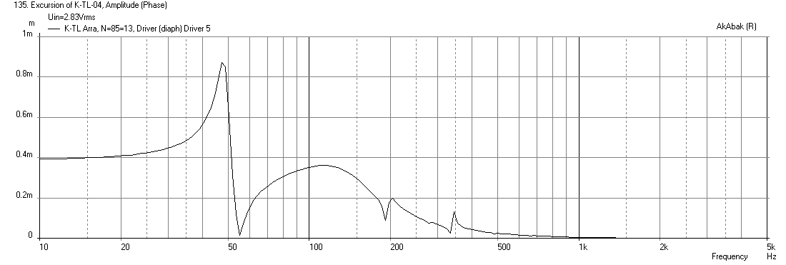

I was getting more bass by increasing Vb, which was why I added the 1.2X scaling on back TL and chamber chamber depth. I think the Vifa's have a very high Qts and need a lot of volume to work well. I have seen a formula for estimating Vb based on Qts and Sd or fs (GM has used it). I know that the BIB with a Vifa is a very voluminous box for how small the driver is. And with 9 of them, might be huge. The parallel driver idea may work better with a lower Qts driver - but then those aren't cheap. Maybe try with an FF85WK?

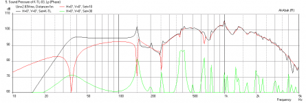

3X3 TB W3-315e Array
I tried putting a 3 in W3-315e driver with a Qts of about 0.5 and this seemed to do the trick. The response is much flatter now, I kept the overall scale at 0.75X and only scaled the vent up to 2.3X. This can definitely work but driver price is doubled.
