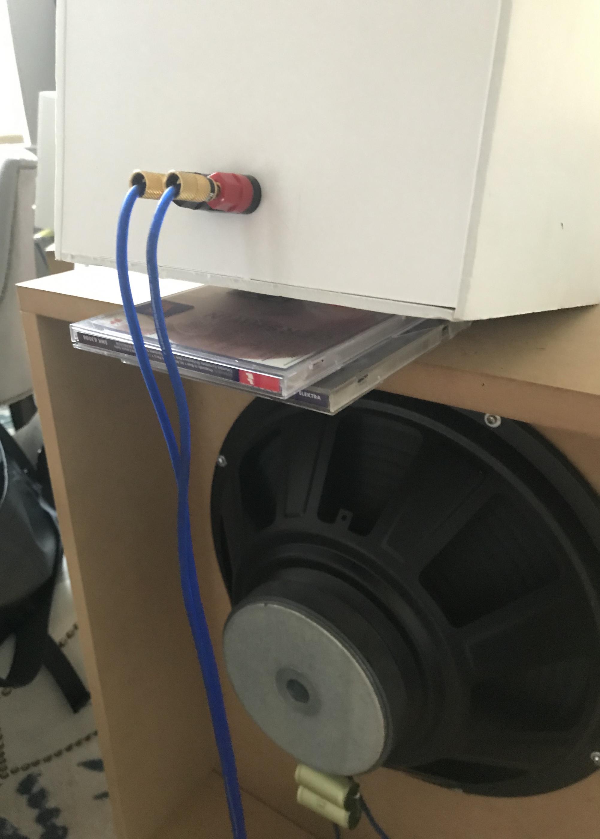

Of course I had to try it with mine too, but didn't notice much of a difference with the mini K's tilted down. But with them tilted UP, the low soundstage 'level' moved up to exactly where I always wanted it to be. I'll give it a good listen for a week or so and then put the speakers flat again to hear if there is as big a difference as I heard today.
My test track happened to be "Fever" from Elvis Presley with the Royal Philharmonic Orchestra - If I Can Dream [2015]. I ended up listening to the whole album, even the tracks I'm not so fond of. Apart from the raised soundstage, it appeared that the mini Ks' razor sharp imaging and depth improved, if that's even possible.

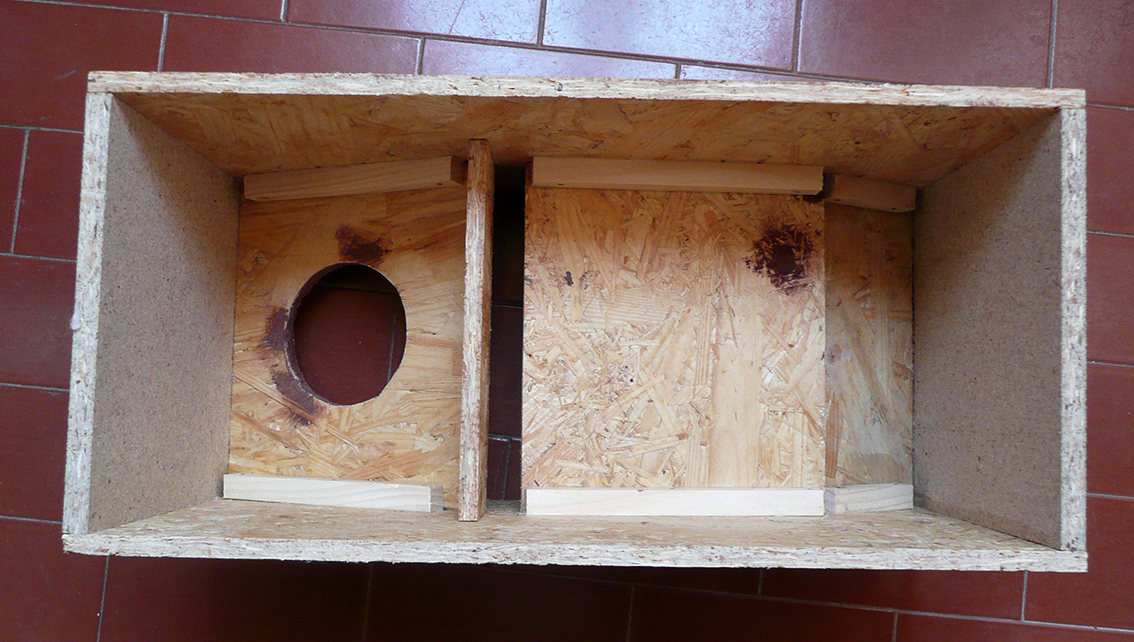

These drivers seems nice and appropriate. With a wood case, my XK4 which is a mix of beaverboard 10mm and OSB 8mm thick, doesn't need anything inside, no wool, no lining but I glued cleats.
The back and the wings are made of plexi 4mm if I remember correctly, the worse material you could get I guess.
I wonder if the trick is precisely to get heterogeneous materials to avoid similar vibrations into the box. OBS in itself is really heterogenous.

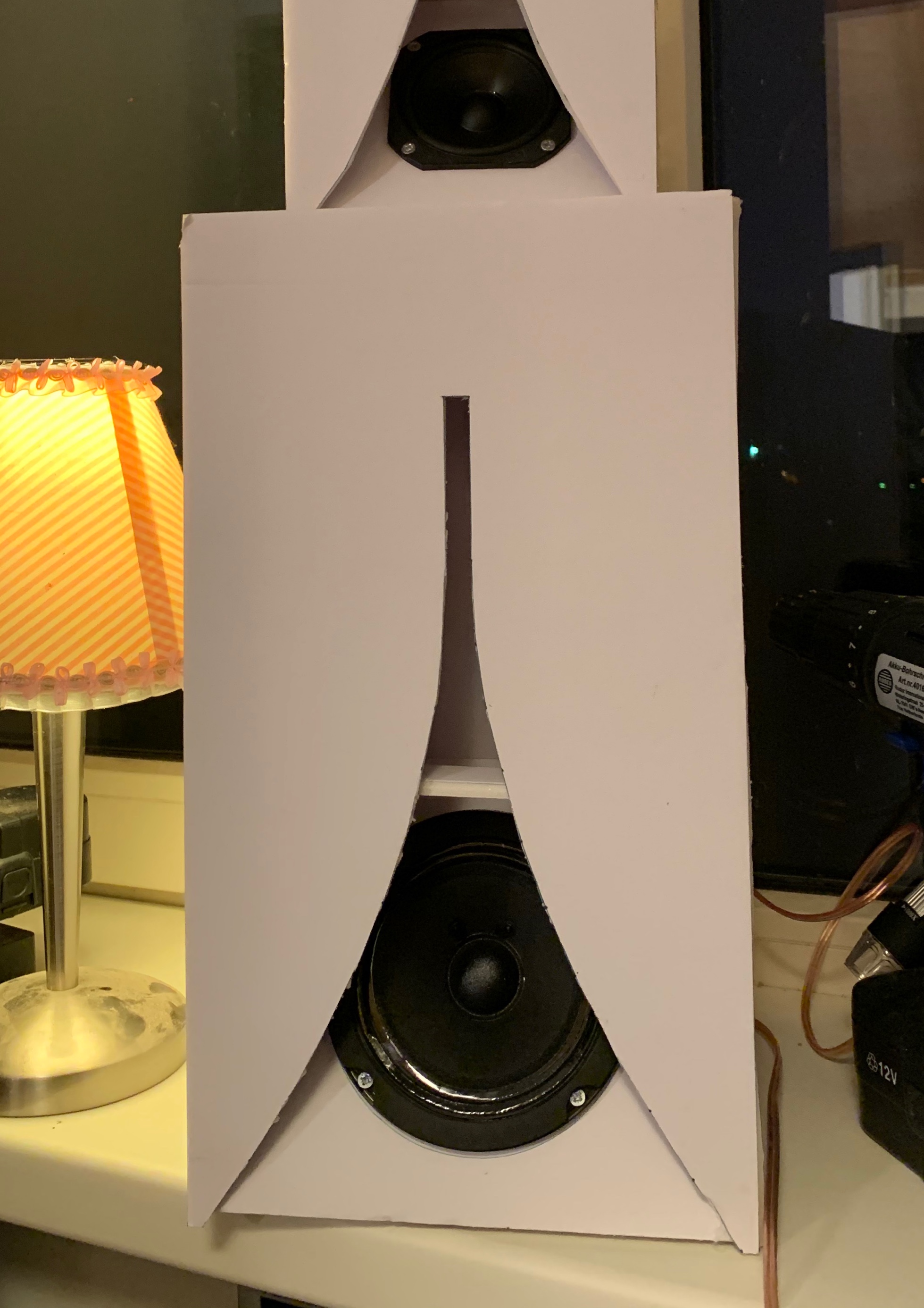

I would definitely use the perimeter cleats with gasket tape for a secure seal for the aperture plate (and would probably do the same for a removable back). For the horizontal cleat that bisects the aperture opening (see drawing) I was thinking I could just incorporate it as part of the aperture plate rather than fastening it across the back. So, instead of a separate cleat, it would be part of the aperture plate itself. That means the aperture would be 2 openings instead of the continuous single curve. Make sense?

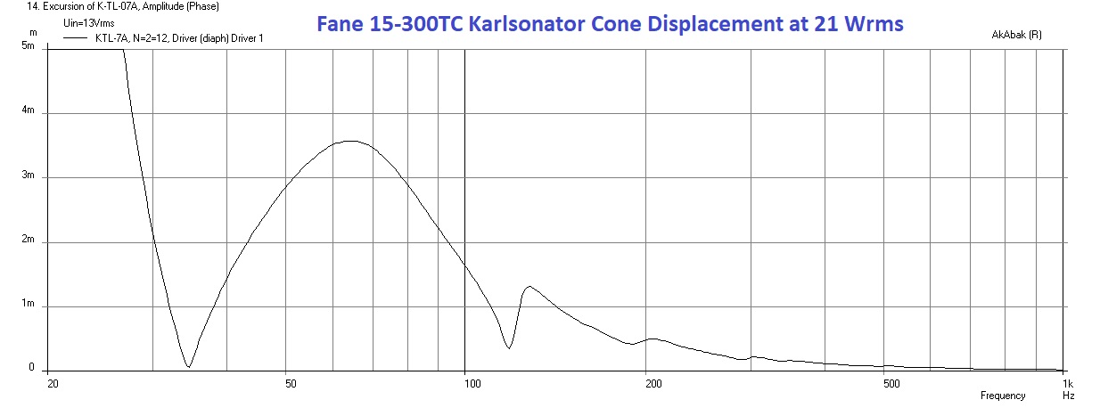

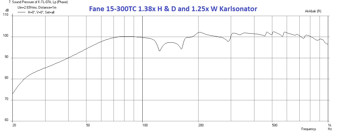

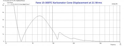

A member asked me to see if the Fane 15in fullrange (15-300TC) could work in a Karlsonator. It can but requires a very big one. Scaled 1.38x in height and depth x 1.25x in width. It will get 100dB sensitivity and have F3 of 57hz and F6 of 49Hz. Max output of 113dB is limited by 3.5mm Xmax at about 13Vrms (21Wrms). Response is surprisngly flat though.
Predicted freq response at 2.83v and 1m:
The very gradual slow roll-off in bass will integrate nicely with room modes to produce bass down to 30Hz easily.
Here is the predicted cone displacement for 21 Wrms:
I think you will be hard pressed to find a more sensitive full range speaker for nice loud bass that should be room filling and powerful.
