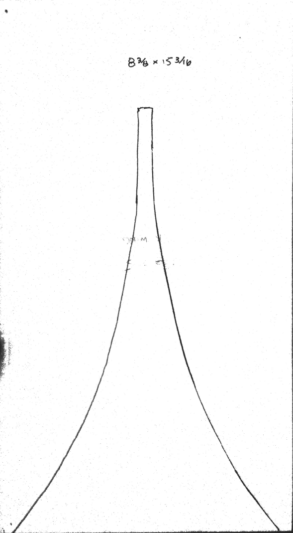

Hmm, I just double checked your numbers, because I thought the drawing in 198 had both XRK's and the true scaling. It looks to me like XRK's original drawing in post 1 has a 15 inch internal height, or 381mm. Where did you get the 371mm from?
I actually double checked that earlier today before cutting and I have no idea where I got that from, I guess I counted xrks measurements as external instead of internal, sorry for the confusion.
I've cut everything (with the correct measurements) except the aperture now and I'll glue it together soon, if the sound will be close to as nice as my current speakers I'll he happy but I hope they will beat them.
I don't really know what to expect of these since it's my first speaker build.
The drawing i made on the foamboard does not have the same measurements as they had on the paint drawing , i'll post the measurements i ended up with when i come home, i also resized the baffle to 20 cm to be able to fit the dual 3fe25, the following part ended up at close to 19 cm instead of 168mm as in my drawing, we will se how it ends up.

I started by drawing the plan on the side panel (which I have a typo on the plan). It is 15 & 3/8 in tall x 8 and 11/16 wide. Start by first gluing...
I think I found where the confusion with the different sizes came from...
Don't you remember this from 5 years ago X? 😉

Started cutting material for the 0.53x with the dual 3FE25's last night, and I'm using 1/2" black foamcore from hobby lobby (the rest is all black 3/16") for the front wings/aperture. Based on these plans posted a while back, is this what you would recommend for the starting dimensions for the slot on the front wings?

Ok, 0.53x score and fold plans are done. I basically took my 0.4x plan and scaled it up to 0.53x, so this is a true 0.53 scaling. For the aperture I tried to include both a dimensioned drawing and a scaled section that could be traced. The scaled image barely fit on the page, but the curve is all there. Now this plan is untested, so please let me know if there are any mistakes.

Thanks! But seriously, please try them out and let me know how they work. Experience tells me there's at least one mistake in there.
