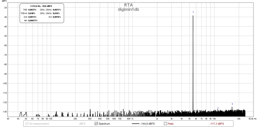

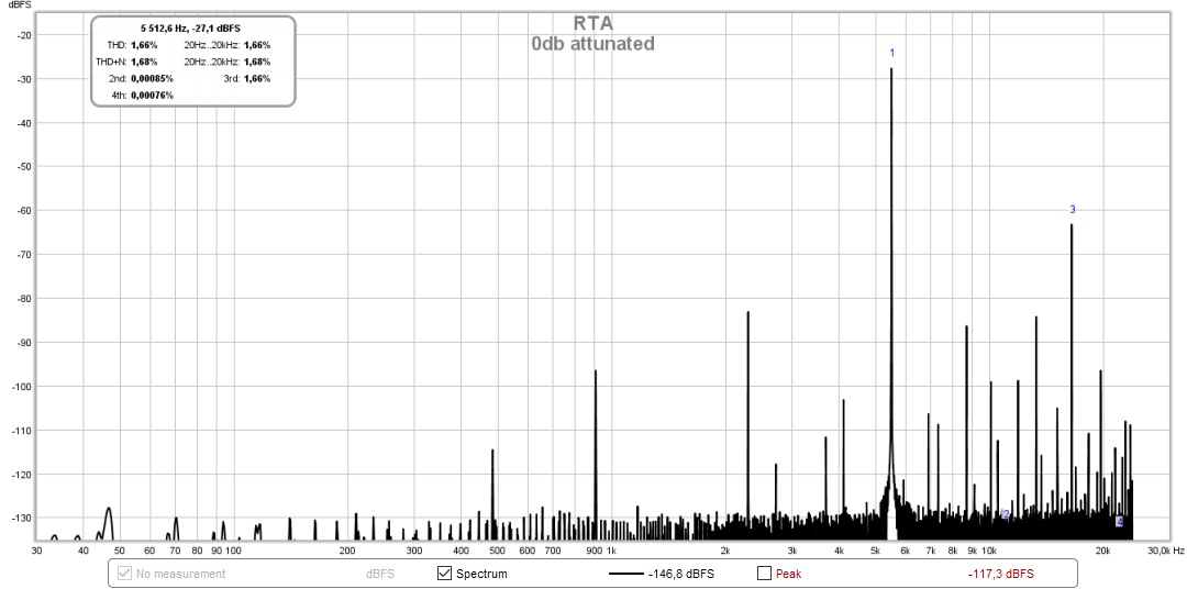

Checked my nanodigi today
https://www.minidsp.com/products/minidspkits/nanodigi-2x8-k
Played the +0.67dB signal from PC to nanidigi at 44.1 SR
Attunated the signal -6dB at the output of nanodigi.
Went through a tc electronics DAC and measured analog with REW at an other PC.
About 1 % distortion at 0 dB
0.002 distortion (analog) at -1 dB
See pictures. The weakest link for some MINIDSP products are ASRC for+0dBFS signals.
+0.67dB relative to... full scale? (Don't follow... are you already clipping at the PC output?)
Tried also to attunate at the input of the nanodigi, but no effect.
Think I can live with 1% distortion in these situations.

Used the first file of #1 in
http://www.diyaudio.com/forums/digi...re-detect-0dbfs-waveforms-overload-times.html.
ASIO out to babyface spdif to nanodigi.
Very interested if anyone could provide a solution for clean ASRC of +0dBFS signals on nanodigi.

OK, but why do you say "Played the +0.67dB signal from PC to nanidigi"? How are you making it do that? It sounds like you are feeding it a distorted signal, so of course the output is distorted.
John,
Obviously there are no data samples greater than 0dbFS, but he's worst-casing here by feeding the input with data that has successive samples ("clipping") at 0dbFS.
This is an attempt to trip up the operation of the ASRC. He's making the case that all digital inputs should be attenuated by a few db to prevent this from happening.
Dave.
Yes, if you oversample and hit peak value, you will se +0.67 dB.
Some DACs can handle it others will distort in an ugly way as the tc. elecronics AES article shows.
