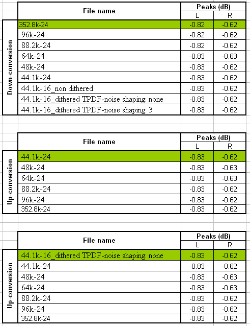

I was curious to see if the “intersample peaks” is an issue with properly recorded real music when down sampled or up sampled.
I used a high resolution (352.8KHz/24bit) download which has no flat peaks at –0.82dB FS (L) and –0.62dB FS (R).This recording I down-converted up to 44.1KHz/16bits.
http://www.diyaudio.com/forums/everything-else/169484-what-wrong-op-amps-476.html#post4955946
Then I used the low down-converted file and up-converted it.
Conversions were done in Steinberg Wavelab
In both down and up conversions, there isn’t any significant peak change, only at the second decimal point of a dB.
George
George
1 Most mastering software (all that I know of) can be set to inter sample peak limiting. So clipping should not be a problem. Of cause if you then use perceptual coding, you change the waveshape and clipping can occur.
2 If you design the analog part of the converter to have a bit of headroom, ISP clipping doesn't need to be a problem. In any case a tiny bit of clipping is not audible under normal conditions.
