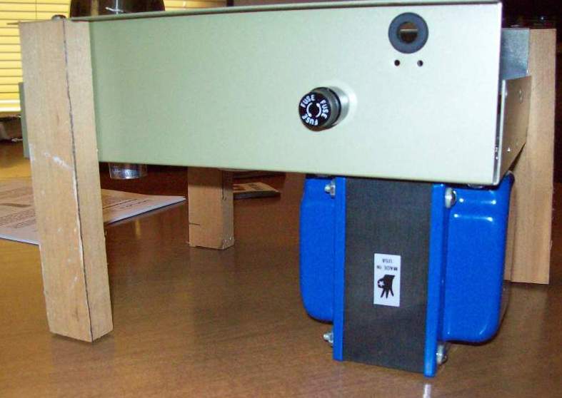

Anyway lest you think this is total vaporware... I have made some progress on knocking up the power amp chassis. Behold my ghetto version of the chassis cradle. Beats my normal method of propping it up with whatever junk I have on my work bench at the time. 😀
attachment.php
I rigged that up so that I can start mounting the iron and can cap.
attachment.php

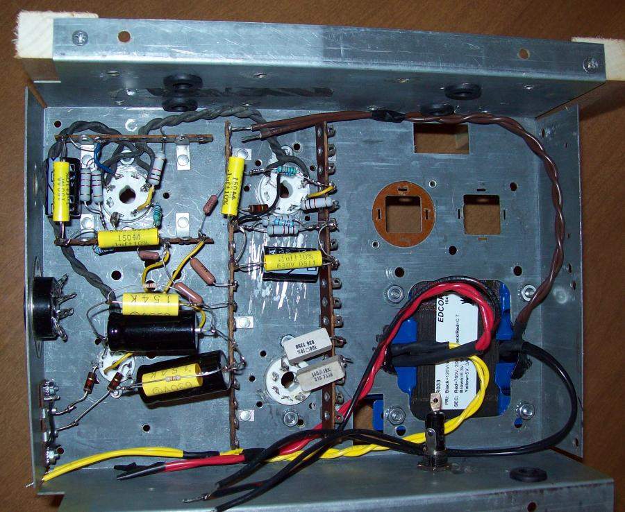

The two KT88s go on the top two sockets with the 6CG7 on the lower left and the rectifier on the lower right. You will note that the cathode caps on the 6CG7 are a lot larger than those on the KT88s (33u v.s. 22u). Seems a little bit backward I know but they fit better that way and both are sufficiently large for the application since there will be a 40Hz 2nd order high pass before the power amp input. Also having the smaller value on the output tubes may be better for blocking under overload.
You can't see it in the picture but the caps on the 6CG7 stick way up high so there is plenty of clearance below them. Notice that each electrolytic is bypassed by a polyester film cap (.15u for the 33u caps and .1u for the 22u caps). Since the resistors were not long enough to span the distance to the tag strip I used the big cap for that and then piggybacked the other components to it. Not neat but should be OK. The cathode resistors for the 6CG7 are carbon film instead of metal film only because I neglected to order the right ones. I had intended to use 3.3k but simulation indicates that the 3k that I had should be fine. A little less cathode voltage 9V instead of closer to 10V and 3mA instead of 2.8mA. If it doesn't work out at least they are easy to get to. 😀
On the PT Brown is the 6V heaters, Yellow is the 5V and red is the B+ winding. Once the routing is finalized I will use plastic loops to cinch them down into place. The can cap will go in the hole without the insulator as it is farthest from the power and rectifier tubes (cooler). I intend to clamp all ground returns with an eyelet at the screw hole for the can cap's clamp.
The two 100 ohm power resistors on the rectifier are to provide some safety margin for the 5AR4 rectifier since I am using new manufacture Russians.
At the top you see the grommets for the leads from the OPTs which will be mounted on that side sticking out sideways. One PS choke will be directly under the PT and the other sticking out the side (back) using the same mounting bolts for each. The choke under the transformer will just clear the fuse holder (got lucky there).
You can see the 1k carbon comp grid stoppers on the 6CG7. They look old school but they are brand new. I also used them on the KT88s s well. The socket was so close to the input jacks that I figured that shielded cable was unnecessary. Hopefully I was right but we shall see.
Is there any reason why I should not twist the anode tap and UL tap from the OPTs together? It would make routing neater.
Appreciate any input that you have.
