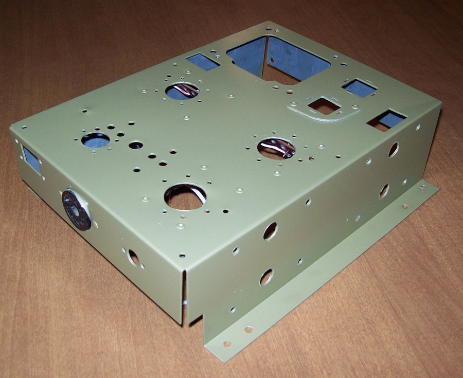

Have been quite busy (only one night last week at home) but lest you all think that I am doing nothing on this project I did get the power amp chassis fully drilled and painted. The paint is Rustoleum Metallic Sage.

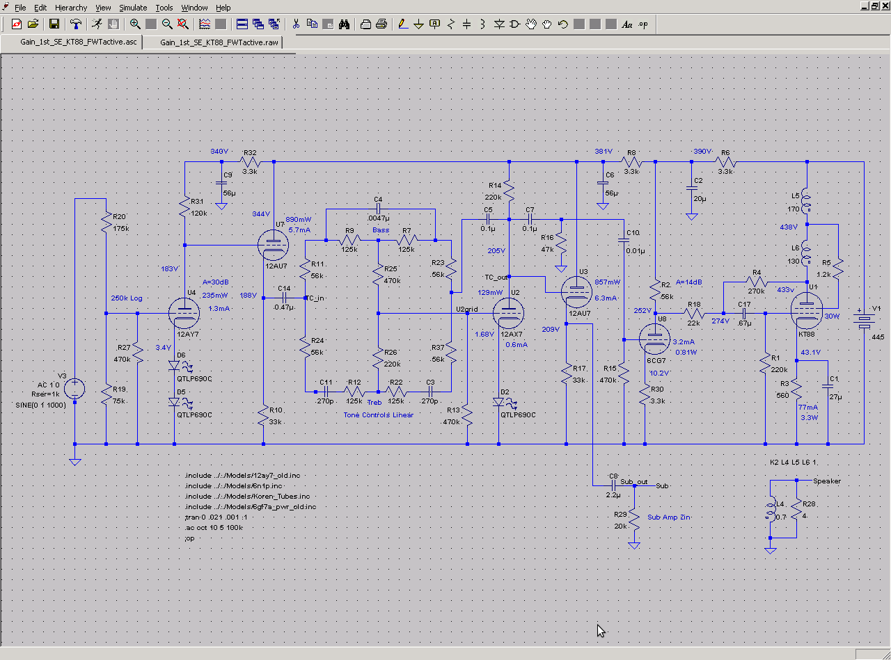

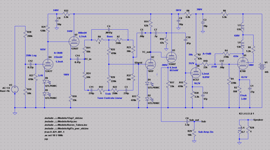

I also tidied up the schematic for the 12AY7,12AU7,12AX7,6CG7 version with a second order HP on the input to the power amp.

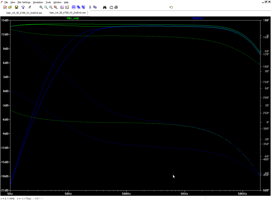

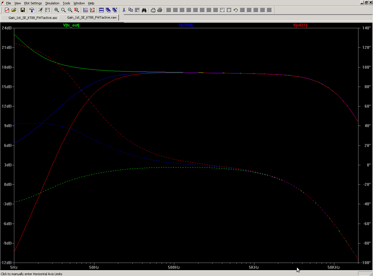

Showing the response before filter and after first and second stages.

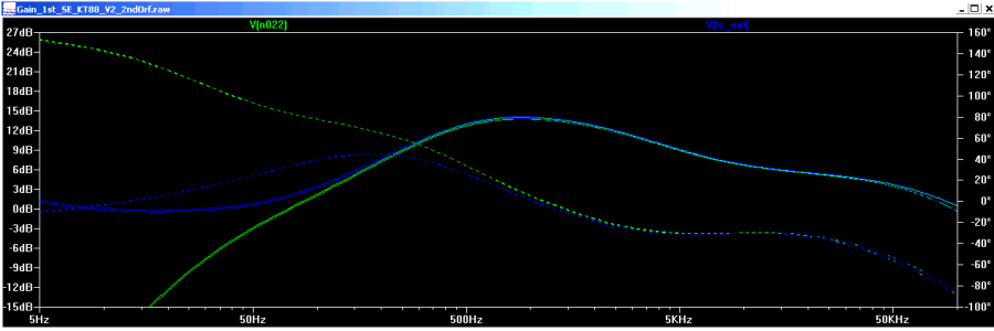

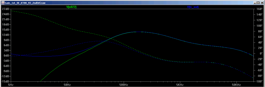

In looking at some simulation results at some of the interior nodes I noticed an interesting boost in subsonic frequencies at the output of the tone control section. I wonder if that is a real effect of some resonance or if it is an artifact of Spice...
Doh! Figured it out. I thought about it for a minute and it became obvious that C5 was too small.
R16, C7, C10 and R15 (grid leak) comprise the 2nd order HP filter for main speaker protection.
OK, understood. I had somehow missed C10!
I am not sure you need to be so careful in the design of this HP filter. You seem to have carefully chosen the first stage components to be one tenth or ten times the second stage presumably to minimise interaction. Unfortunately the output impedance of the driving 12AX7 (probably around 50K or so) affects the turnover frequency of the first stage of the filter. Secondly the relatively low resistor value of 47K effectively throws away 6dB of gain and possibly increases the distortion of the 12AX7 stage.
In my experience there is in practice little disadvantage in making both stages of such a 2nd order filter the same. So changing C7 and R16 to 0.01uF and 470K respectively would probably work just as well and get you nearly 6dB more gain.
Just a suggestion.
Cheers
Ian
That didn't work out too well. Shifted the crossover way up. I did however switch the values in the schematic to 100k and 1M with appropriate cap values and that looked fine. Would at least give somewhat better loading. Given the FB applied to the 12AX7 the actual gain didn't really change with even the 470K load.
When you say 'way up' just how far do you mean? 10%, 20% and octave?
I just modelled it with a 47K source and the -6dB point is 32Hz - just where it should be.

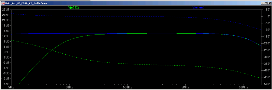

OK I rechecked the simulations and using the same values did shift the crossover up by a bit more than an octave; maybe an octave and a half and the initial slope was shallower.
So I went ahead and simulated with a 6N1P and the original filter values. The schematic looks like this...

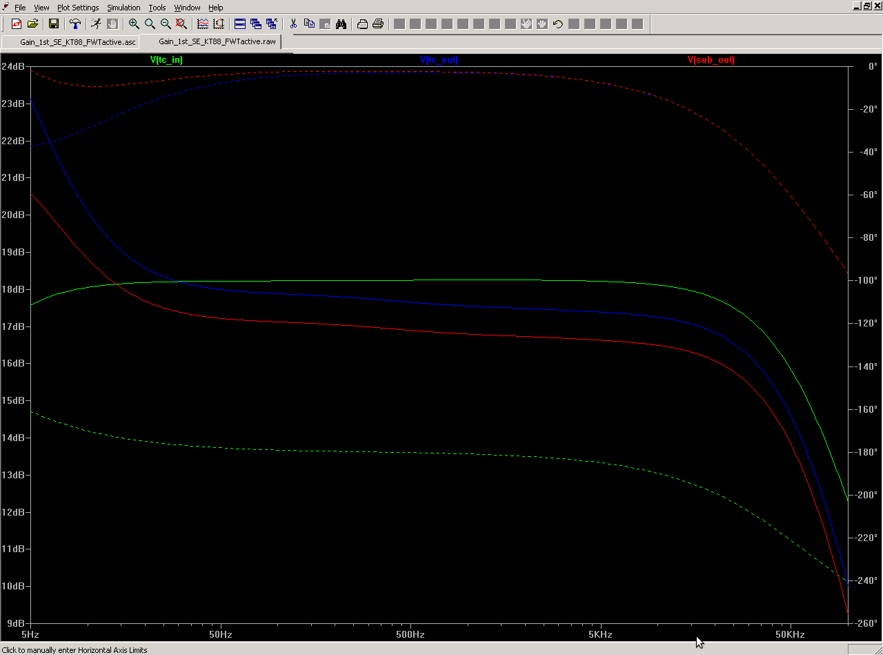

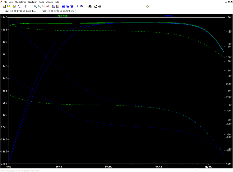

I ran some simulations of the response before and after the HP filter with the tone controls flat as well as at full boost and cut.
I had some concern that the lower mu of the 6N1P might affect the performance of the tone control section so I compared the results using the 12AX7 to that of the 6N1P and there was very little if any difference in the curves. To illustrate I superimposed the two cut curves to see how closely they track each other.

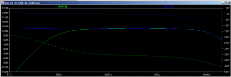

Well, it wasn't as bad as I remembered (must be getting senile 🙂) Here is comparison for 12AX7...

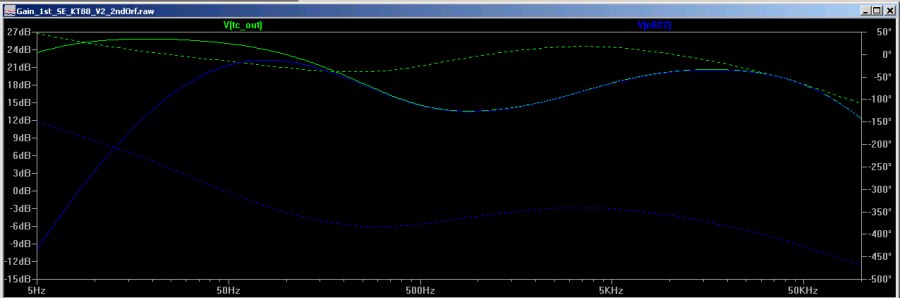

and 6N1P.
It amounts to about an octave which could easily be made up by jockeying the R value a bit. It does make for a bit more shallow slope though which wouldn't be fixed by that but it might be livable.
At the moment I think that using the 6N1P might still be the better option. It might also be possible to come up with a set of RC values in between the two as a compromise.
and 6N1P.
