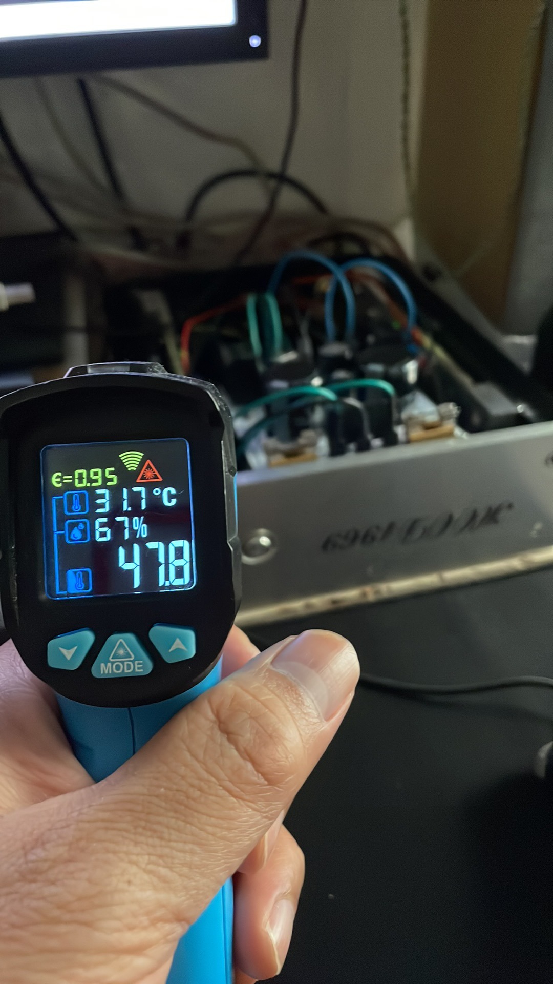

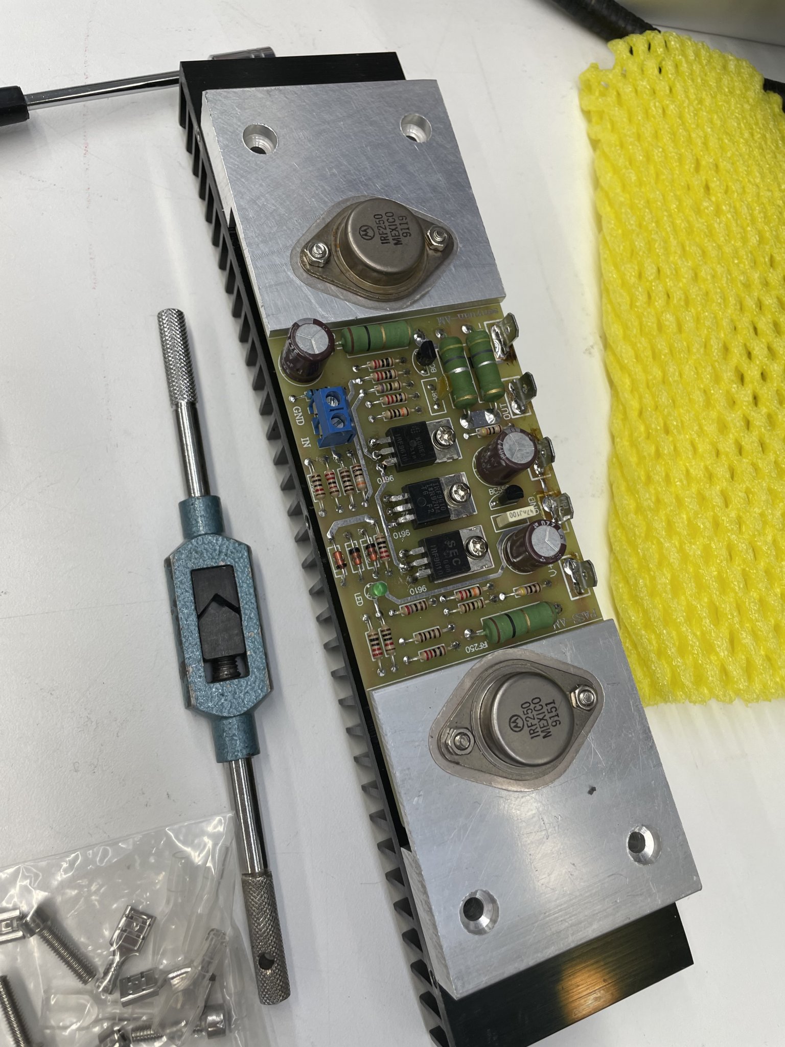

My pass am 15-20watt, I read this schematic same part only tr final using tr irf250. sound is good run 1-2 hours heatsink around 47-50 under 60 degrees.
I’m Buy from china one pair $32 USD
PSU use capacitance multiplayer c5200set
Xformer 18ct @25v.
