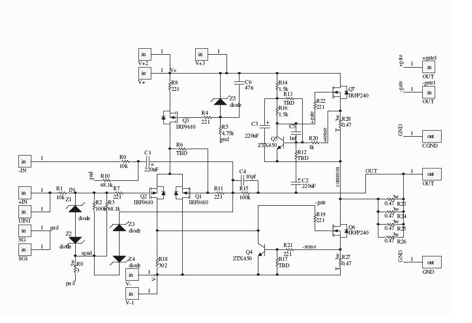

Have you read D.Joffe's paper on the interference loop when you connect two interconnects to a stereo amplifier?
Your hum could be because you have two interconnects introducing an interference loop.
R0 is HBRR. It attenuates the interference current in the loop and that attenuates the interference voltage in the signal circuit.
But I am slightly confused about why they have shown sgnd separate from gnd (the signal return). I can't find where sgnd connects to the rest of the circuit.
Yes I was confused as well. I thought I checked it on the pcb (when I've read the Joffe's paper) and sgnd was also the spkr gnd. Anyway I need to open the case again to confirm.
