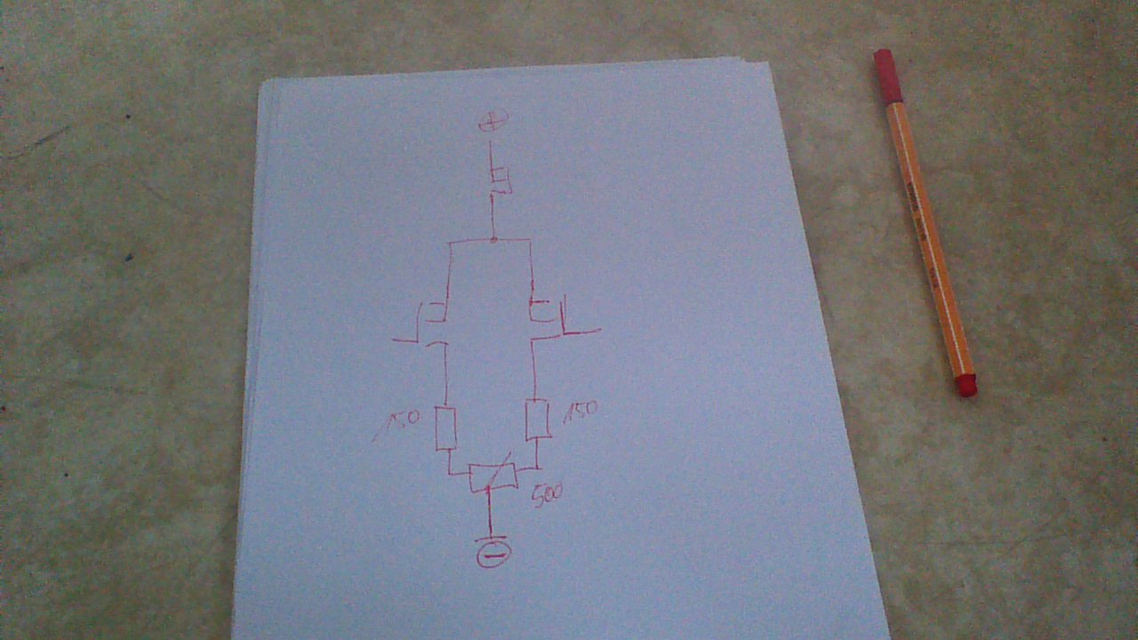

One can you can try is to run more current through the zener in question by
reducing the value of the resistor connecting the zener to ground. I'm
referring to R7 of the schematics here:

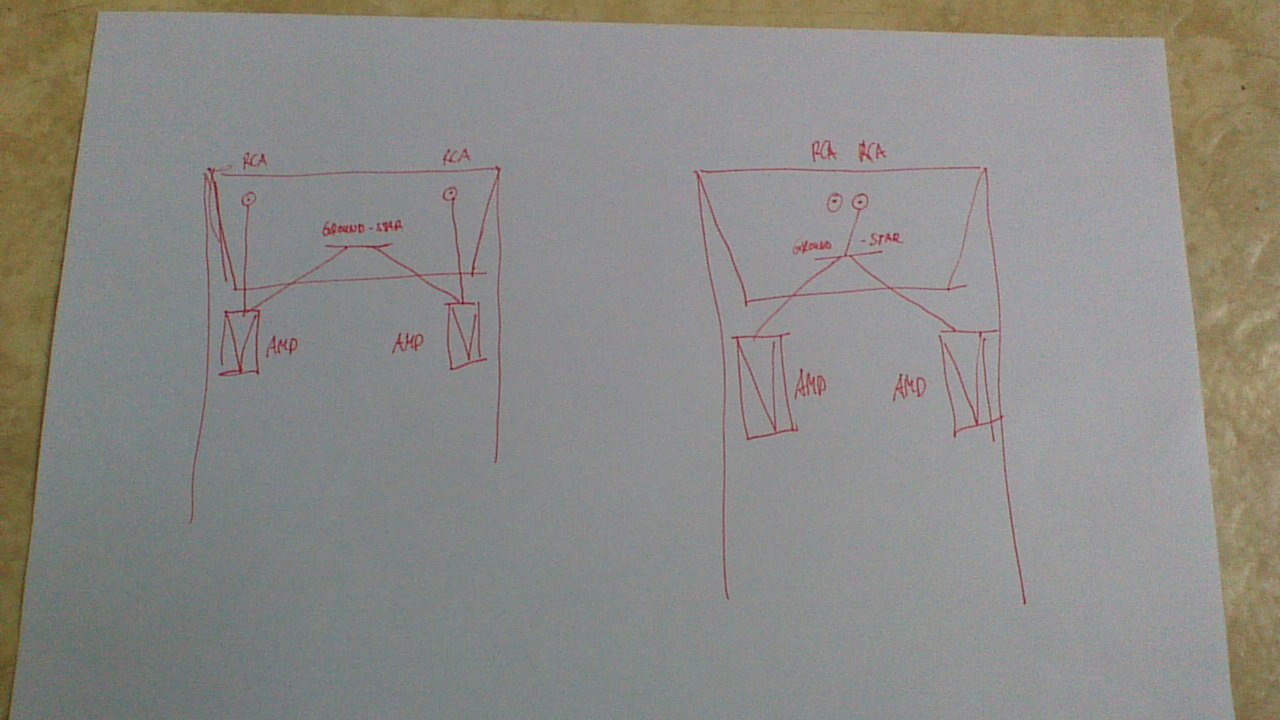

Spent sometime today to investigate the hum remaining in one channel.
I discovered that disconnecting the ground of the input of the other channel reduces this hum (but the hum in the channel with disconnected input ground goes slightly up).
The other way around disconnecting the input ground of the humming channel makes the hum slightly worse.

this seems like one channel has a big loop in the return.Spent sometime today to investigate the hum remaining in one channel.
I have read somewhere in the forum that people indeed disconnect the input ground in one channel.
You MUST ensure that EACH channel has it's own two wire closely coupled pair all the way from the source to the amplifier PCB.
Both those layouts show the return separated from the flow.
The two wire connection MUST be close coupled.
I have shielded microphone cables coming from both RCAs to their corresponding pcbs.
RCAs are isolated from the chassis.
Certainly not as shown on the sketches 2 posts above.
good.Hi,
The coax screens/shields are the Signal Returns.
Are the screens/shields connected at both ends?
