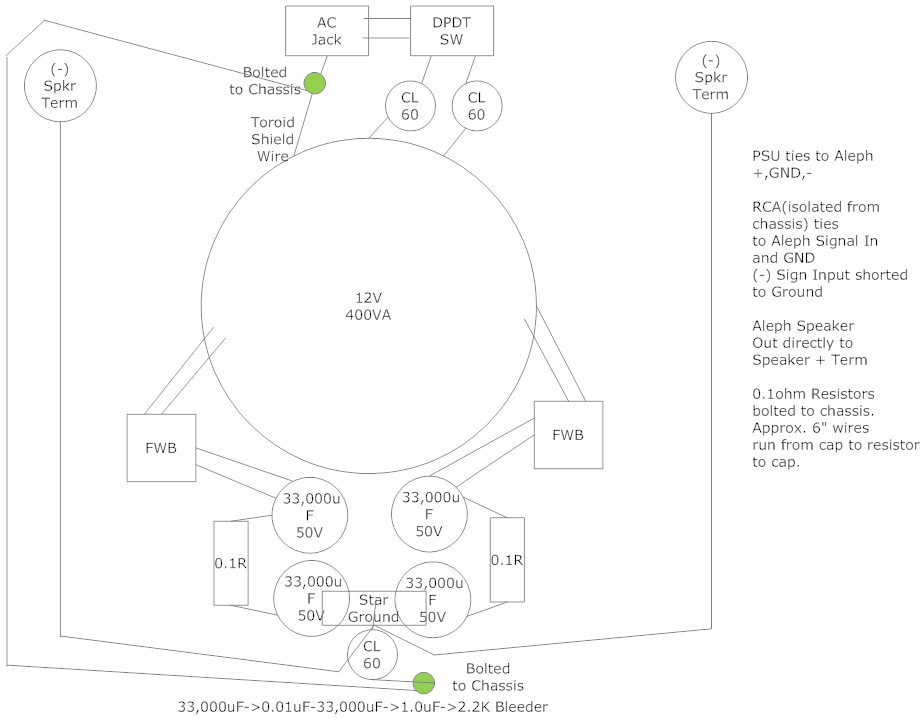

What happens if you have outputs of the two bridges go to the top two capacitors
(instead of directly to the ground point)? Also, what if you take a think wire
connecting the lower CL60 to the top green spot marked bolted to chassis?
Good idea. Picture made clear you wired it differently than I did.
In my Aleph J and H builds I connect bridge rectifiers output (both wires!) to the first cap and made star ground point after the last cap. I assume that your ground point is seeing the high ripple coming of the bridge rectifiers (check PSU designer to see how much this differs). I think it is worth trying!

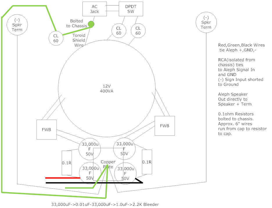

Attached is update of what I think you are telling me to try.
ok, why thin wire between the two bolts to chassis ground?
I measure between the two bolts and get about 0.18ohms,
both ground points should be solid. I thought adding long thin wire
would pick up more noise? Whole chassis bottom serves are chassis ground.
how does removing 1st stage cap grounds from star ground remove
or reduce hum? just curious as I really don't know the difference between
the two.

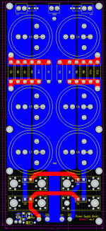

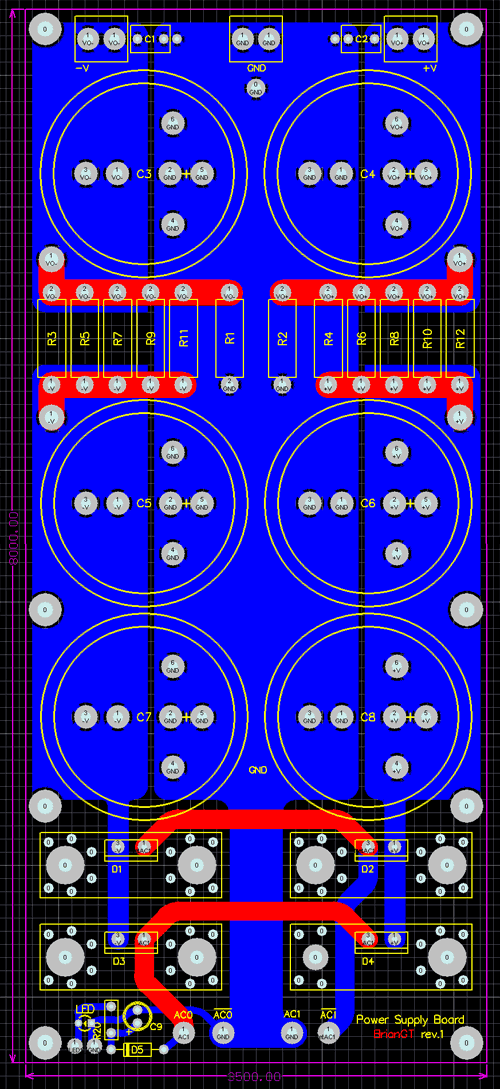

I also attached the brian gt aleph power supply PCB. Look at the ground,
all caps share same ground plane. I pretty much followed this and other
previous builds.
I wired it back up to the toroid and CRC, input shorted to ground.
I measure same 0.1Vpp at + and - on outputs of last stage caps.
Getting really discouraged. Not sure what else other than build a new
cap bank with the Brian gt board and try again. Only rules out faulty
caps or not.

Sorry for the typo: I wrote "think wire" when I meant thick wire to connect
the CL60 to just the single upper chassis ground point (so disconnected from
the lower one).
The simultaneous use of the lower chassis connection can create a ground loop.
Can you easily try this modification first?

Oh ok I see what you are saying now
I could try that or move AC ground
with long wire to where cl60 ground is

since the R ties cap plus and minus, just use wires from 1st cap ground connections to the T?
I will remove 2nd ground point chassis and only use one.
I get it now why the caps are near the rear and trafo is towards front.
I would like to know how AC main wires from AC switch to transformer
placed physically in the amp chassis. it has to cross or be near the cap bank some where before it reaches the the trafo.
Does this wiring diagram look correct now or I'm still not getting it
with the grounding for the caps.
I know I should reverse positions between toroid and caps, hoping to keep
it as and just rewiring.
BTW, the Brian GT Aleph PCB's have a CGND and GND solder pads, so do you
have 2 separate grounds wires going to the PCB or just one ground wire?
Thanks!

I'm looking at picture here:
Aleph through-hole PCB Set | Chipamp Electronics
and I think "OUT" goes to the Speaker+ terminal, "GND" goes to the Speaker-
terminal, which "CGND" goes to the 0V at the power supply.
You are correct, the Out goes to Spkr +
On the Aleph board, the CGND and GND are tied together.
That is why I brought it up. The article Albert attached shows Spkr - coming
from PSU. Not which is correct method.
I included your question about your curiosity WHY it is better not to connect the bridge rectifiers to the star point but rather to the first cap in the CRC psu. The paper explains why not all locations on a "logical" star point are equal, even when only one cap is used (as in their example). When more caps are used (CRC, CLC, or CRCRC, etc.) the problem is aggravated.
In general, when someone describes (or models) a circuit there is the assumption that connections have zero resistance (and zero inductance and zero capacitance), but that is an oversimplification. In fact, if you really want to model a circuit ALL resistances, inductances and capacitances of the circuit (in all wires and PCB traces) should be taken into consideration. When we use pre-made PCB's (which is what most of us do) we hope the designer of the PCB took care of this and we just try to keep wires as short a possible and hope for the best. If you were to design you own PCB's however, this would be something to take into account. Just search for "ground planes" in google to see what I mean.
While some prefer speaker and input ground at the star point, there are those that prefer wiring the signal and return wires closely coupled to the PCB (where PCB's support this of course, as the BrianGT boards do). With a well designed PCB this latter option should work fine. The "star point" option however will only work well if it is understood that the "star point" is a simplification and that a small distance can make quite a difference. Why this is so is explained in the article.
Just imagine how much potentials fluctuate in the rectifier output and what this can do to your tiny (in comparison) input signal!
If you decide to use the "star point" option, make sure that you reconfigure you connections (as shown in post #49) so that they are configured like the T in the article. Do not wire everything to a single point.
Something else to consider is that (with 50Hz mains) a 50Hz hum is probably due to the input supply (i.e. comes from the transformer). Only the mains input should have 50Hz frequency.
The rectifier output has double the mains frequency (the negative part of the sign becomes positive) and hence the PSU ripple will have 100Hz frequency.
Ground your input and check the speaker outputs for AC (using a scope or a good DMM in AC setting). What frequency and amplitude do you find? This should point you to where the problem lies.
I hope this helps and good luck. I hope you find the cause.

Very good explanation. I used 10 gauge ground wire for multiple caps. One side is connected to bridge, the other side is ground and +-. Zero hum.
Do you can turn the bottom-plate of the chassis? The trafo at the front, thr caps at the back? Some better placed connections/wires would result (ex: not preamp - aleph rca double ground, within aleph 2 times rca ground - two wider apart amps, wider part amps - groundstar).
Your hand-graphed picture: one secondary-winding for + (and - for ground), the other one for - (and + for ground)? Why not both windings for + and -, and central tapping? It would result in a "more honestly" sound too (less differences between + and -).
Do you use to connect amps and psu, and more, "doubled-wire". Not necessary. More diffusity.
To try to get minimal hum, under different circumstances, separate chassis, el. ground, earth (AC-power-in), use wire to connect per luster - to get different combinations to try. May be, you will find different less humming combis, with different sources and so on.
Ok, I pulled most of the wires and rewired what I could.
I did not swap the trafo and caps.
I now have speaker output minus connected directly to aleph boards.
only one one ground wire from aleph board going back to copper plate.
the 2 cap stages are seperated and only joined by wire. only one ground
wire going to chassis ground via cl60.
I am still getting hum with ear next to speakers. The ripple measurements
are different though. at first stage caps, I measure 0.6Vpp and on 2nd
stage caps, I measure 0.1Vpp. On speaker output terminals, I can hardly
measure anything yet I still hear the hum. It is most likely so low my toy
scope is barely picking it up.
how could I tell if it's related to the toroid causing the hum?
do you still think it is incorrect wiring?
I was going to try and add another CR stage in fron of the first stage caps,
but ripple is already at 0.1Vpp, that is low already?
Thanks...
Thanks...
measurements with DMM on AC(200mV range), not true rms meter
1st stage caps approx. 118mV
2nd stage caps approx. 46mV
Speaker output terminals Left and Right channel approx. 1.8-2mV
does not look like wiring or power supply related issue but the antek toroid.
added more capacitance on front end, dropped from 2mV to 1mV at spkr
terminals but hum is still present.
Thanks for everyone's help, really appreciate it 🙂
