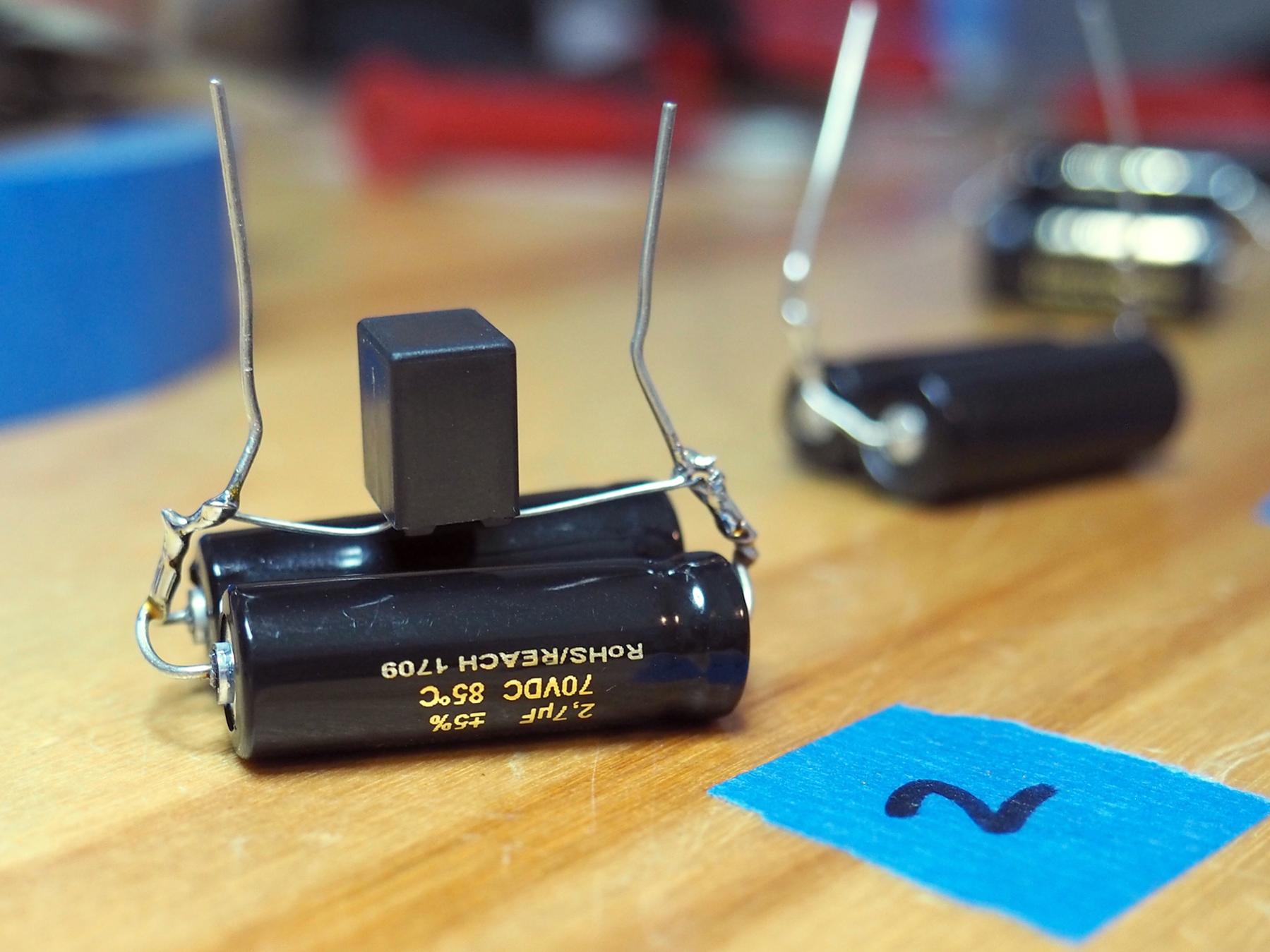

Erik, have you tried the Vishay Roderstein MKP1837 0.01uF bypass caps? There are more than a few favorable reviews. They are squarish, rather than round, but if the leads are long enough to reach around to the "main" cap, I can see them working.

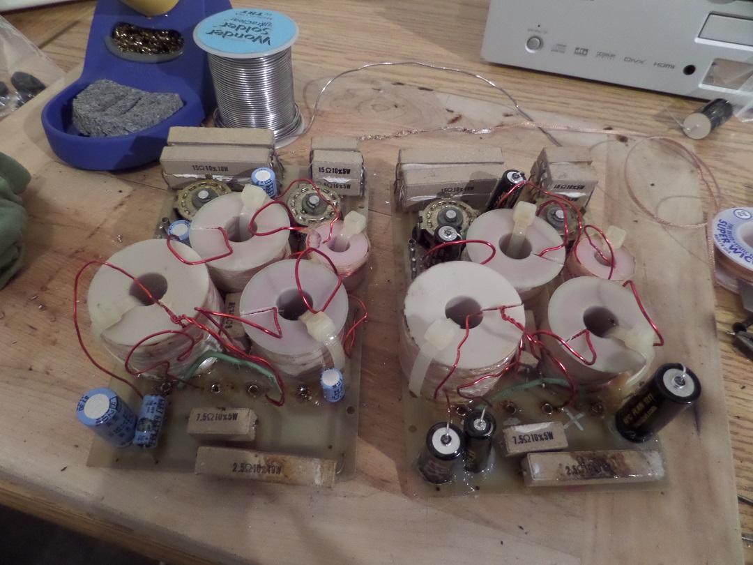

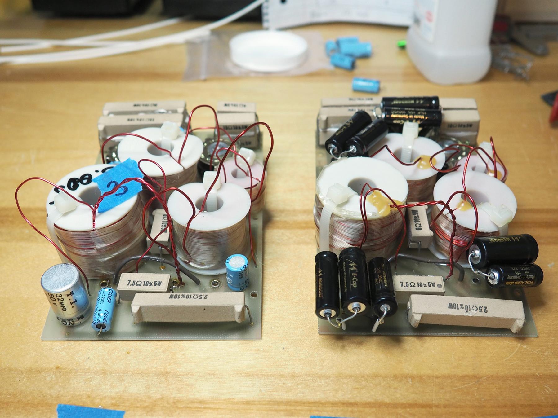

Cleaned the back side of one crossover board. You can eat off it now.

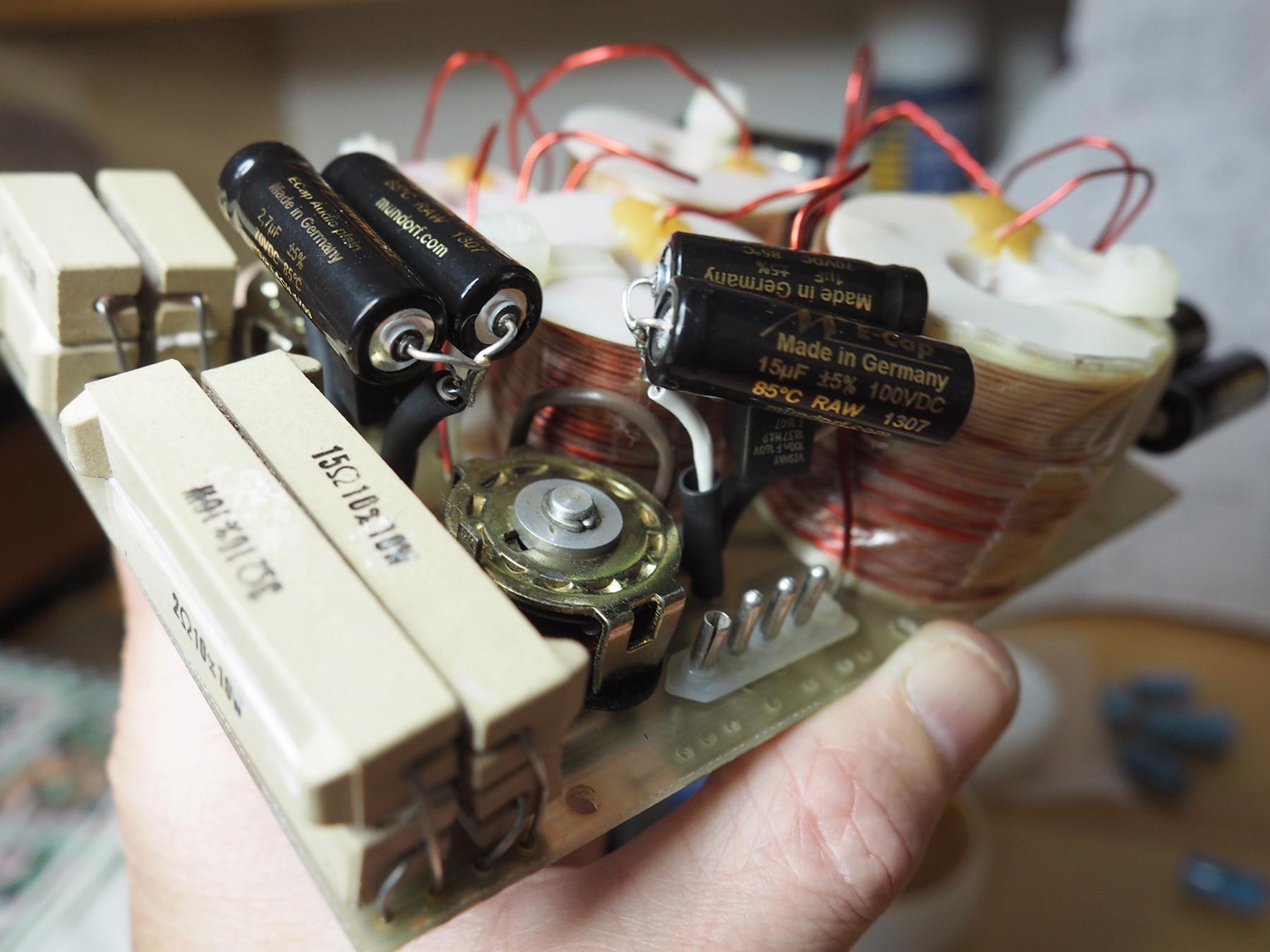

I updated a pair of M&K S-1B's a few years ago, including the crossovers . I used Mundorf electrolytics sourced from Parts Connection; these aren't exotic, but they were reasonably priced and came in the correct values. One of those terrible speaker wire pinch terminals was broken on mine, so I cut them out, and glued a piece of ABS in their place. I installed modern 5 way binding posts in the ABS, and squeezed a wire from them to the back of the PCB. The final result worked out well. I was never able to find a purpose for the second set of inputs on the speakers, so I never connected them at all.
Nice work Elextra! How did they sound afterwards?
I've never heard the Mundorf electrolytics.
Unfortunately the speakers weren't functional when I first acquired them, so I can't provide a before and after report on the sound of the recap. Each side had a bad mid, and someone had "tinkered" with one of the crossovers replacing caps with a combination of different electrolytics and film caps. I bought used mids off eBay, and restored the crossover caps to factory values based on a schematic posted elsewhere on this site. The sounded very good once I got them back together. I also had the matching sub which was 100% original, and matched very nicely.

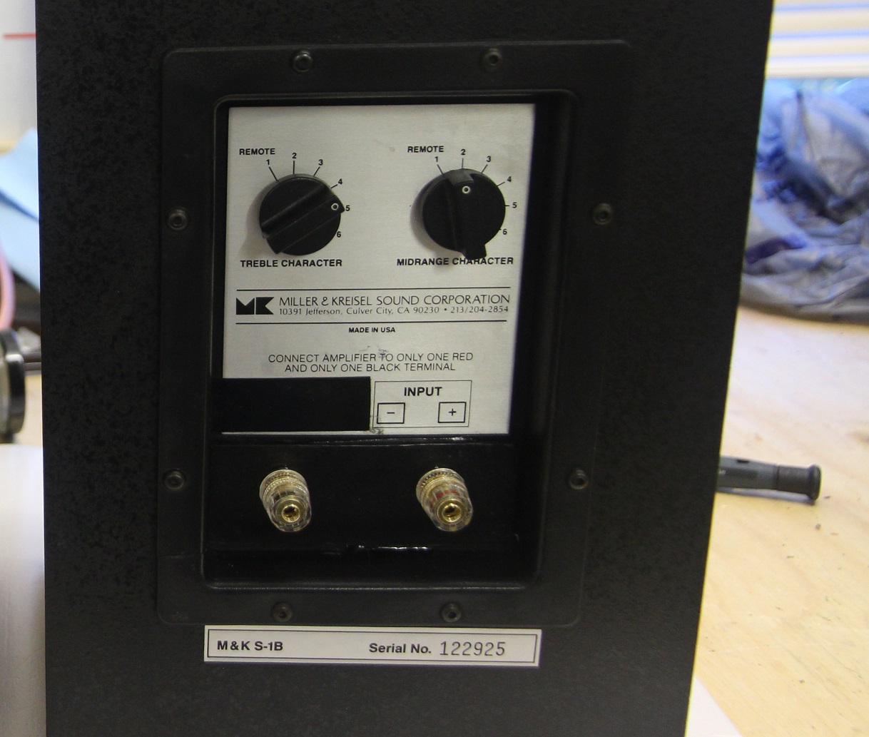

One more thing that just came to mind...I had to cut down the length of the binding posts to get the crossover board back in place. It was a bit if a hassle, but those factory pinch terminals are so horrid it was worth the effort.
Yes, those terminals were terrible, but true to the era.
The extra terminals were for an external, remote controlled EQ system for studios. I never saw one in real life.

Well, I got my parts and low and behold, I realized that 20% tolerance wasn't a good idea. To be honest, I didn't pay attention to that value, and in the end, after soldering one set of three caps, I got a value over the 10% tolerance designed into the circuit. Plus, I think having three caps in a grouping is too clumsy-looking, not to mention C1-C3 where I'd be adding a 0.1uF film bypass cap. So I just placed an order for "better" Mundorf Ecaps with 5% tolerance. Here's my part list for posterity, and once I get these installed and can have a listen, I'll report back. I hope I will hear "some" difference in a positive light, or I may feel like I wasted too many hours hunting and selecting what I thought might be the right solution on a budget.
Mundorf MLytic® Ecaps (all are 10mm x 30mm unless noted below)
1.00uF, 50Vac - 70Vdc (10x20mm)
2.70uF, 50Vac - 70Vdc
3.9uF,50Vac - 70Vdc
6.80uF, 50Vac - 70Vd, (12x30mm)
10.00uF, 100Vdc
15.00uF, 100Vdc
22.00uF, 100Vdc

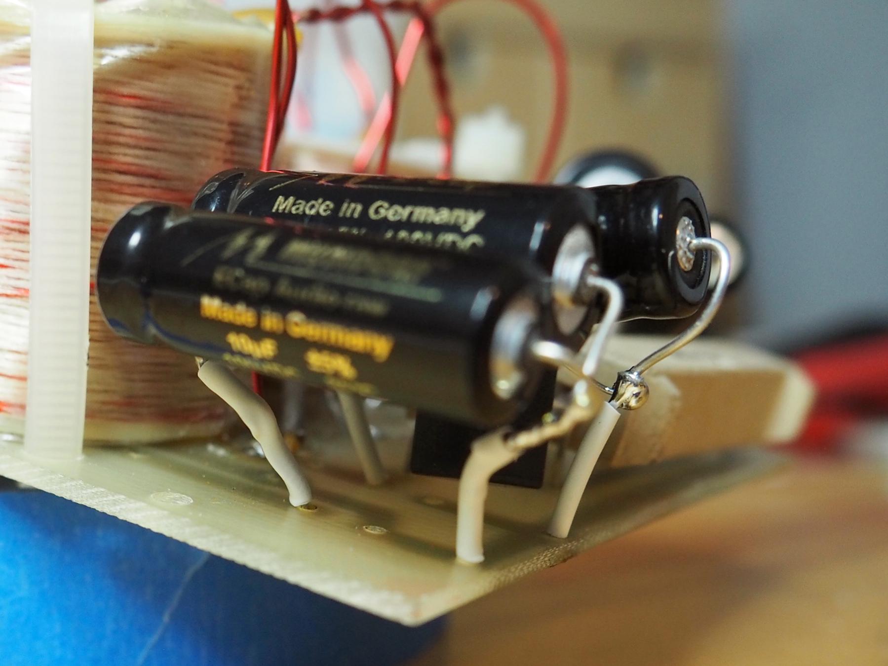

also ordered a foot of Mundorf 24 awg silver/gold hookup wire for where I'll need to extend the length of conductors on C1 and C2. Wire is insulated and solid, which should help me position caps well.
I still plan to add the Vishay-Roderstein film bypass capacitors that measure 0.1uF (MKP 1837 Series), which because they are film caps, are almost dead on value. These will only go on C1 - C3.

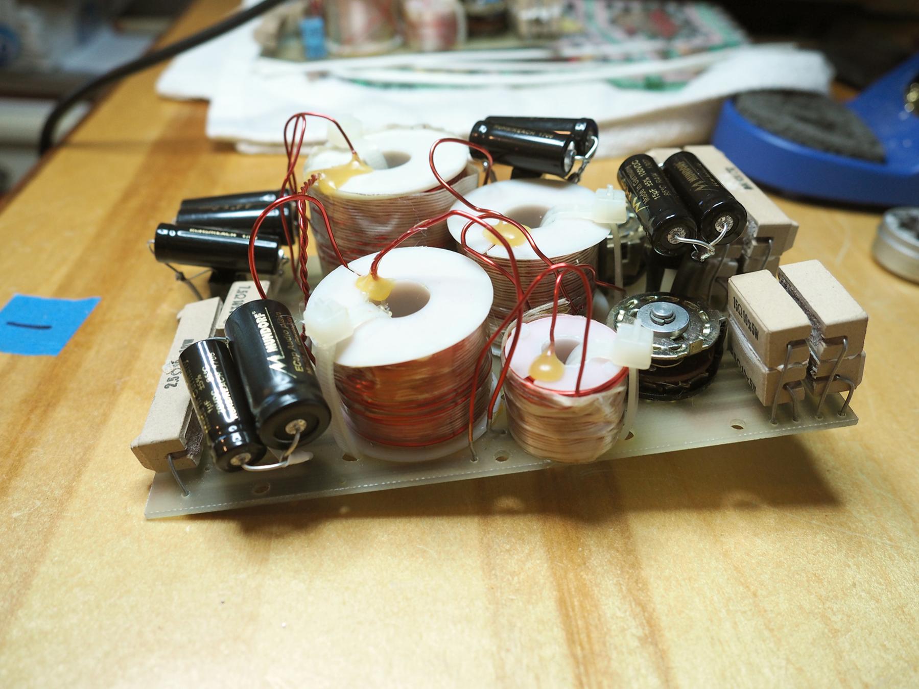

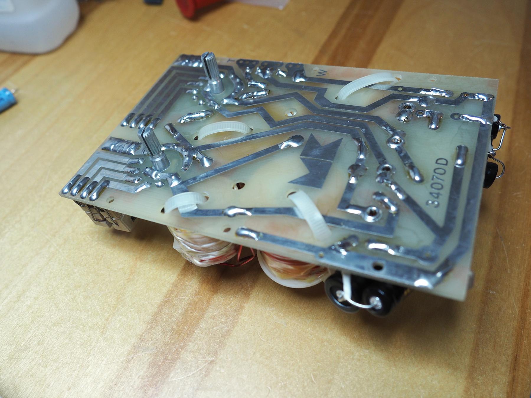

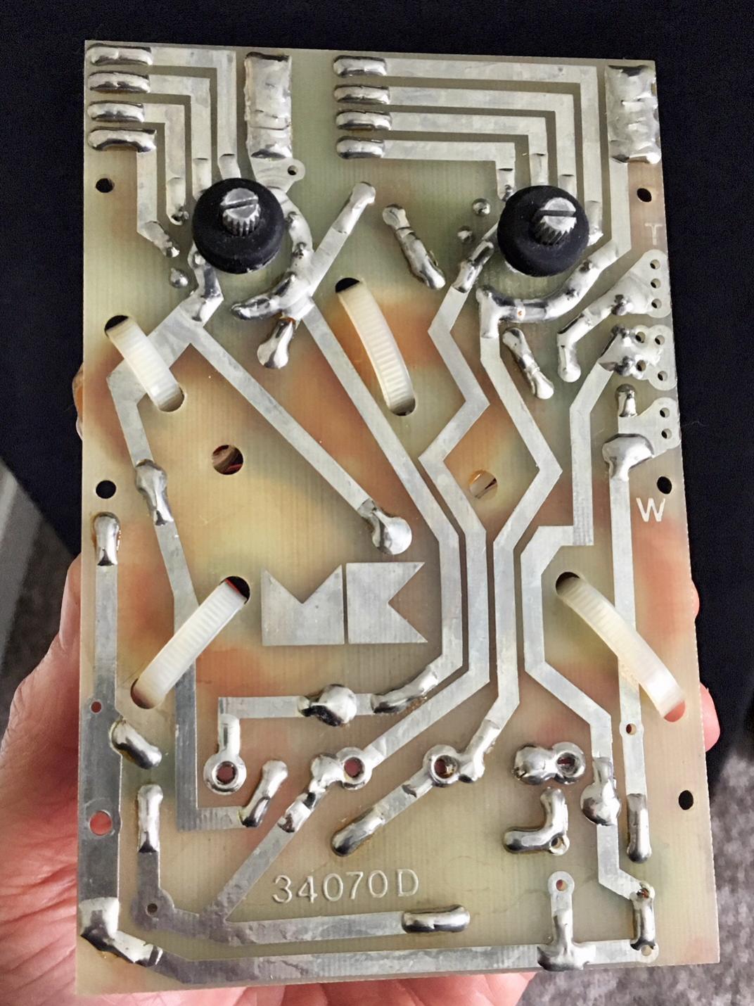

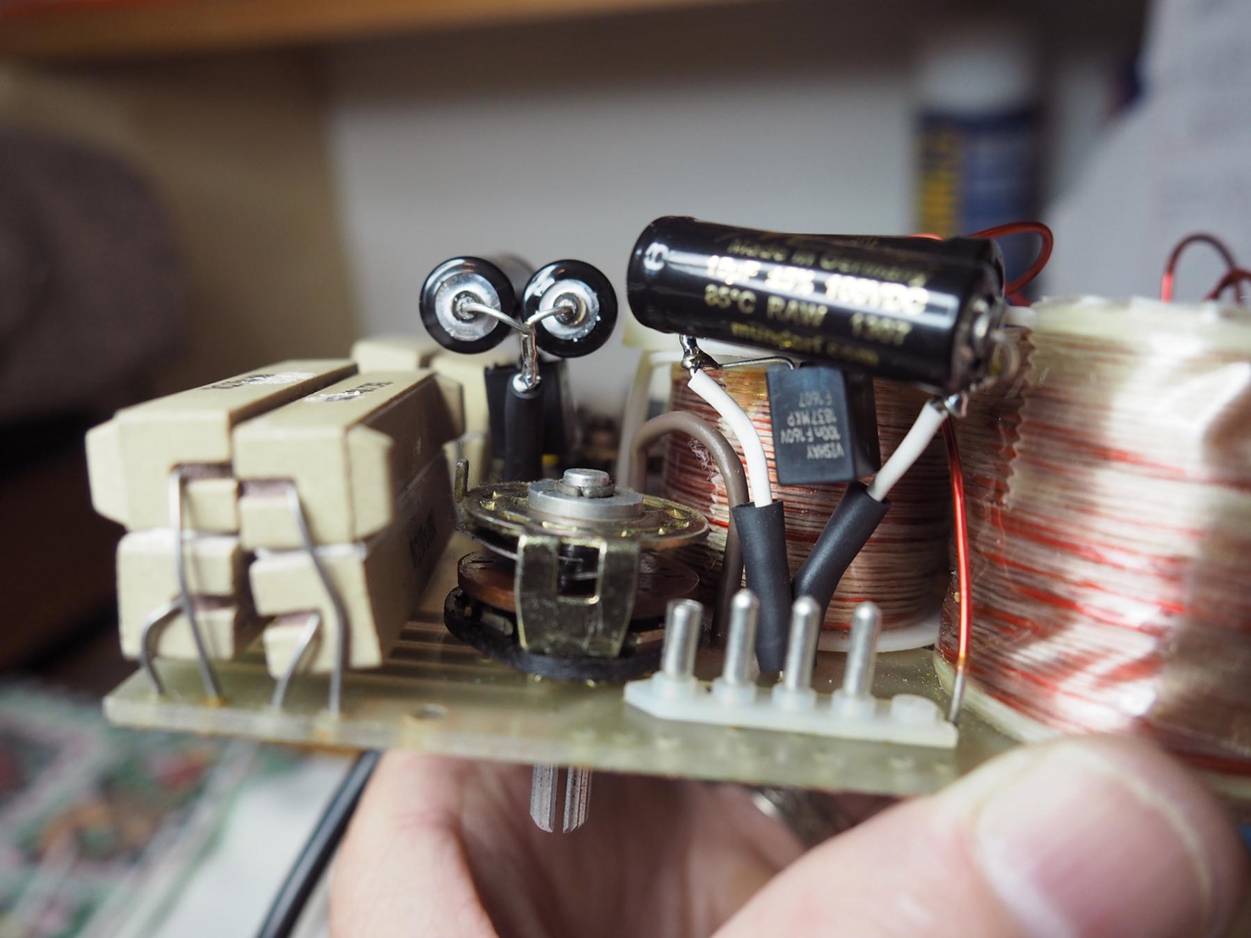

Finally got one crossover done today. Looks nice and sounds nice. But I have a small problem. When I push in on the Treble control, sound cuts down. Not off, down, as in to the level of the lowest setting, which is dull. When I don't push on it, no problem.
All the solder traces are good, or at least were before I installed the board. There was no flexing during that process. Before I desolder the main terminals again, I wanted to see if anyone has a suggestion.
Additional info that may be important ... there was white paste around the base of each tone control shaft that covered all the solder points for each position. I asked Ken K about it and he didn't remember what that was. I assumed it was some protective paste put on to prevent shorting out?? I did not replace that "goo" ...
I pulled the crossover out to play the speaker while moving new caps around and didn't notice any change. The change ONLY occurred when pushing on the control shaft. The midrange control shaft/pot has no issue.
Any ideas?
Any ideas?
Just investigated some more and what I notice is that with the main shaft is pushed hard enough, you can see if move from the inside of the crossover ... it moves maybe 0.5 - 0.75mm and it's at the end of that movement, the tweeters are losing signal ... when I leave the switch at any setting, no issue. So possibly, this is simply a weak point of the pot that since it won't be in the "pushed in" state, except for pushing the plastic knob onto the shaft, there may not be anything to be concerned about.
I also "feel" like the missing goop is not an issue, since what I think is happening is that pressure, pushing the potentiometer shaft inward, is causing "something" to lose a strong connection.
Thoughts? Feel free to knock sense into me so I can move on to the other crossover. 🙂
Went ahead and finished the other crossover ... I figure what I'm experiencing is the wiper is loosing connection when I push the knob in, which ain't how you normally use it.
