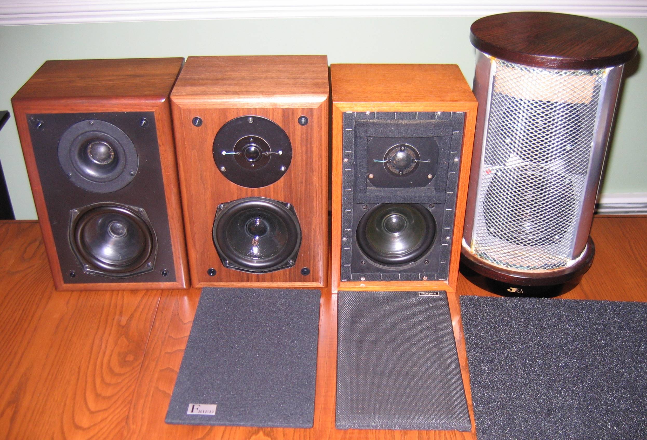

I have seen various attempts on the 5" polycone plus 1" tweeter theme:

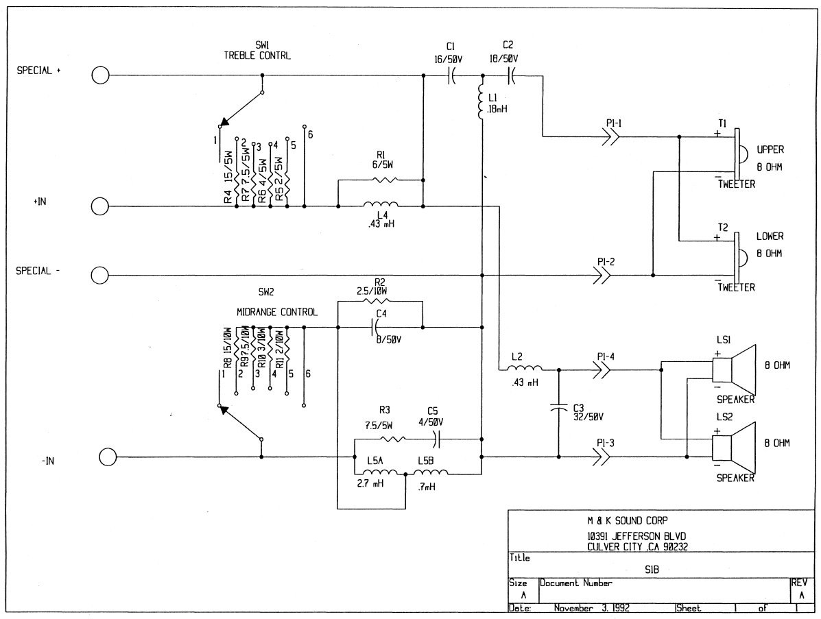

It may help to understand it with a little more background.
M&K sold an external control module for these speakers in professional situations. When you used it, you were to use the Special inputs (+ and -)
But for home, the normal connections were used (IN+ and IN-)
Think of the Special inputs as bypassing the EQ sections and using only the HP and LP filters. You can see this way that even with switches set to bypass there is still some extra EQ being applied.
So, the actual crossover is a very simple 3rd order HP and 2nd order LP. Everything else is EQ.

OK, I think I see a couple of mistakes in the schematic. Of course, it may not be, but this is how this now makes a lot more sense:

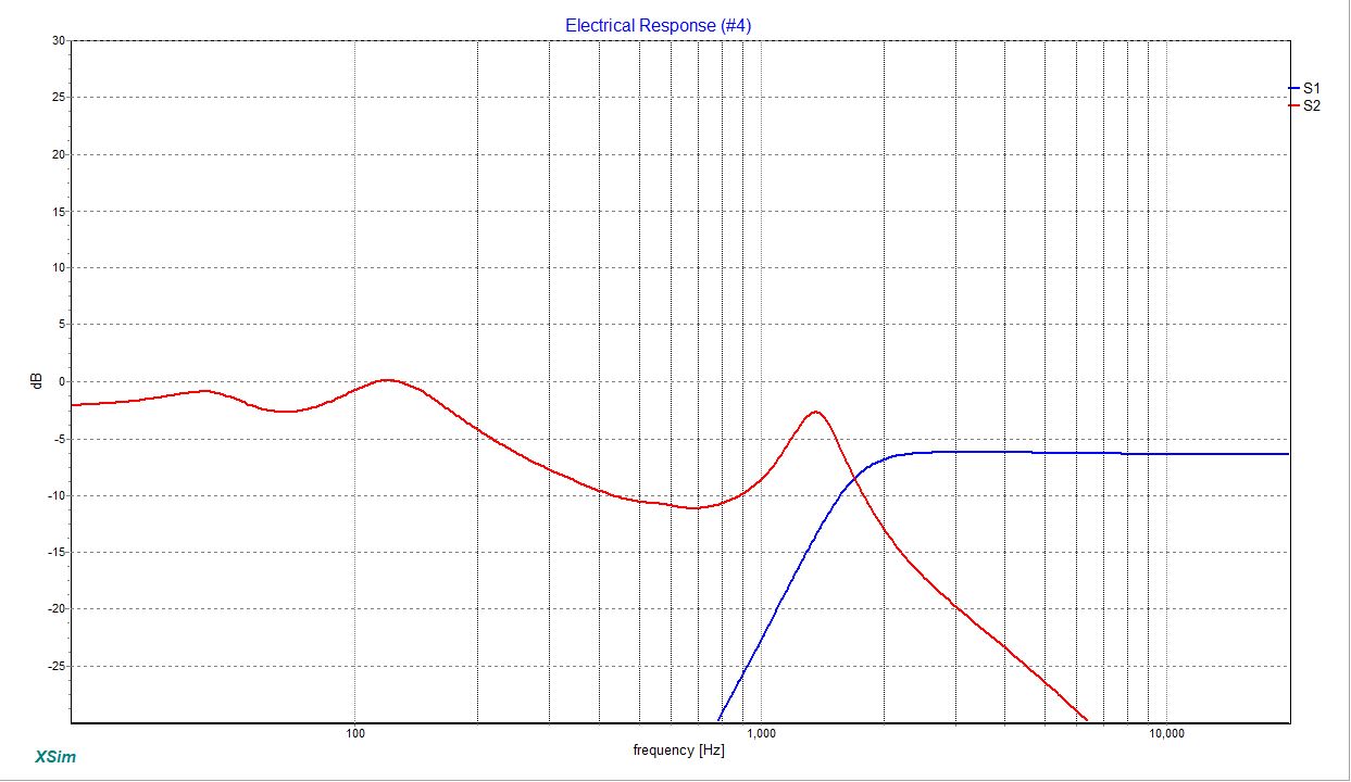

I've simulated this a little using XSim, with ideal tweeters and 5" Peerless woofers I happen to have data for. The range of values make a lot more sense now. The midrange contol causes a broad depression centered around 500-700 Hz and the treble control acts like a volume control, and the levels blend much better.
The tweeter level adjusts from 0 to about -6 dB, again, given ideal drivers, YMMV given actual tweeter impedance curves.
Here is a pic of the transfer function with the adjustment resistors shorted:

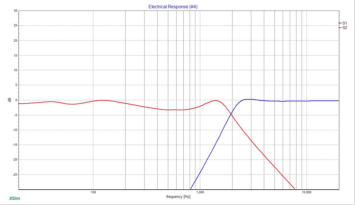

As well as using the maximum resistance:

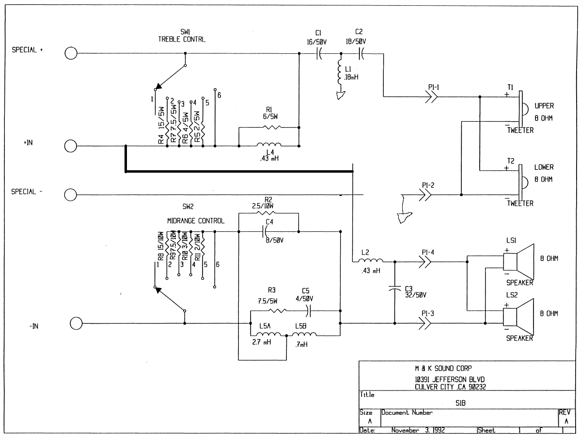

One other minor note, I think C3 goes directly to ground as well. Only tracing and measurement can tell for sure though!

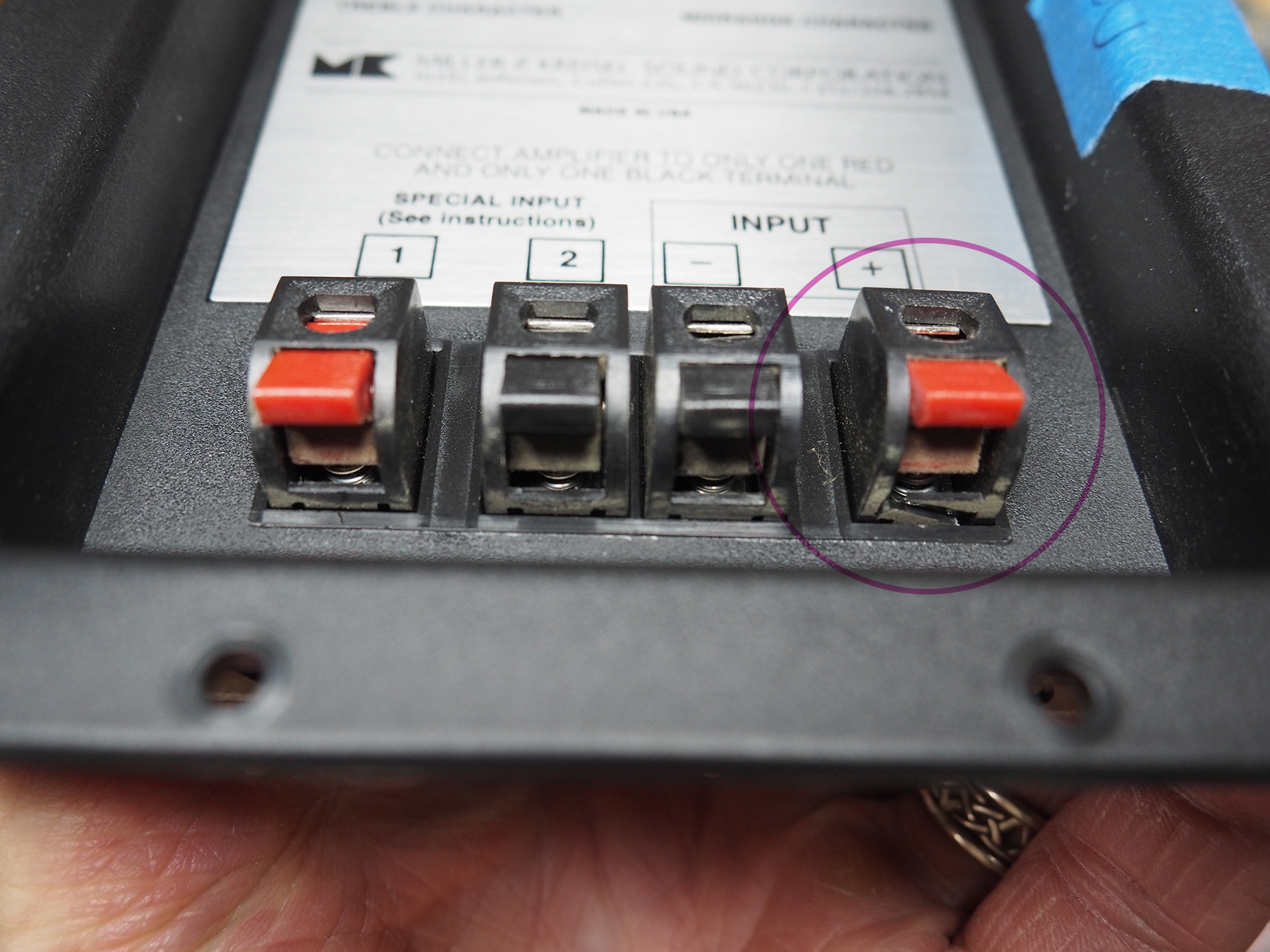

Erik, from what I have read, I'm not supposed to run into special inputs direct from amp, or in my case, the sub. I'm pretty sure they are for using the external control box M&K sold.
Exactly as I stated above. It doesn't explain the schematic fully, so I think there were some mistakes, which is VERY common.
