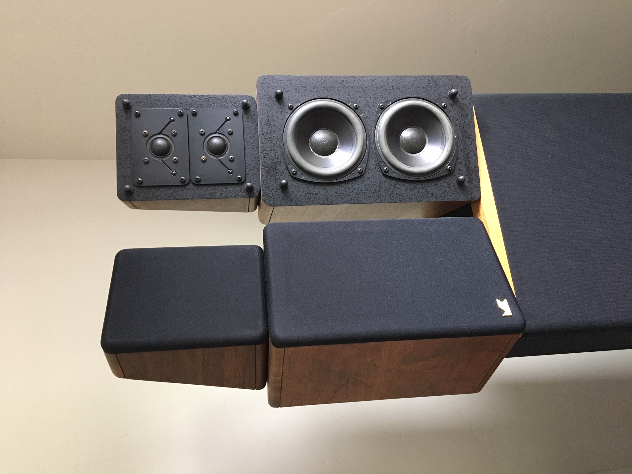

I have a mint pair of MK S-1B's that sound great. But I wonder if updating the caps will offer any improvement and figured I would see if anyone here has experience. Mine have the Peerless dome tweeters. I did find another thread on AK where the owner pulled the crossovers. The caps are small and easy to get to, but there were comments about the position of the inductors (there are 4).
What I'm hoping to get is some experienced advice on how to chose caps that will be an improvement. I've seen so many opinions on types of caps that I want to avoid getting into a roller coaster of "rolling" caps until I find the right ones, which would take awhile, but also open up the possibility of reaming the threads on the panel fasteners by repeatedly opening up the speakers.
I'm not looking for esoteric options, but something that is a known quantity.

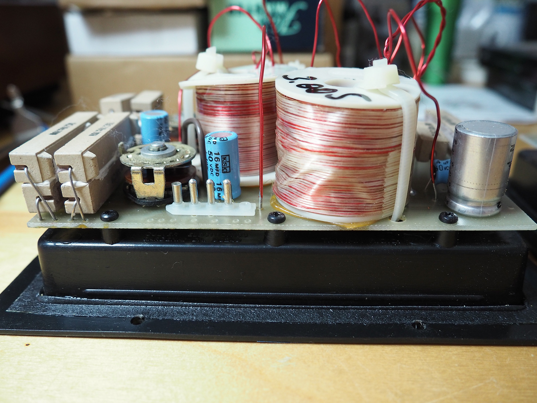

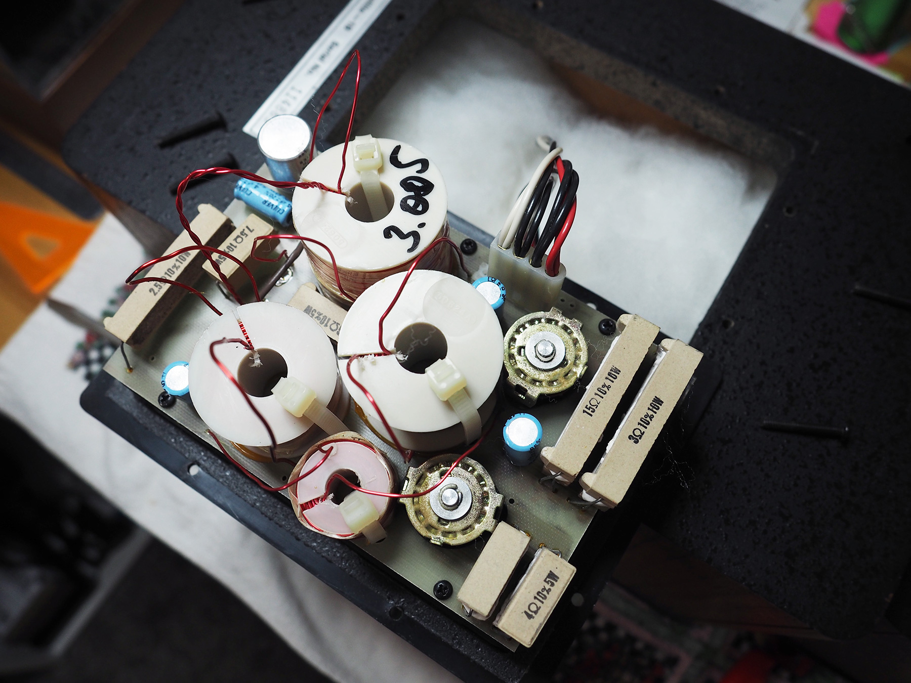

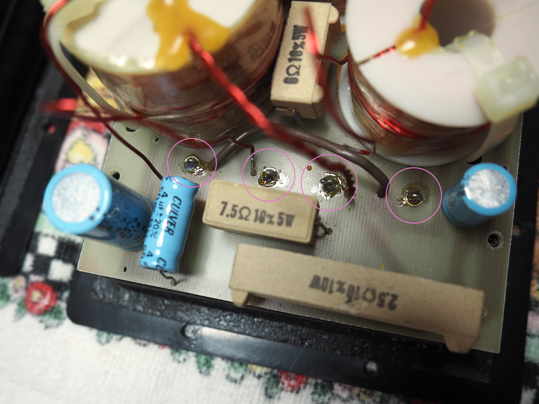

Found a pic:
Those coils are very poorly placed, and the caps are physically tiny. Perhaps you should consider a completely external crossover instead? I would only keep the coils in the original.

You hit on the placement issue I read somewhere else, and that two of the coils should be turned 90 degrees. The caps are small and at that size, I can't imagine having to spend much for good replacements.

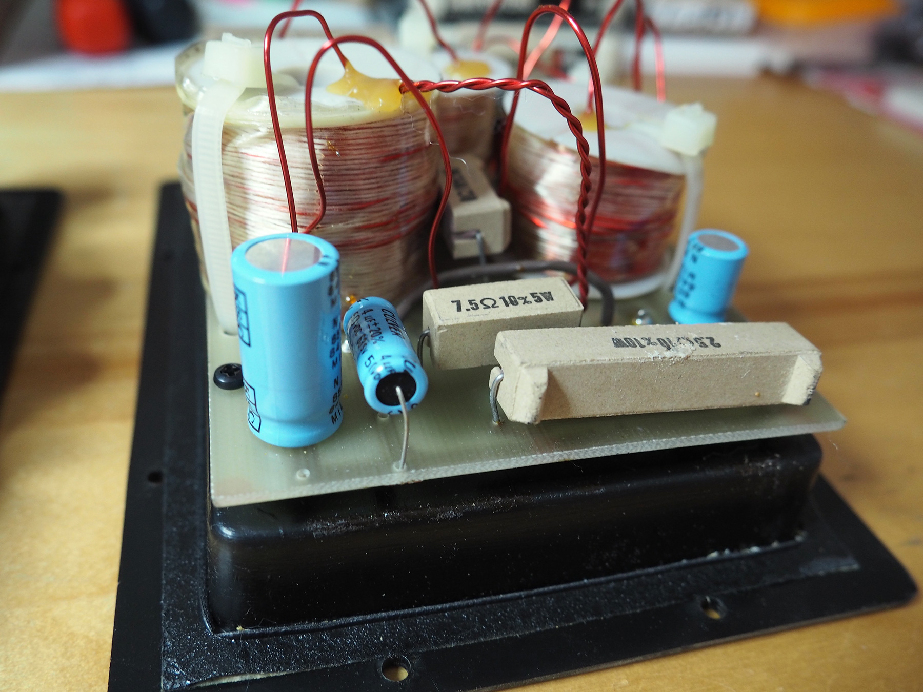

What I meant to say, is those electrolytic caps are going to be a lot smaller than any nice film caps, so replacing them in place will be a challenge.
Among the physically smallest caps I recommend are the Mundorf MKP range. I avoid Solens except in low pass filters where price is a major issue.
An alternative may be to replace the electrolytics with modern versions, and use small value film caps to bypass them.

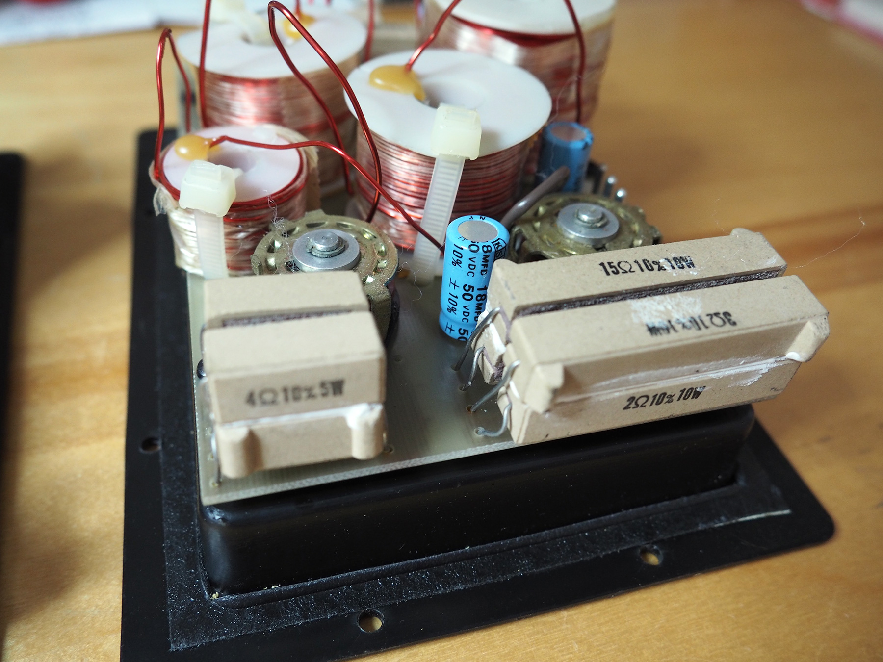

Well, this all depends how far you want to go.
I strongly suggest you map out the schematic first. It is _possible_ that only 2 of those coils are used at a time, so interference may be less severe than we think.
Also, instead of wires, I'd replace those resistors. Mills are smaller, affordable and best sounding.

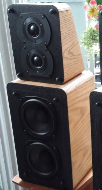

That's an interesting speaker, my friend. Sort of PA-type thing I like:
Two SEAS 5" polycones, two Vifa tweeters. Maybe soft dome, maybe mylar/plastic. 😎
Wired in parallel, you'd guess from the 4 ohm impedance.

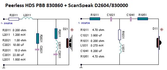

You don't usually have to work too hard to get 5" polycone plus tweeter working well. Second order LR2 or even third order BW3 3.5kHz filters usually do it, especially since time-aligned. Doubling drivers usually gets people moaning about combing effects, but I don't mind that.
Doubling drivers TTMM is an interesting piece of physics. You get the same sound level for half the room power on axis. Thing is they radiate less above and below axis, so sound quieter, especially to the neighbours. It's the projecting PA sound. Loudness falls off less with distance. MTTM is another valid layout.
Tweeters: Two 1" soft-dome
Mid-woofers: Two 5" polyproylene cones
Power: 7 1/2 watts min., 400 watts max.
Frequency Response: 75 - 22 KHz +/- 3db
Impedance: 4 ohms

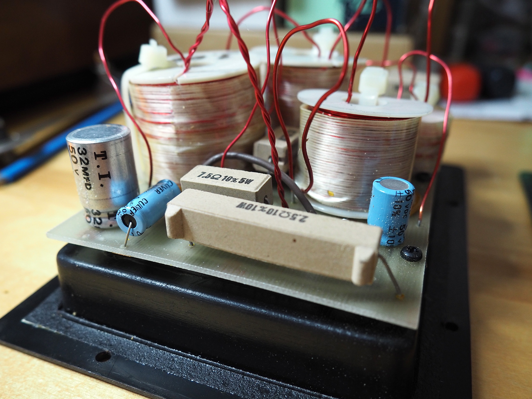

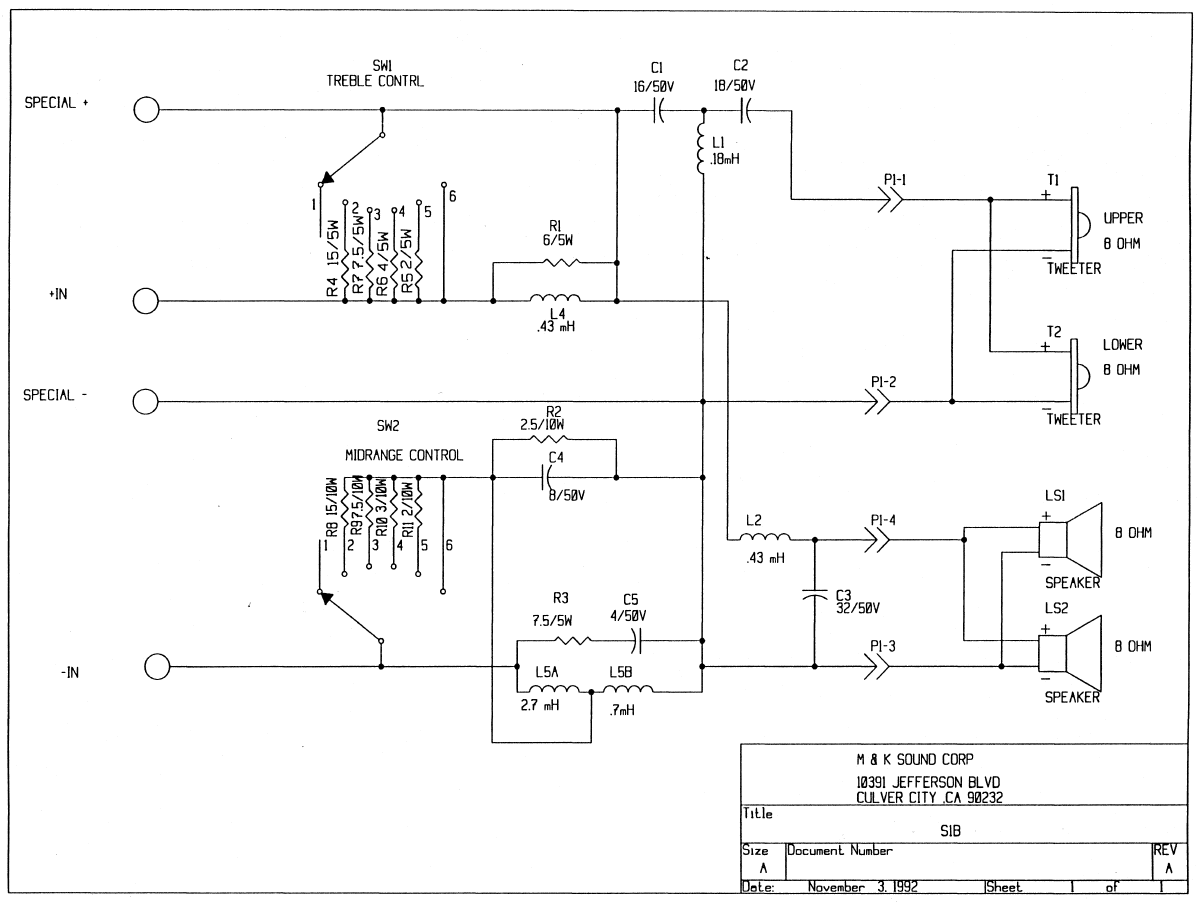

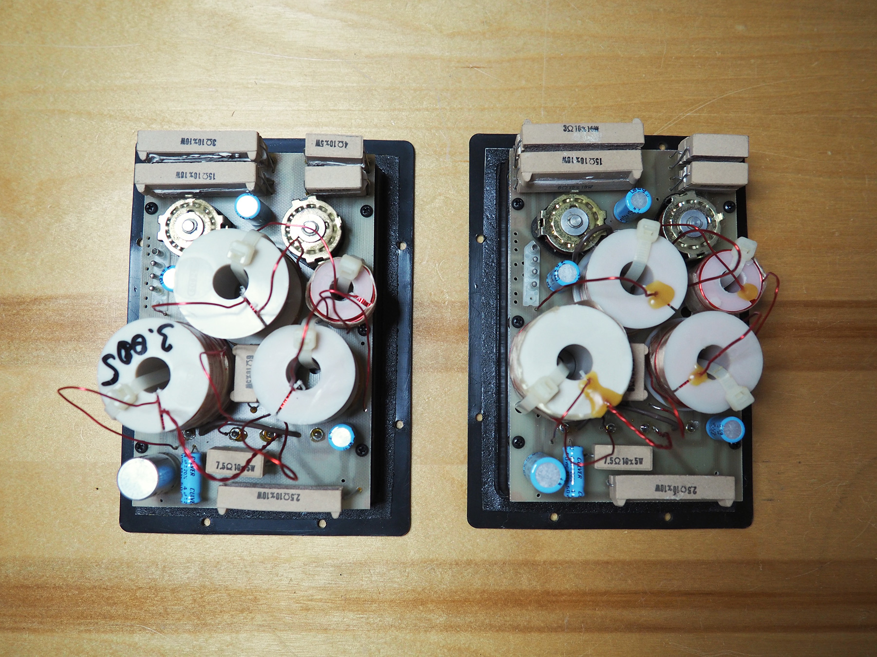

Pulled crossovers and found that one cap is a different brand on one, same value, but probably ran out of the KSC used on all other NP caps. I'll post pics today. Camera battery is charging .... a few notes.

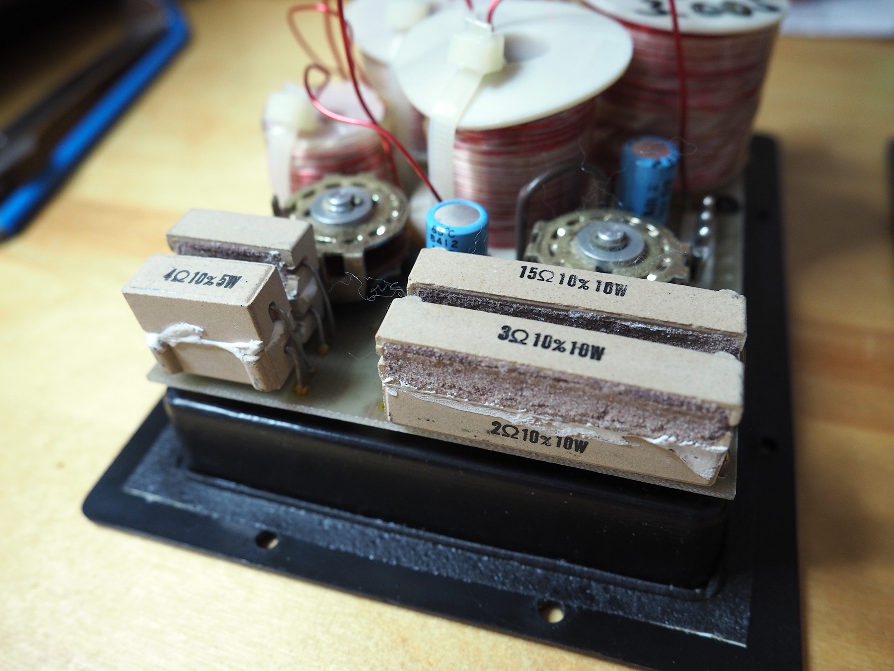

Cement resistors on the character adjust circuits are stacked and each side is glued. Not sure if that is necessary, but the values are:
10W on the midrange side
2/3/6/15 ohm
5w on the treble side:
2/4/7.5/15 ohm
The remaining cement resistors are:
6 ohm, 5W
7.5 ohm, 5W
2.5 ohm, 10W
The rest of the (radial) electrolytic caps are all 50 VDC:
4 uF (axial)
8 MFD
16 MFD
18 MFD
32 MFD
Have to get back to work. I'll pull PCB later to map circuit, unless Ken has a copy he'll share. 🙂

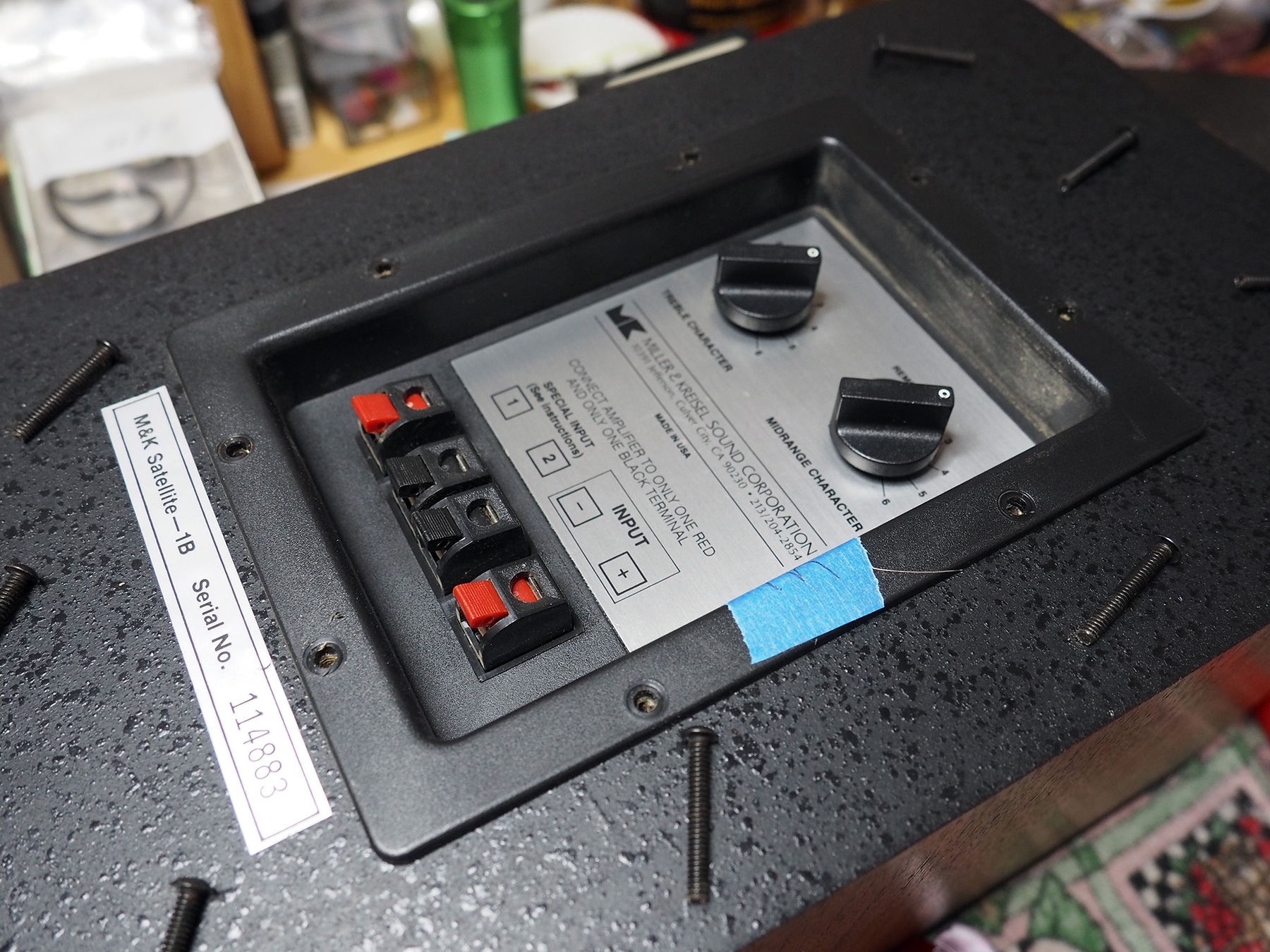

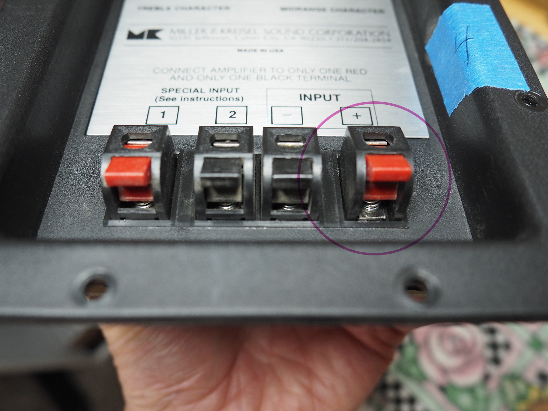

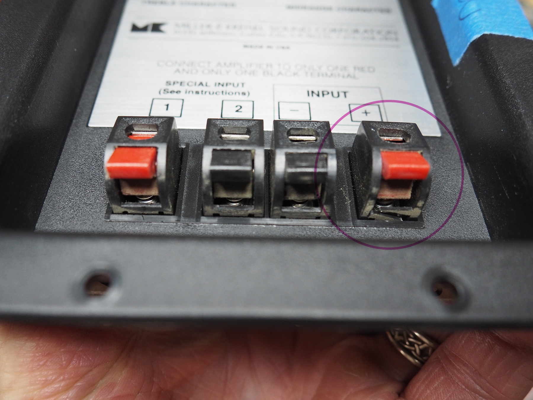

Well, I can't figure out how to pull the pcb off down by the speaker terminals. They appear to snap in place, but I have now broken a small piece of one, and see that the same place on the other crossover has the same broken piece. I may want to source someone's clean terminals since I'm guessing there is not room to put modern posts. I have a set, but they are too big.
Here's three pics. The third shows solder points that I am guessing need to be desoldered to pull apart?

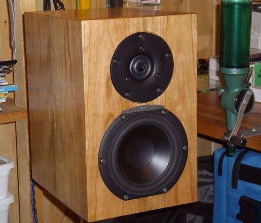

Here's Troels Gravesen's small MT speaker: Peerless HDS PPB 830860
I really don't find anything Mathematically difficult about converting that to an MTTM or TTMM design.
