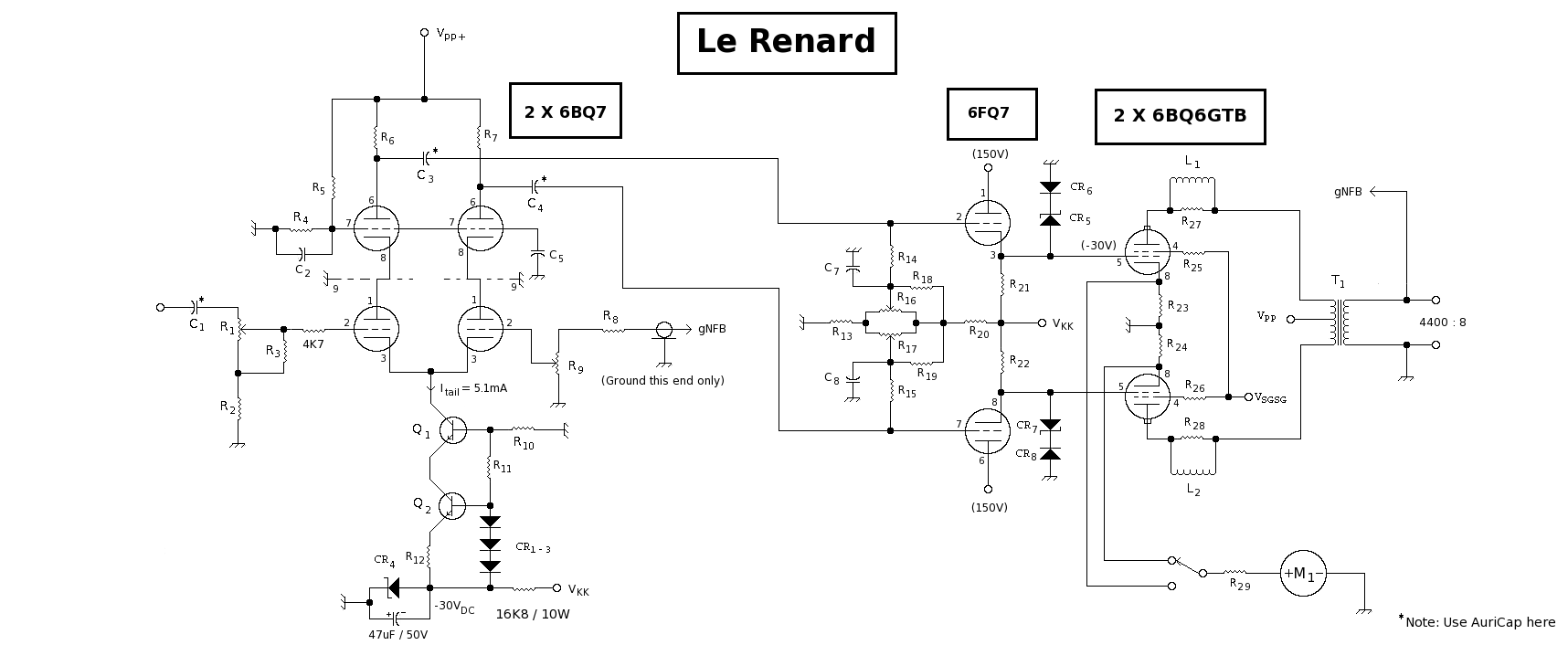

I've done this design, and it's not a problem. The cascode has a lot of the same properties as a pentode: high voltage gain, high plate resistance, small Ci. Use the same precautions: keep all leads as short as possible, use sockets that come with a central metal pin and ground it as directly as possible. Use the upper triode grid bypass capacitor to do double duty as an electrostatic shield. The main advantage the cascode has over a pentode is that there is no "screen" current, so you can use decoupling here to remotely locate the voltage divider. (The schemo was a prelim version, and the actual construction has 1MEG grid resistors with 0.1uF bypasses straight to the ground plane on each upper triode.)
You may get oscillations (I did: a weak one at several MHz) and these can be answered with grid stoppers. Once the stopper was added, no more oscillation.

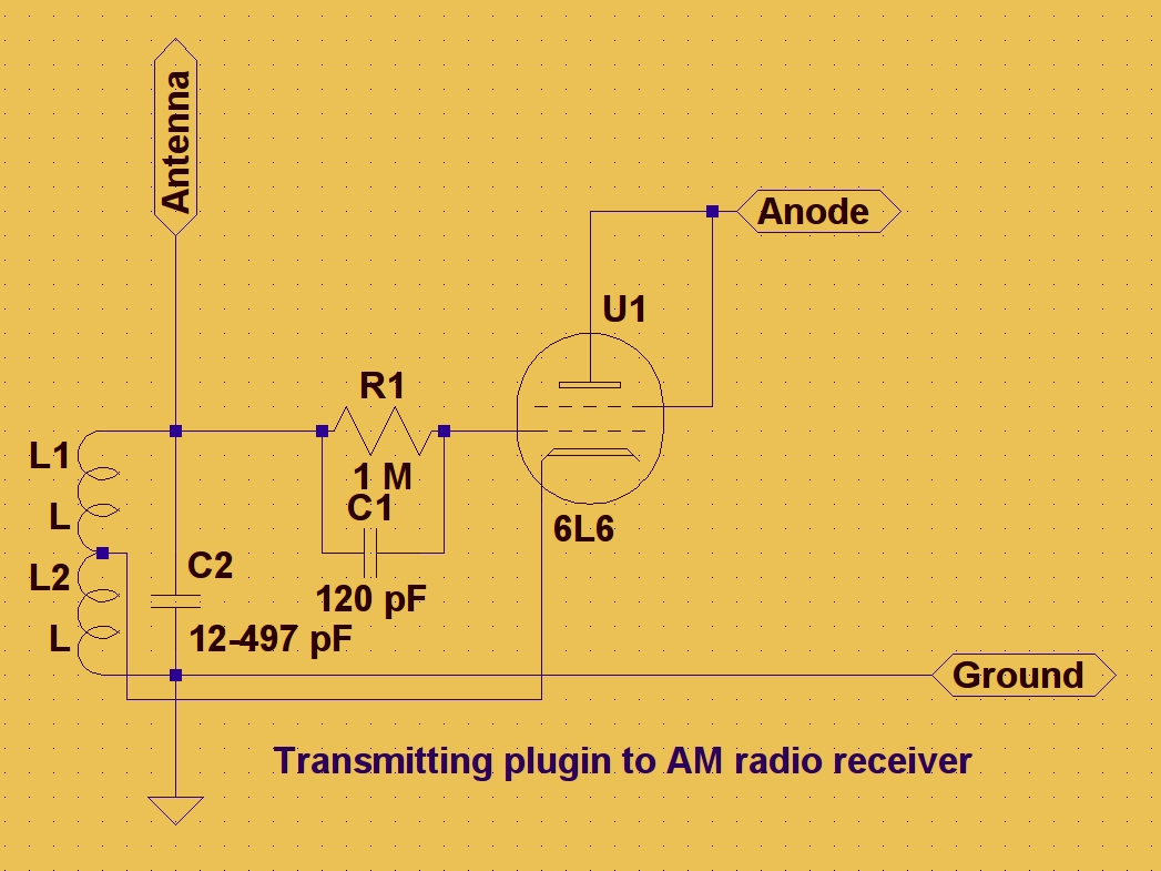

We used even less when were kids. 😀
However, it was illegal. But 4 wires under an output tube of any radio receiver were turning it into an AM transmitter. Well, antenna switch and a microphone were needed. Sometimes carbon microphones were used, so one more resistor to power it was going to cathode of an output tube. 😀
Are these additional grid stoppers on the upper grids? I'm thinking they would have to be small enough compared to the reactance of the upper grid decoupling caps not to interfere. I've wondered about that.
Definitely not. The cascode is a two stage amp: grounded cathode --> grounded grid. The upper triode is a GG, and you want to keep impedance out of the grid connection as much as possible by either a direct connection or a stiff bypass capacitor if that's not possible. impedance between the grid and ground will promote instability. This is why the grounded base is less stable than the vacuum tube grounded grid: that irreducible rb. Or why 811A GG power amps sometimes require neutralization, especially at the higher frequency SW bands: internally, there's a couple of inches of wire between the grid and ground.
