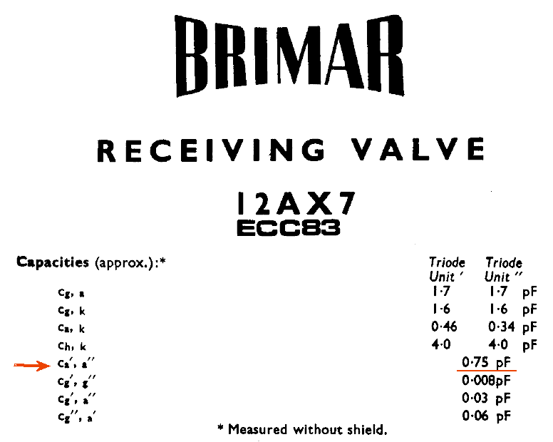

...an Electro-Harmonix 12AX7 datasheets lists {Ca-a} 520pf! ...
OK, so none of our Classic Circuits work, because they are swamped by +Positive+ Feedback, and we never noticed for all these decades.
Brimar listed 750femtoFarad. There will be some variation with construction details, but not 1000:1. 12AX7 plates are all about so big, there's room in the bottle, they are all about so far apart.
That agrees with my own measurements (about 0.6pF for a 12AX7LPS).Brimar listed 750femtoFarad. There will be some variation with construction details, but not 1000:1. 12AX7 plates are all about so big, there's room in the bottle, they are all about so far apart.
