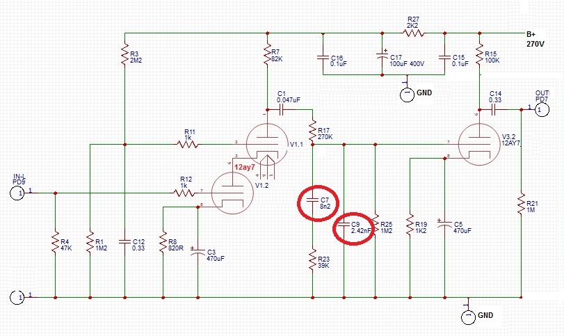

Hi all. I have been searching for a good economical substitute for Silver Mica caps used in the RIAA section of my valve phono stage. Opinions seem to be very mixed when it comes to RIAA cap choice.
Has anyone used np0/c0g with good results. TDK manufacture through hole leaded versions, (FA series) and they are inexpensive, high temp tolerant, 100 volt rated, and priced at about 10% of Silver Mica caps.
Thoughts please. Schematic attached. Thanks

Silver mica capacitors can be microphonic and have a fairly high temperature coefficient - I used to use them and another type with the opposite temp co to stabilise a vco circuit.
Good quality mica caps should not be microphonic, and the temperature coefficient depends on their class (1 to 4): it varies from +/-200ppm/°C for class 1 to +/-20ppm/°C for class 4.
Even +/-200ppm/°C is not what I would call fairly high: it is just a bit more than PS.

COG are used in microwave targeting radars, microwave steerable Ethernet antenna's and used in critical oscillator circuitry... Only problem is generally in SMD only available in low values, other than that an excellent cap, even if it is a ceramic!

You could also look at film caps, other than mica. They should be available in those values and are quite good and stable.
Even available 2% tol less than $ 1 although large: mouser 80-F462AK822G1K0C
Or mouser 80-MMK5822J63J01TA18
For the other for instance mouser 667-ECW-HA3C242H4 + a small cap parallel.

I forgot to mention a very reliable film and foil part that is great, the Wima FPK2.
Had several years of listening to a cog part in a Nakamichi amp, and the wima was a very welcome upgrade, less harsh and sibilant. I chose that over a polystyrene one because I wanted a more punchy sound with this setup.
I guess if a thermally stable part makes you feel good, then the cog would be a good choice.

Yes, because if you check the data sheets for COG and the WIMA you specified there is little difference and those would probably only be of a concern if your up in the MHz/GHz
In practice, C0G is hard to beat. Small size and surface mount, specs on par with PP, and most likely a more consistent manufacturing process.

Thanks for the replies. Think I will give the TDK FA series a go. They have leads. Nothing to lose at the price and probably sound ok. I will order the Wima FKP2 caps also and compare the 2 types. Much cheaper than silver mica alternative. I am pretty much building a point to point version of the audio note kit m3 phono stage but avoiding all of the boutique parts in the original (caps at £30-40 a piece, resistors £6-10 etc.). A friend has the standard kit which sounds very nice. Should be interesting to compare my 20% budget version to the original.COG are used in microwave targeting radars, microwave steerable Ethernet antenna's and used in critical oscillator circuitry... Only problem is generally in SMD only available in low values, other than that an excellent cap, even if it is a ceramic!

Didn’t see this until now; the application is a 220pf in series with a 1.5kr feedback capacitor in an old Nakamichi car amp.
Trying to get 500 volt COGs with enough pF to be useful as an audio amp Miller cap is like pulling teeth. 500 volt micas are all over the place. 100 volt caps are fine if you’re into building low power amplifiers. My stuff often needs a wee bit more.
