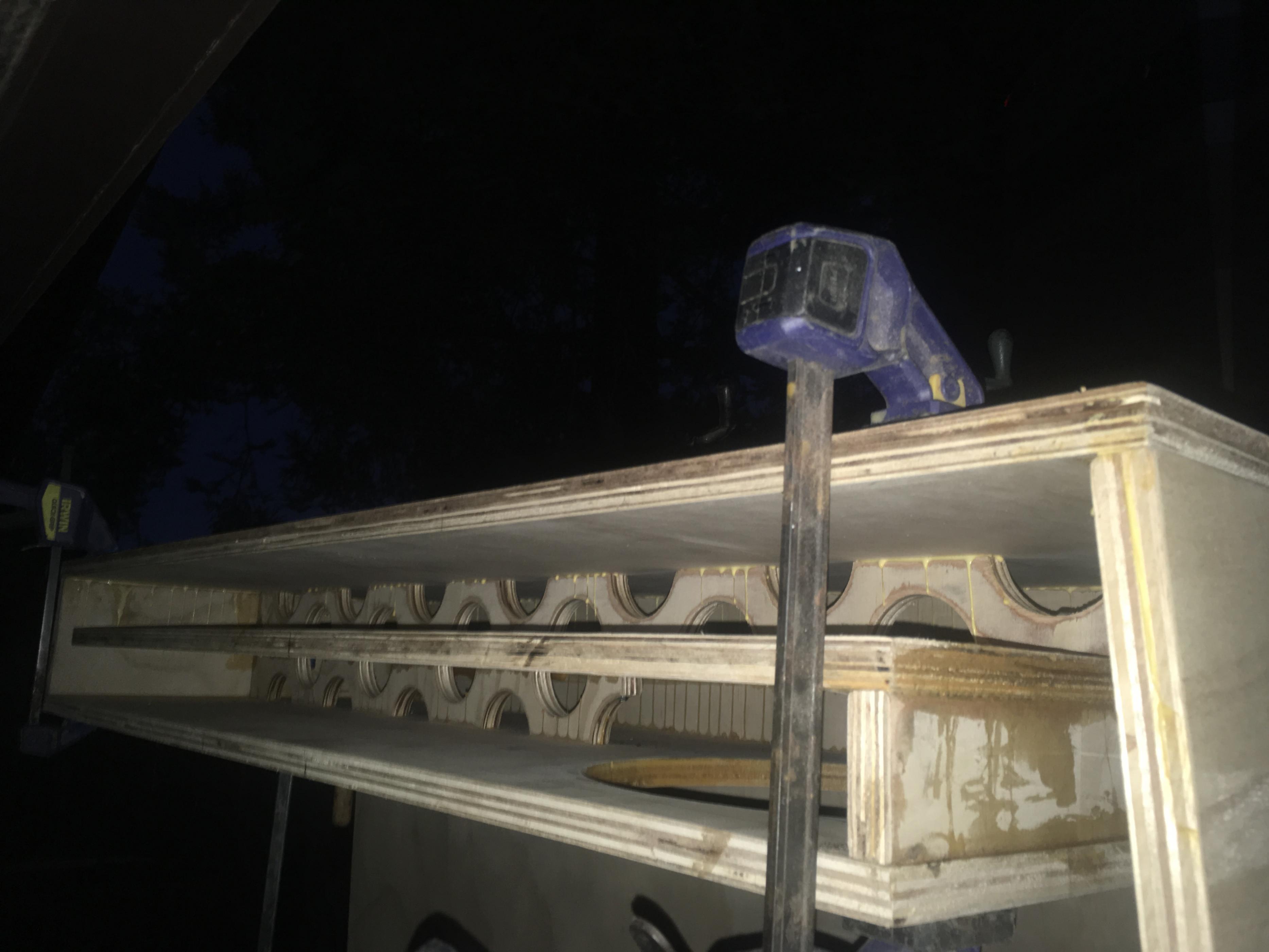

Made about 30 feet of this in a channel shape ~1x3 and tighter 1.5” holes spacing. 14 gage, kinda takes the structural into cosmetic more than otherwise, but the material was rusty (but free) so hard to complain. the 1” and 3” dimensions being opposite the ideal to be a rigid brace, but I’m probably being picky?

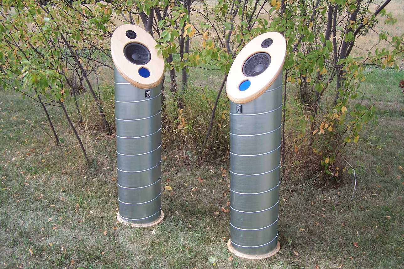

Yeah - cross-braking does something for thin, flat sheet metal panels, but it's a "cheap fix" at best. Much better inherent stiffness can be achieved by using curved surfaces: cylindrical, conical, etc. I've made some speaker enclosures incorporating surprisingly light-gauge spiral-rolled-seam galvanized steel air duct, and adequate damping of these was readily achievable. You probably have roll-forming capability, but for the purpose at hand, press-brake formed cylinders, cones, or transitions should be equally functional.

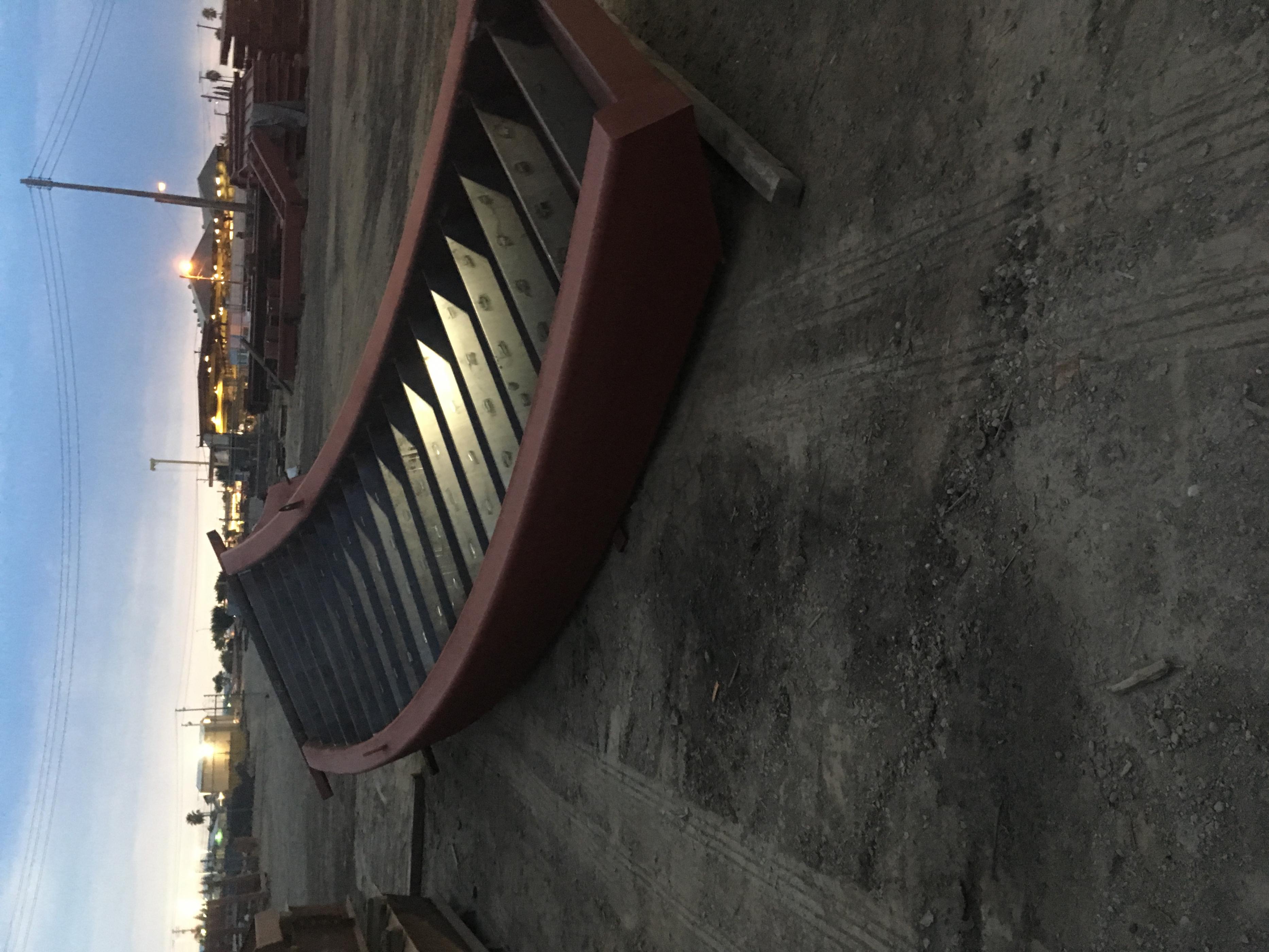

If Covid would stop interfering with a consistent steady work week.. this might be easy as I am free to ‘dumpster dive ‘ in the recycle bin’ for steeel and hospitals and stairs means lots and lots of pressbrake and 12-16 gage treads and landings! But the drops can be personal projects if not ‘greedy’ or abusing the idea. I have built a lot of things from old steel and scrap from my employer. Not any speakers though(about to change that I think ). Your duct idea is a great one. I have pvc and sonitubr

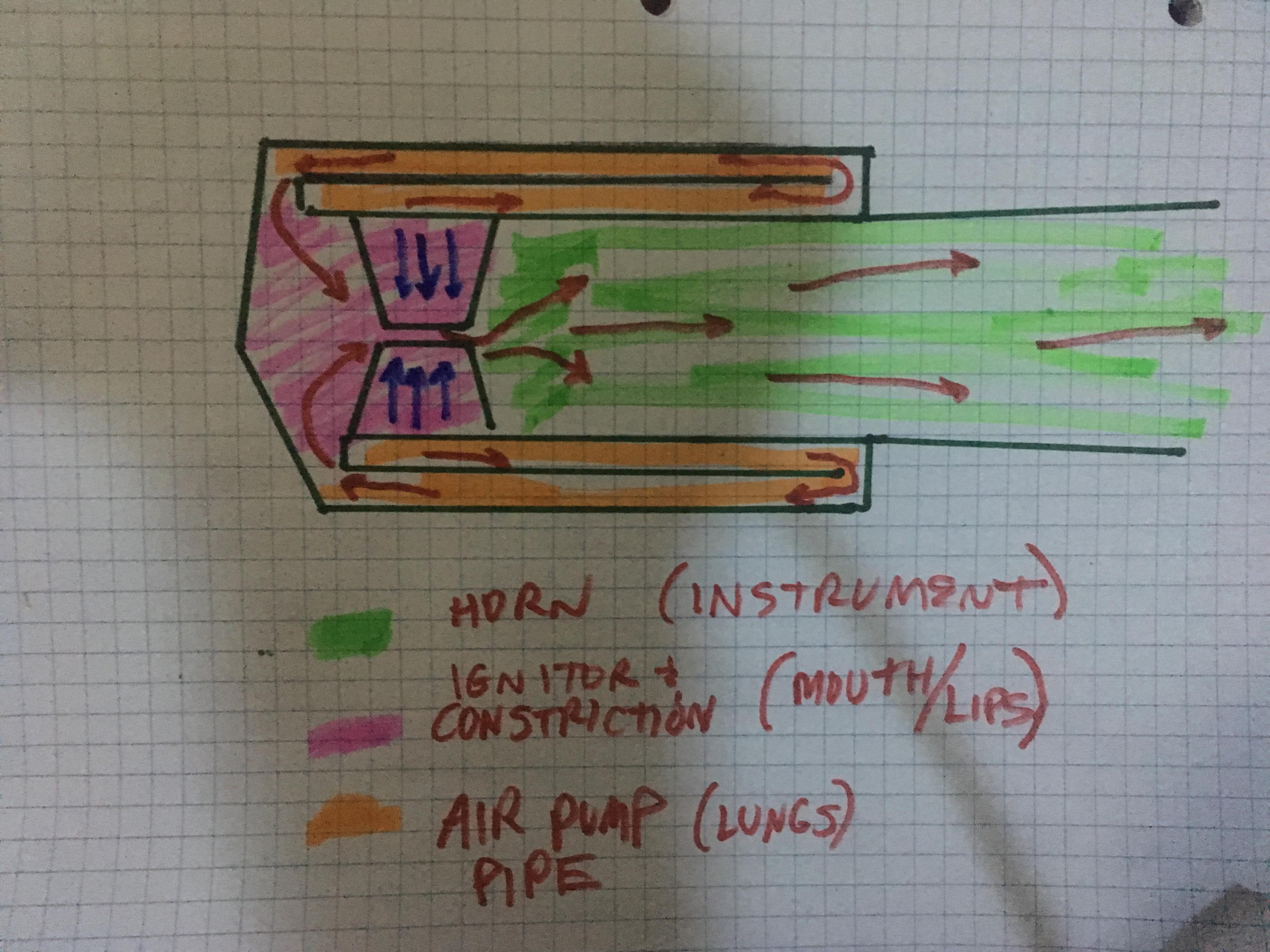

this might need to be shrimaged with a pair of tangband w5s. i dunno how far i can stretch the ferrous material in the 2.1 segment and lightweight or convenient enough? but i didnt anticipate the simple acceptance of steel sheetplate so much. this is kinda hard to not see what i can get goin? bit hyst for a crazy huge monster bass bin at work , but right here and now for myself shop or bedroom/office whatever..
might be an exocageand structure over plywood, or shared with
? anything i suppose. but i think this sounds funner than not, so ill try to come up with a few sketches
tangband w51138s paired up in a tapped qw pipe

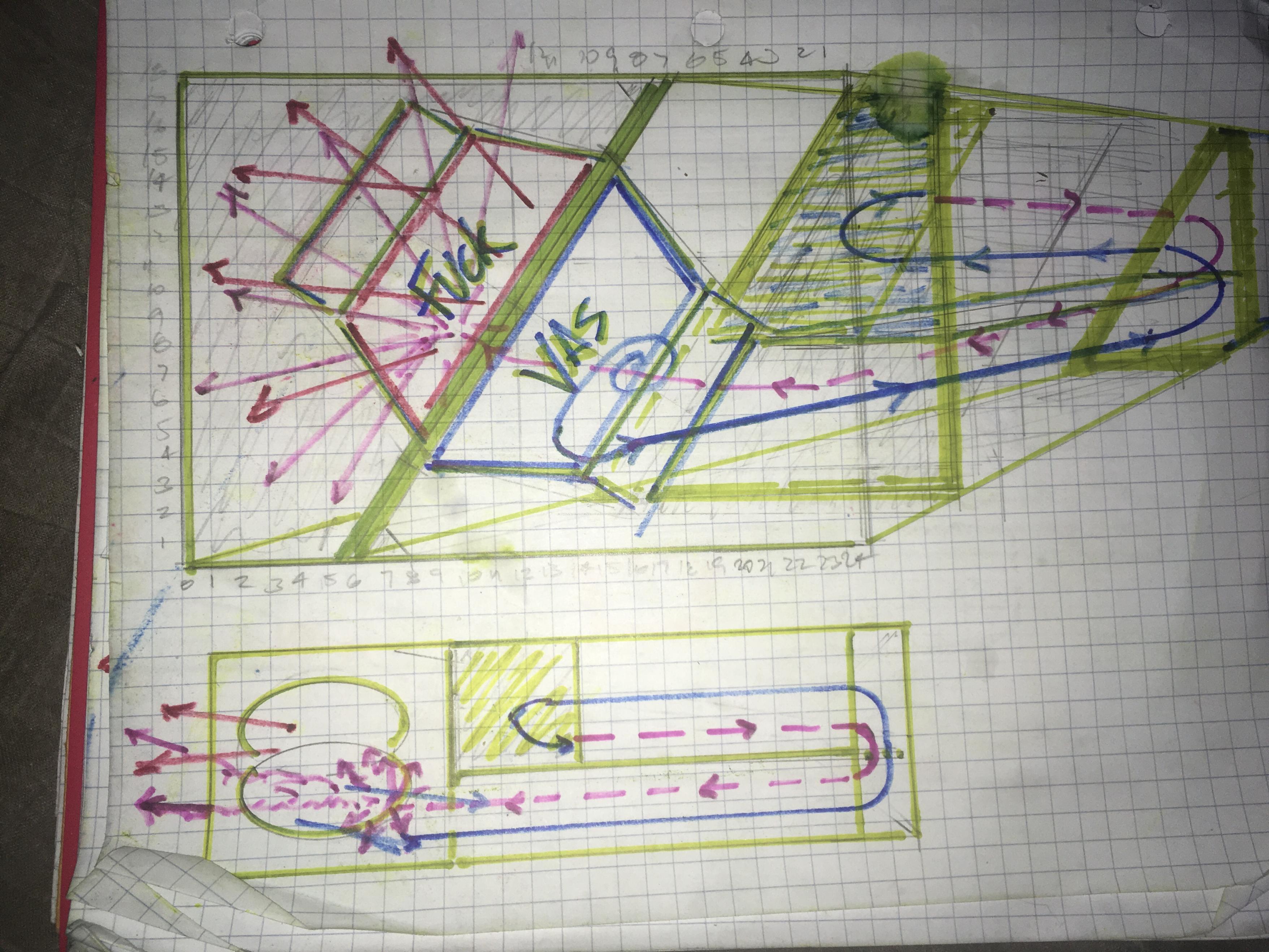

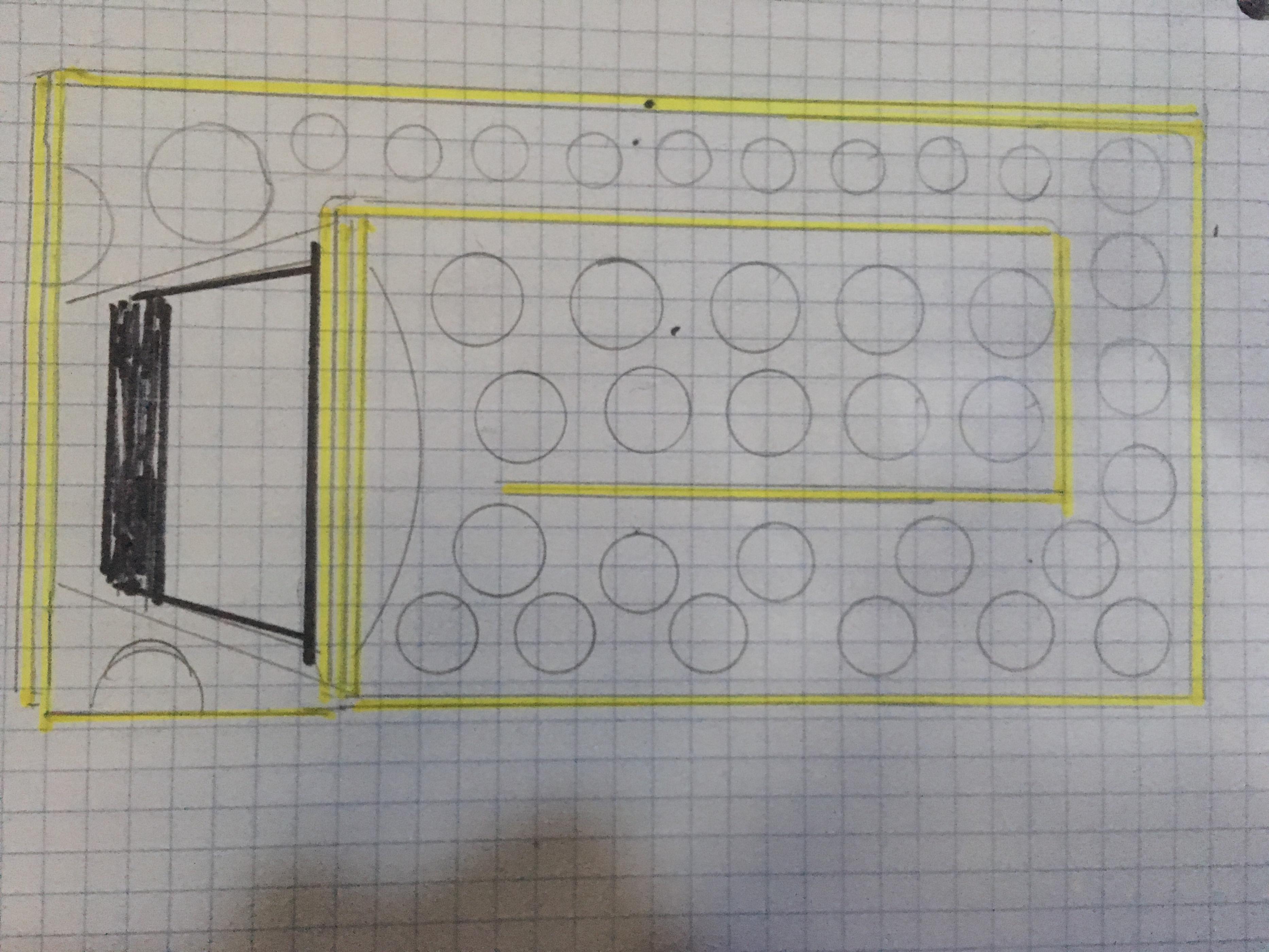

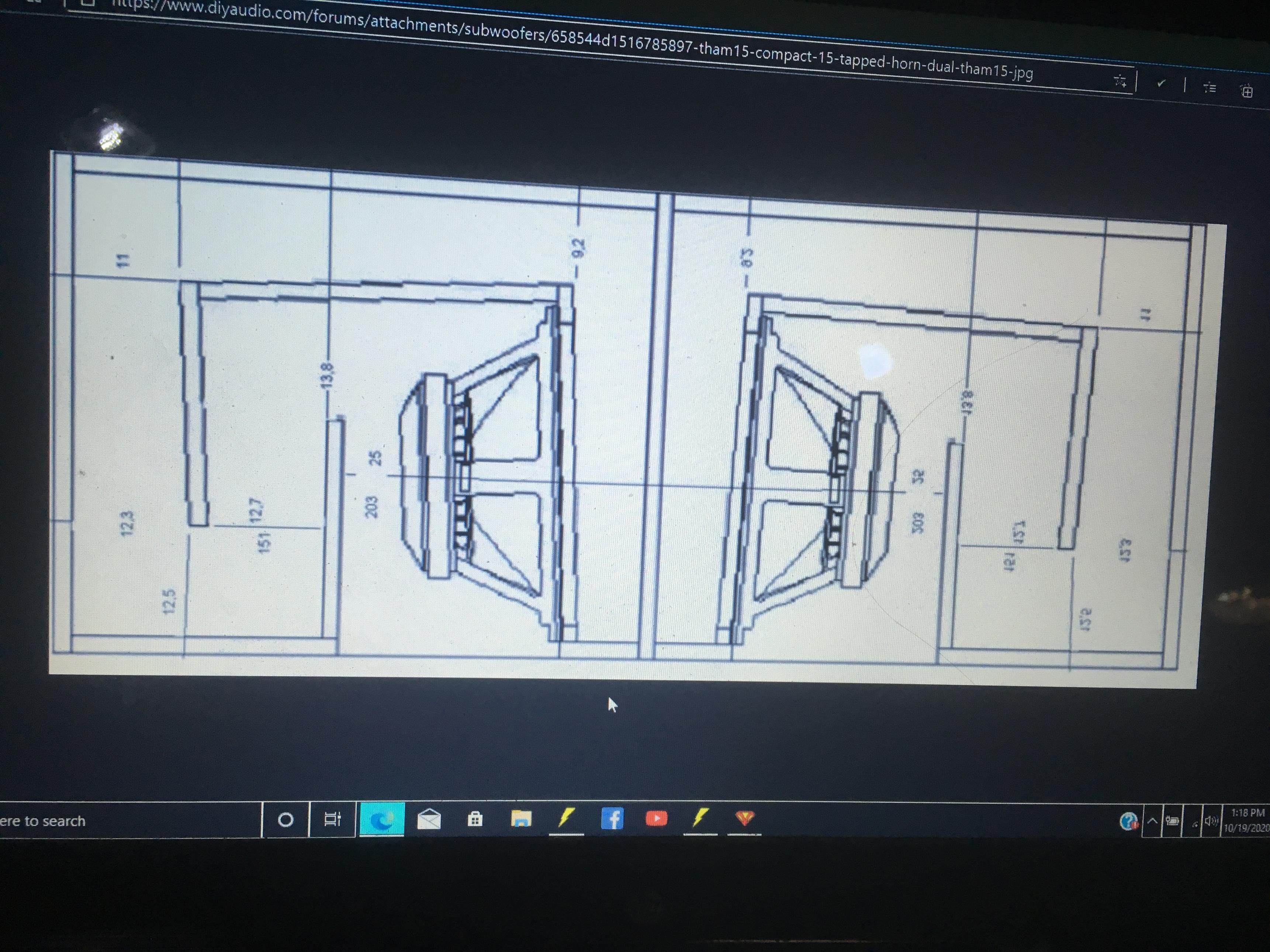

Better scenario if it became a choice in drivers I could get more going on but as a not nearly so LOW in a roar/tham/paraflex type of approach. I’m stuck to simming and obviously can’t just guess on ringing or panels resonances by design. but the next pic is bracing I do as wood normally.
As metal exocage instead? Blue is the closed end side of the isobaric bisected rectangle box shape, purple is the open sides path so that zigzag makes sense? There nothing drawn to show the other sides path or panels and both ends are fine if they match atb45 liters, and 250-300cm2 ‘port’ around 24hz tuning.
an existing restaurant trash can looking hideaway OSB/ plywood Covid time killer project that turned out to be kinda hilarious but in a good way?
