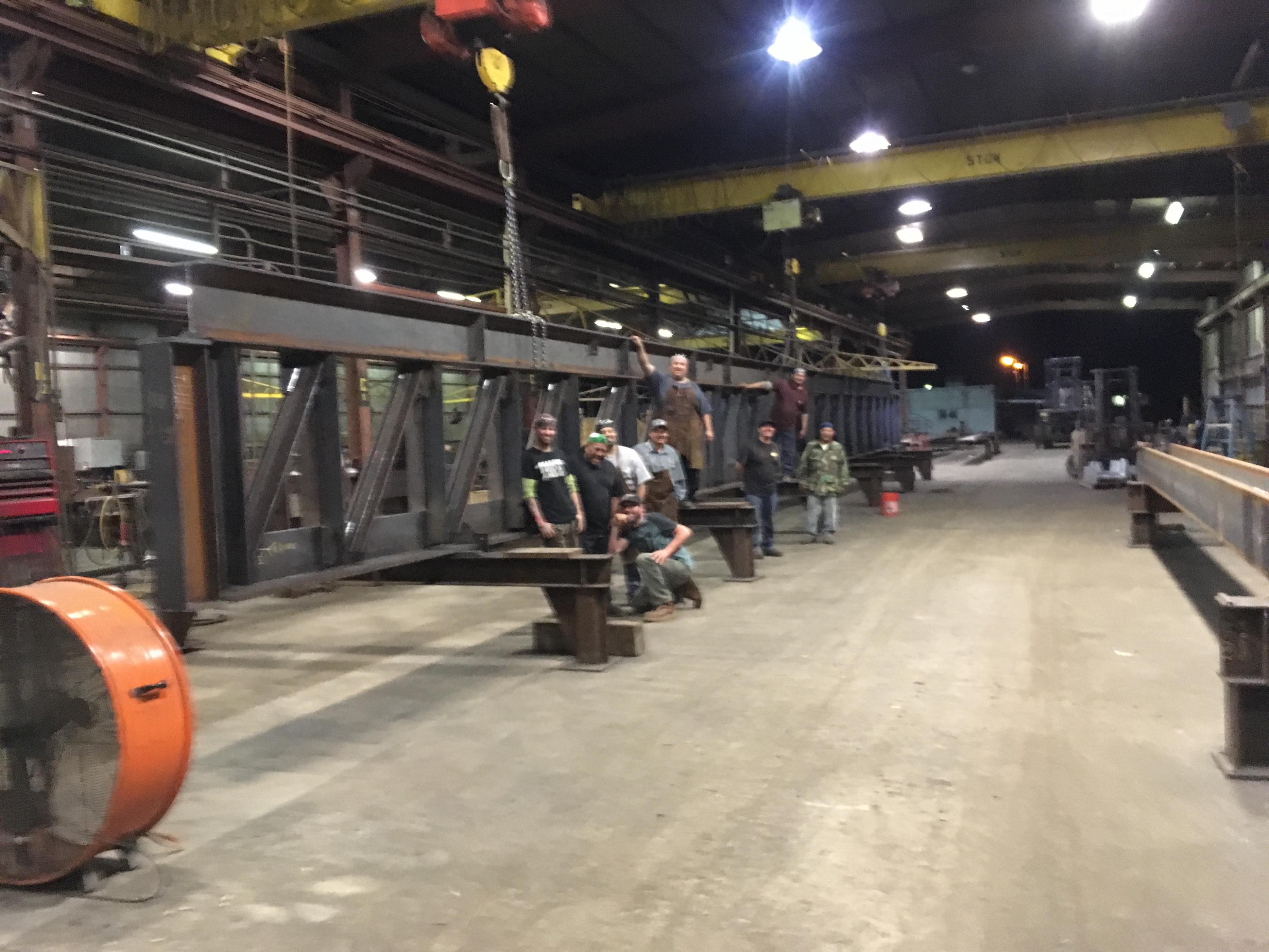

It’s easy, it’s cheap, it’s got lots of quarter path shape options and it’s my ‘day job’. except we are a swing shift from 4 pm-3am... and we listen to streamed WiFi or ancient PA overhead in the gigantic multi area open floor plan space and it’s a bit large to use a conventional ‘boombox’, so we might ‘grow’ and it’s a structural steel shop, so it can be built and heavy... forklift and steel is everywhere...
it’s a go if I can get the owner to okay it. she, only needs to see a drawing or anything and it’s most a sure thing as anyone above me is on board and have approved.
no $$ on her end. Only materials to make it are the deal. And with that I suspect it’ll fly. but is the idea stupid, or a waste of ‘novelty’? Steel in a steel shop is the fun factor and why it’s even considered or approved I’m betting.
The fabrication complexities are a welcome addition and even exposing any is fun as nobody really does’ speakers ’ Diy, but some musicians and Music hobbyists are coworkers..

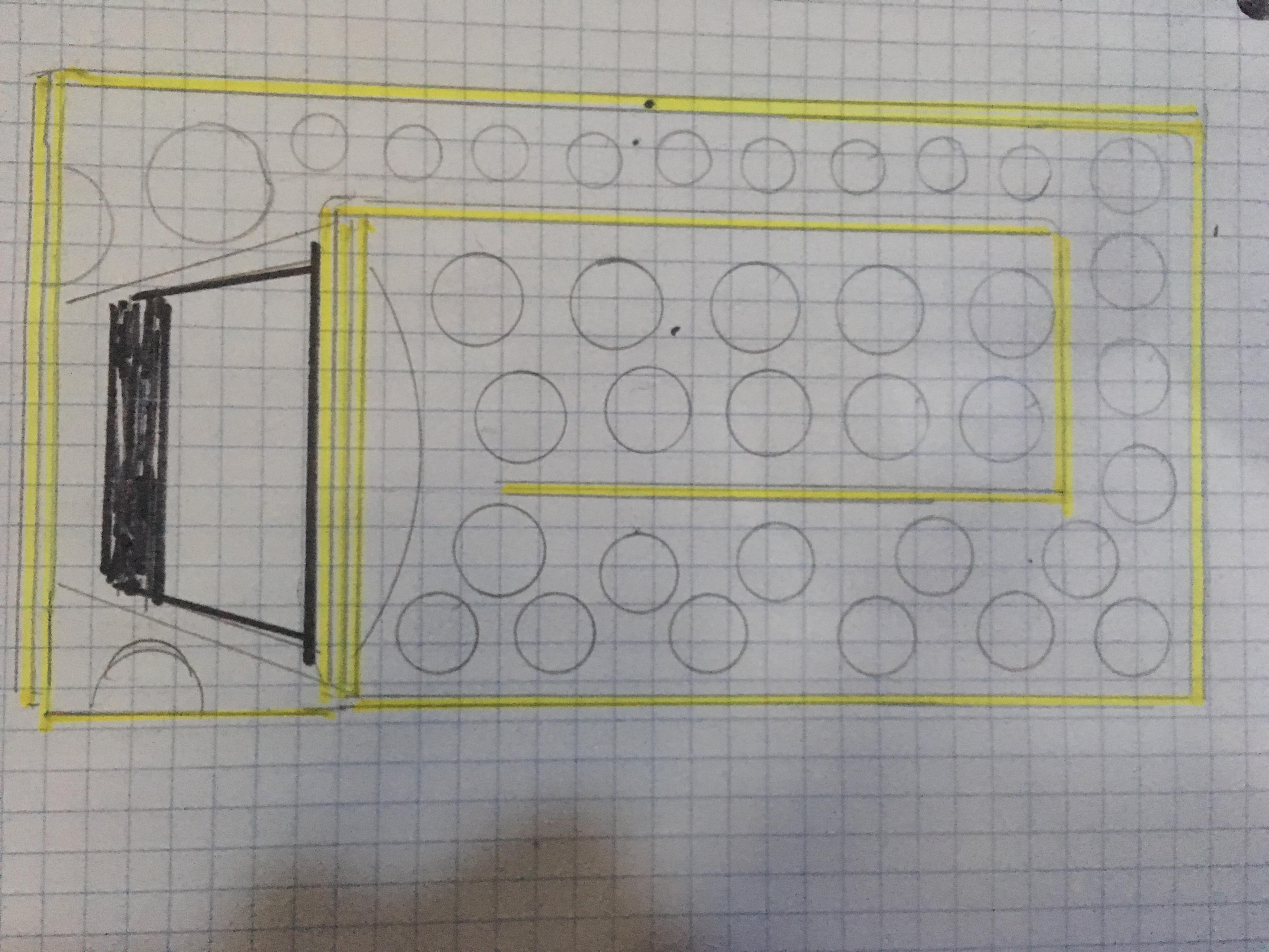

Most likely , 10-14 gage pressbroke and thus rigid with internal bracing and minimal volume losses and CSA in the path of a TL? Then, shot with a deadening ruberizrd compound like under coating for chassis? mayvevlined with pink Home Depot foam insulating boards, I don’t think I can use concrete brisk, lol. or id ask... and while I can use plywood in areas I really need to sell it by ‘steel’ to the owner or it’s Back to the boom box on overhead PA system 25 feet high thru the phone line to ... junk!And cannot hear much of it over the noise of production. It’s no good...it’s 45 years or older to and part of an old drive in theatre with part of some other stuff including back to 1954 when this shop started by ‘to the owners father.
Mild steel is possible? Weight doesn’t mater, nothing does, technically, except that I can create a proper ‘steel’ TL...?

I'd do something like a bunch of THAM15 or THAM18 tapped horn subwoofers. They have very good output for their size. In steel you'll need more top, back and bottom bracing. All structural resonances need to be an octave or more above the passband. Get a feel for what 300Hz sounds like, compare that with a knuckle wrap test on a steel span of the sort of dimensions you will find in the build. It shouldn't be too hard getting your structural resonances suitably high in frequency.

A few random ideas, but limited to wondering where to attack resonating junk and panel flex in steel sheet plate. Guesses on my end..
if I kiss the panels with a diagnol twice(X) in abrake, they quickly gain a rigid version of themselves by minimal plastic deformation. huge doors in hospital basements or heat/AC doors do this and a few concrete mold bent plate forms at rooflines.
the welding is actually a lot of internal stresses as it cools it will trap that which might have warped otherwise or can be an intentional part of creating even more stored and bound up energy, which can help(?)? Easier to avoid but if useful Is even easier too allow it?

What about double wall ( stayed like a loco fire box ), filled with sand. Your fabrication shop is just a bit bigger than ours, ha!, you're lucky you like the same music, we have several different " radios " playing at once, along with the din of hammers angle grinders 'n such.

id love to sneak sand in between walls but it might be abusing the materials and cut list?maybe layer of internal butyl roofing funk or mass loaded rubbery ? drywall, but it gets a bit messy..? but its a big silly metal box or two and a TL shape or tapped pipe or horn... it might need help inside beyond rigid and under a tension? polyfil, or synthetic is fine for that, wool obviously might be an insect or 100... but otherwise anything can be hidden or even ugly for sound in an ugly place, lol oi dont think anyone will care, because if it sounds good its all good?\!!

Do you do bead blasting? Bead blasting media might work. I can remember someone shoveling some old iron filings and he said they started to get a bit " warm ", I'm not sure if this would be a problem with steel.
Sand blasted to paint rarely, but shipped out and returned to finish galvanized. There’s solid steel drop and random a dead weight that might be available to tie into (sorta)? It’s not gonna be very likely if it gets too crazy or horribly ugly, though?
Pretty sure I can get the main panels front and behind the driver a space to fill with sand or similar? I’ll jyst make a note of that now, and consider it a plan.

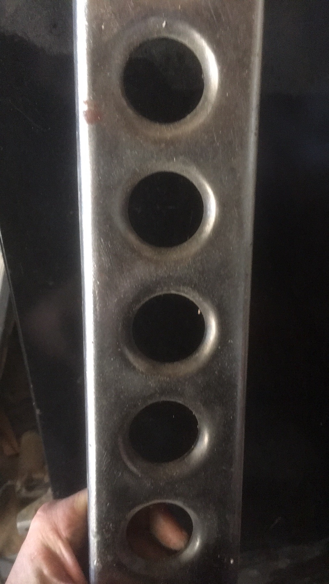

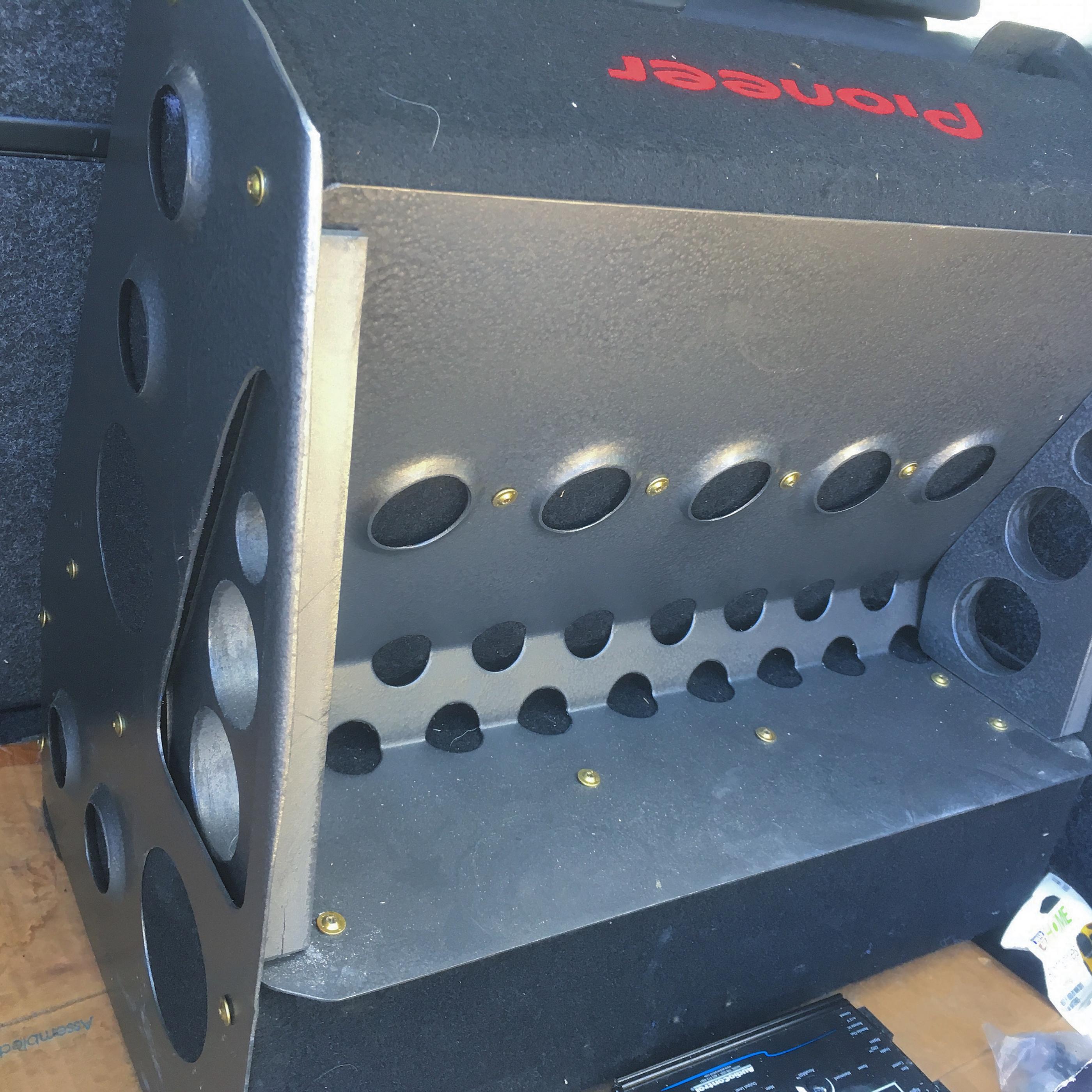

Made about 30 feet of this in a channel shape ~1x3 and tighter 1.5” holes spacing. 14 gage, kinda takes the structural into cosmetic more than otherwise, but the material was rusty (but free) so hard to complain. the 1” and 3” dimensions being opposite the ideal to be a rigid brace, but I’m probably being picky?
This as an exterior ‘cage’ or similar is kinda where I went with the ‘industrial’ theme suggestion. Kinda feels like it might work as an intentionally weathered look to wood plywood underneath that mimicked with a roughed up paint job with worn edges and corners? kinda makes me wanna use this in a ‘practice’ on my own personal subwoofer initially? I have an excuse to make new versions of current cabinets with a unique look and even tweak them in rebuilding the replacement. The rabbit hole of DIY is deep. I’m slipping again, lol!
