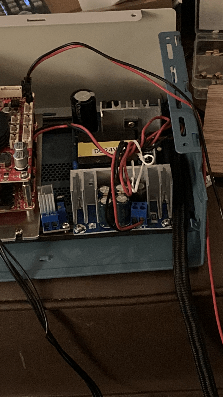

I will take a picture of it tomorrow when I’m at the shop. Everything is the same as in the picture I posted near the beginning of the thread with the Amazon supply but I’ll repost zoomed in.
I feed both amp boards off the 24v supply with both positives and both negatives screwed into it’s +/- output, parallel I believe. I’ve disconnected the line level, line out/line in that connects both boards to check for ground loops or something but no difference
My shop I use for my landscaping business has no 120v so I provide my own via a Ryobi 120v inverter that is powered by a 40v battery, it’s rated 300w. I also have a 1kw pure sine wave inverter in my truck that runs off a 12v lithium slave battery that receives its charge from the alternator and or solar panel mounted to my roof. I have this mobile setup to charge my cordless handheld equipment. The reason I mention this is maybe this setup is a particularly clean source of 120v considering it’s pure sine and powered from a likely dead silent lithium battery. Just a thought for a diagnostic test other than the Ryobi source. I could bring everything home and plug it in if necessary.

Just to try to help this as much as possible on my end without too much of me having to go back and forth with suggestions, I can take a rew measurement with calibrated mic to show the specific noise frequencies if that might help narrow down the issue. It would be much easier for me to take a measurement with my iPhone audiotools app but whatever you guys want. I could upload a video of the noise also probably. I can take whatever measurements with my basic voltmeter too.

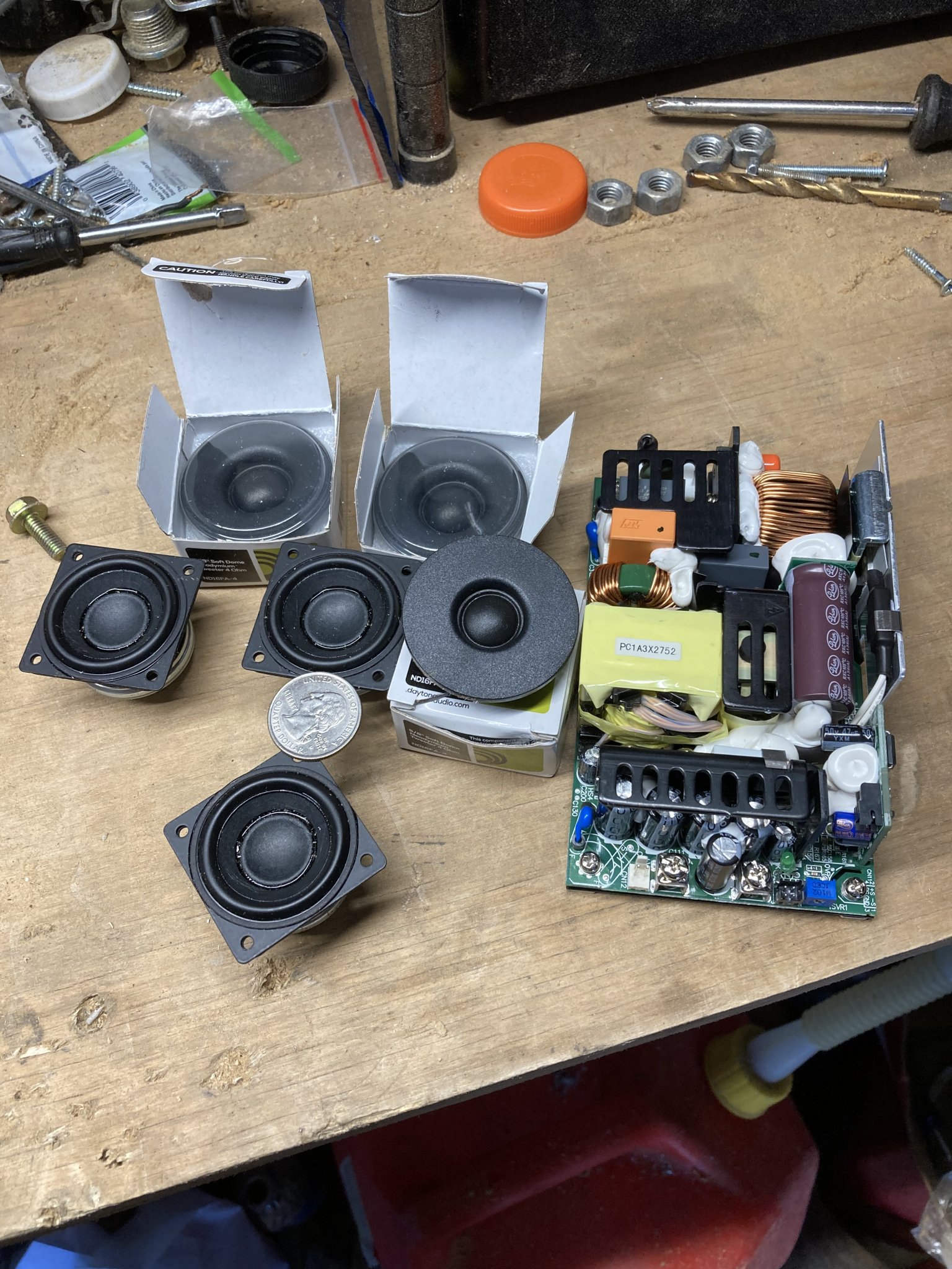

I've used mean well smps in noise sensitive circuit and I'm very happy with it. And they seem they are made to last.
I was puzzled searching for a psu for a class D amp. Mostly they fall in two categories: active or passive PFC. My gathering is that the difference is about EMI compliance with international standards. There is an awkward situation. Active PFC is approved but hard to get. Mouser for example won't ship this type to EU. The passive version is easier to get and for half the money, but it's not supposed for domestic appliances. They are allowed for LED lights and industrial use for high power where active PFC apparently doesn't fit. So, here is my question: am I illegal if I get a cheap 20A passive PFC type for my amp?
Interesting to know they feel good with load lower than their full capacity. I always was wondering about that.the key to using worry free smps is to get a unit that has way more capacity that what your applications required, that has been my rile of thumb since...

I got the 24v ~500w mean well unit. It’s a nice supply for my needs except I’m not quite sure I’m getting 110rms from my wondom 160x2 board. It might be in my head but the amplifier is rated up to ~40v input. I definitely have enough amperage at what’s listed as sufficient input voltage, just can’t shake the suspicion I’m leaving something on the table.
