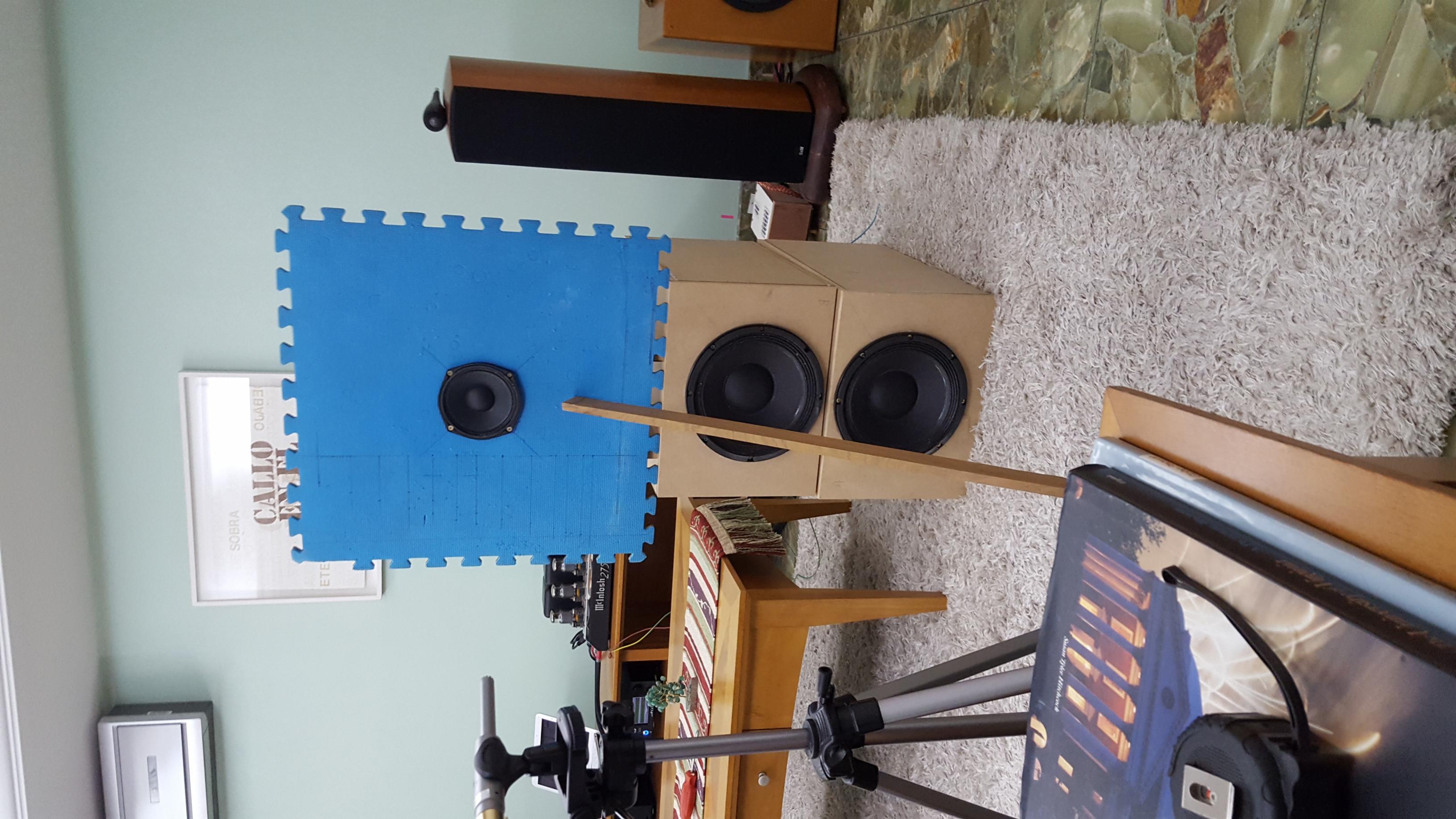

Have you measured the response of said driver on a large flat baffle, outdoors ?
(I ask, because this way you can have a base-line performance reference)
I haven't. Was taking the factory curves as good. I can probably do that next weekend.
How large a baffle would be good enough?
Driver pointing horizontally, such that the floor bounce is still there despite the grass cover?

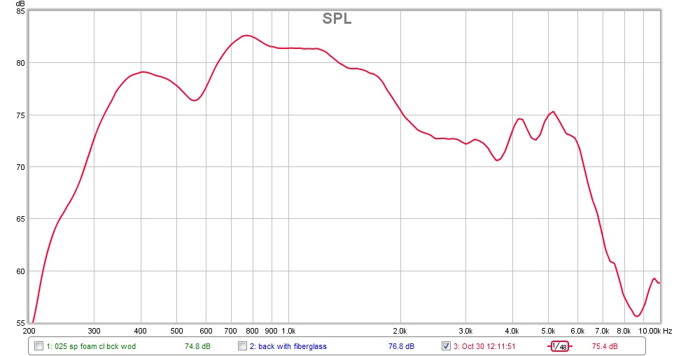

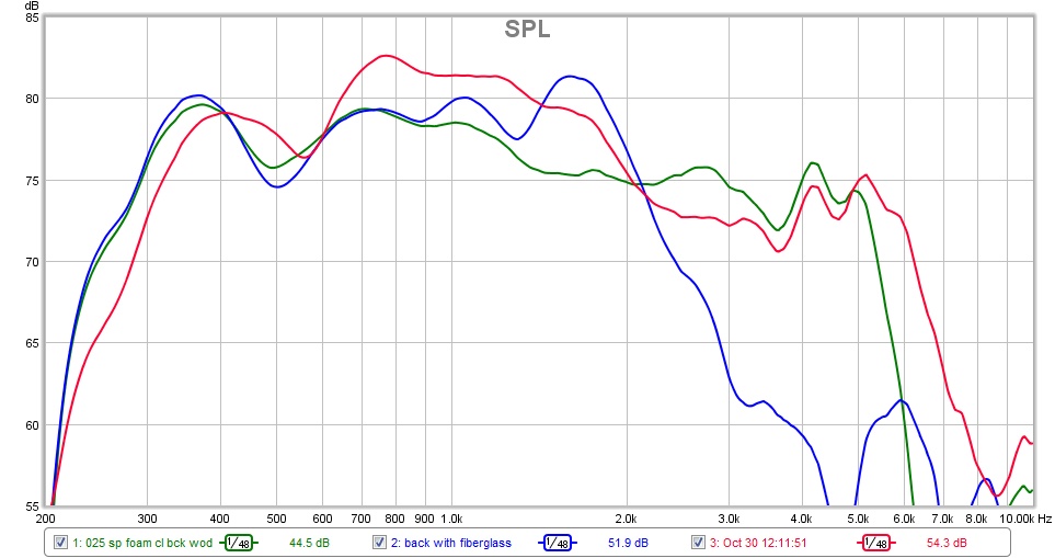

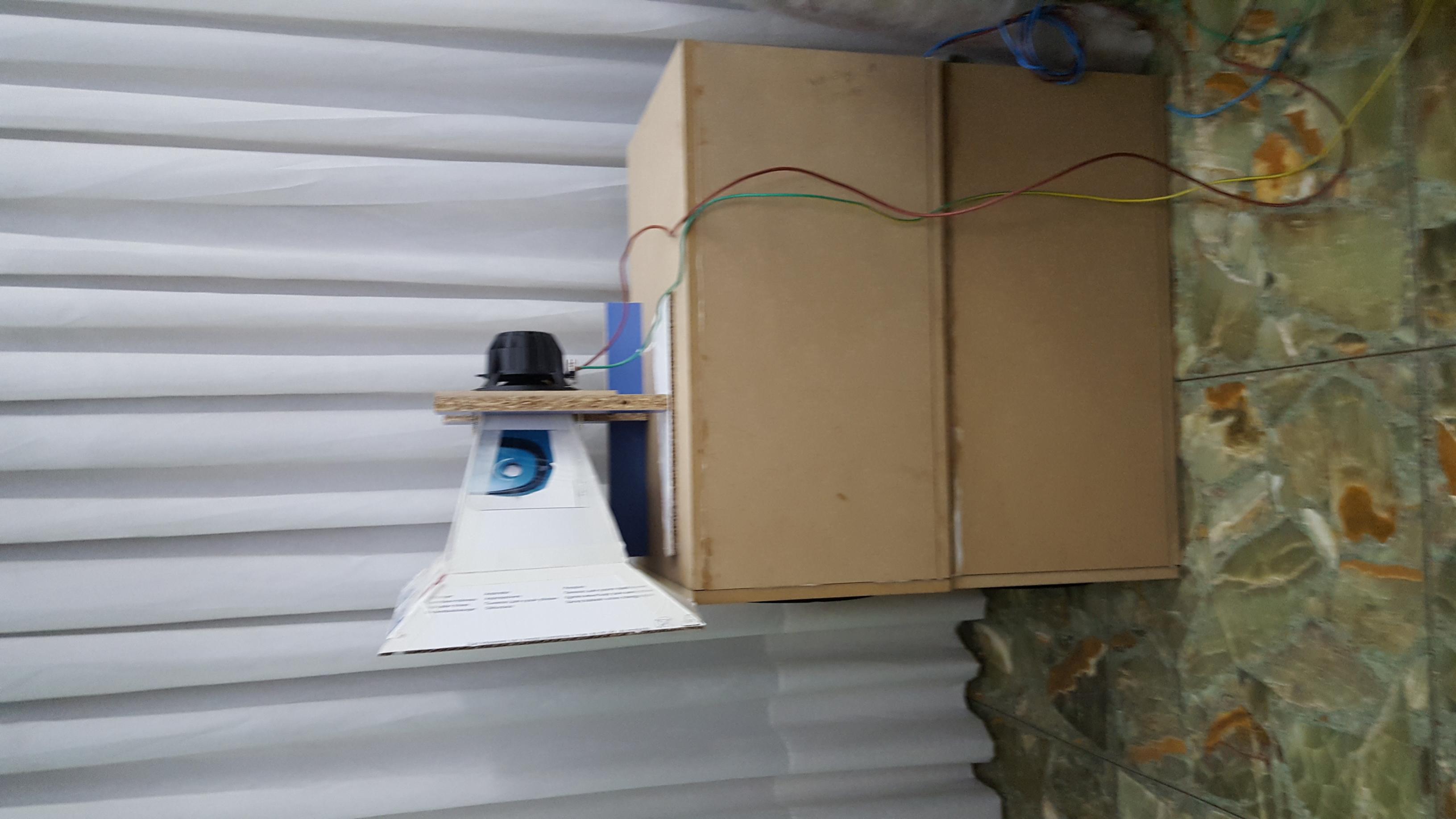

4th prototype: dual expansion conical
I used bwaslo's spreadsheet to come up with a conical dual expansion horn. No, it's not a Phillips horn...it's a horn made of the cardboard of a Phillips appliance 🙂
Since the tractrix prototypes didn't really load the bottom end as expected and since conical horns are known for their directivity properties, I tried this quick and easy.
What do you think?
The first SPL chart shows this prototype in red, the 2nd proto with closed back (green), and the 2nd proto with closed back and dustcap on (blue). Second chart is this horn only, taken with FDW=5 cycles.
Seems the horn would be usable with 2kHz steep xo (active), right? And I wouldn't loose much on the low end, maybe xo at 400Hz. I think I should close the back and see how that affects the dip at 550-600Hz.
Next I would build an MDF version.
Feedback more than welcome! In fact, desired 😀

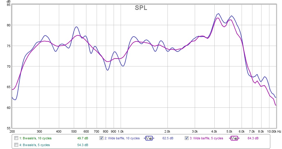

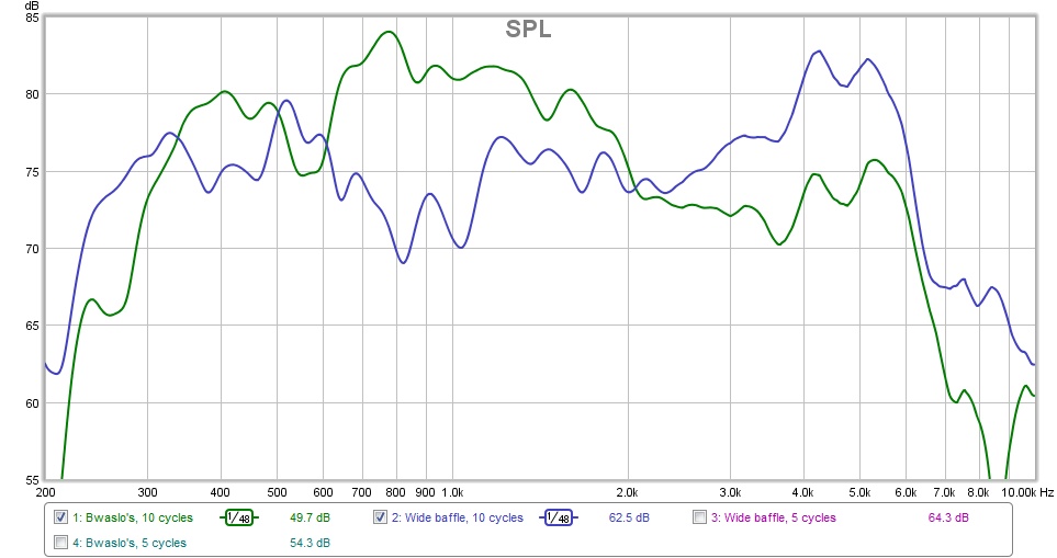

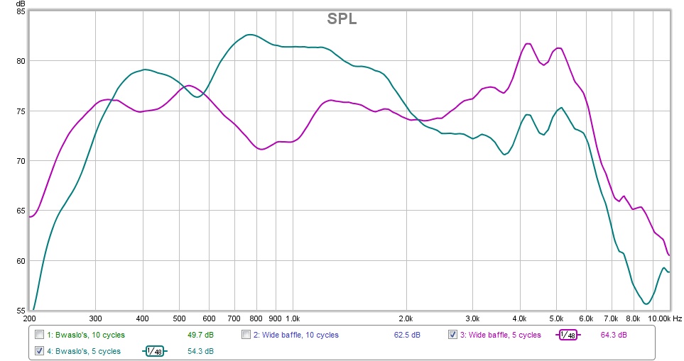

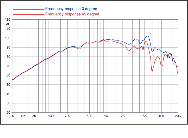

Scott,
You are right, I had forgotten to do that. Did it today, quick and dirty, but I believe it's telling enough.
Attaching: manufacturer's response, my driver on the wide baffle at FDW=5 and 10 cycles, wide baffle vs Bwaslo's horn at 5 and 10 cycles FDW.
The dip doesn't appear to be there. Seems to be a horn artifact, doesn't it?
Standing Wave Modes
Suspect several are combining to give such a broad response notch. These arise due to Mouth Reflectance, and Transvers Modes occurring in horn body, back and front chambers. Methods to mitigate these are well known.
Horn Mouth generating intense back waves, increase mouth size and round-over any diffraction edges.
Intense Transverse Waves
1) in horn body, nix diffraction slots and parallel sides
2) in back box , diversify the modes, use a three sided pyramid or similar
3) in front chamber, set phase-plug annuli a mode nodes al la Bob Smith.

Thanks for the input.
I will build an MDF prototype and experiment with the round overs at the mouth. I guess the midbass section front panel at the bottom is acting as such. Will experiment on the sides. The top is most challenging given the need to keep the TPL-150H as close as possible to minimize c-to-c concerns.
No parallel sides in the horn body as it is a rectangular conical and 4 walls are angled. No diffraction slots.
The measured horn above does not have any rear chamber, so I guess this is not another issue adding to this mix. I do have a triangular section back chamber I can experiment with, though.
For the time being I won't introduce a phase plug.

Scott,
I'm sorry, I guess I am just too much "old school" to follow these. Is it possible for you to post JUST the curve of the raw driver ? Also, I don't know the terms
5 and 10 cycles FDW (????)
Scott,
On post #250, it's the second graph (the one with a blue and a purple line, with the legend showing "wide baffle, 10 cycles" and "wide baffle 5 cycles").
FDW means frequency dependant windowing. It's a parameter you set in REW (the measurement software), so at lower frequencies the "window" in which the measuring mic is "open" is longer than at higher frequencies. Longer windows allow more reflections to be recorded as measurement, which is especially misleading at higher frequencies. So FDW is a means to reduce this effect. By the same token, reducing the window also reduces the "definition", so it's a balancing act. Hence I measure both.

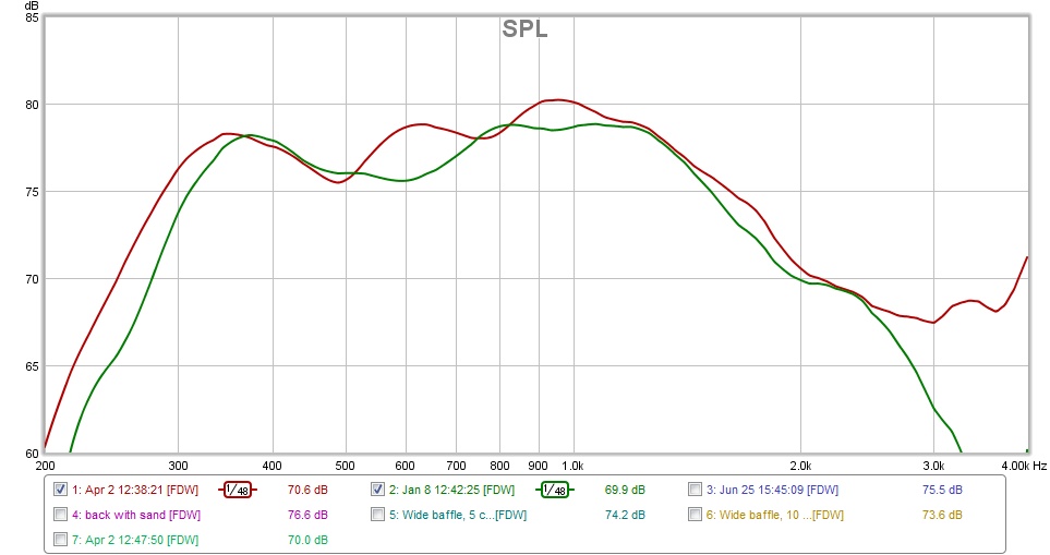

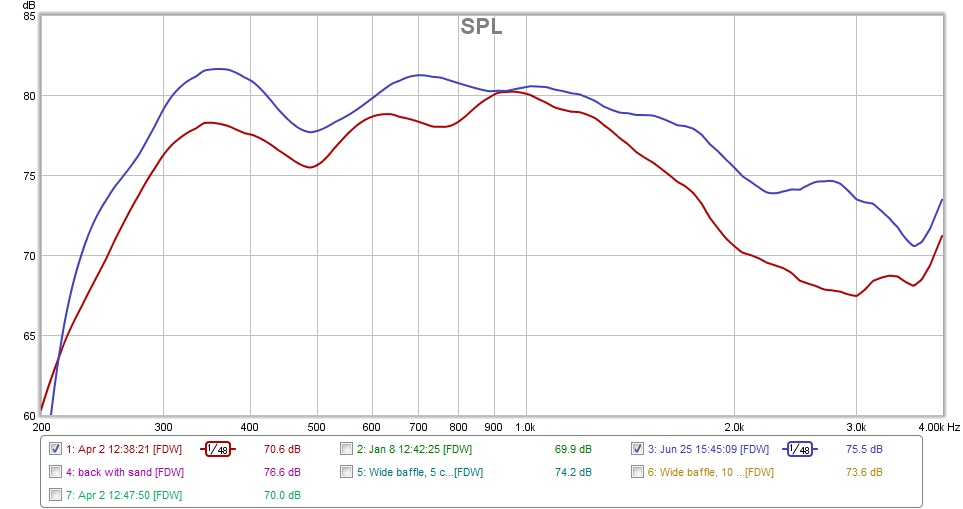

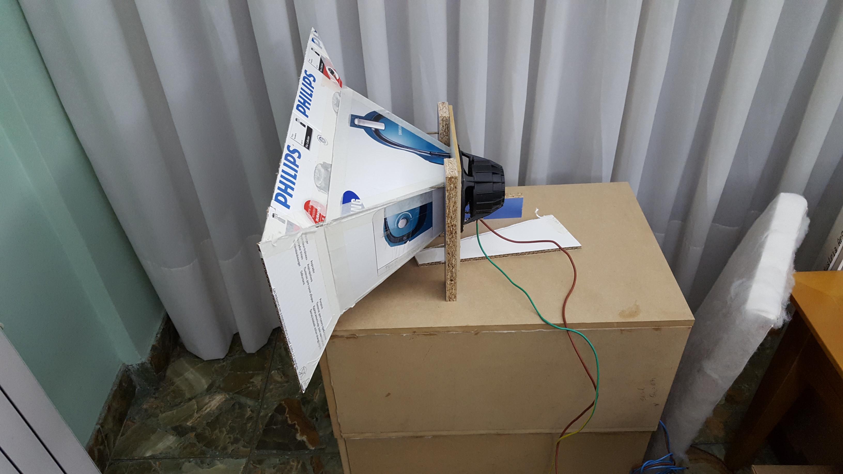

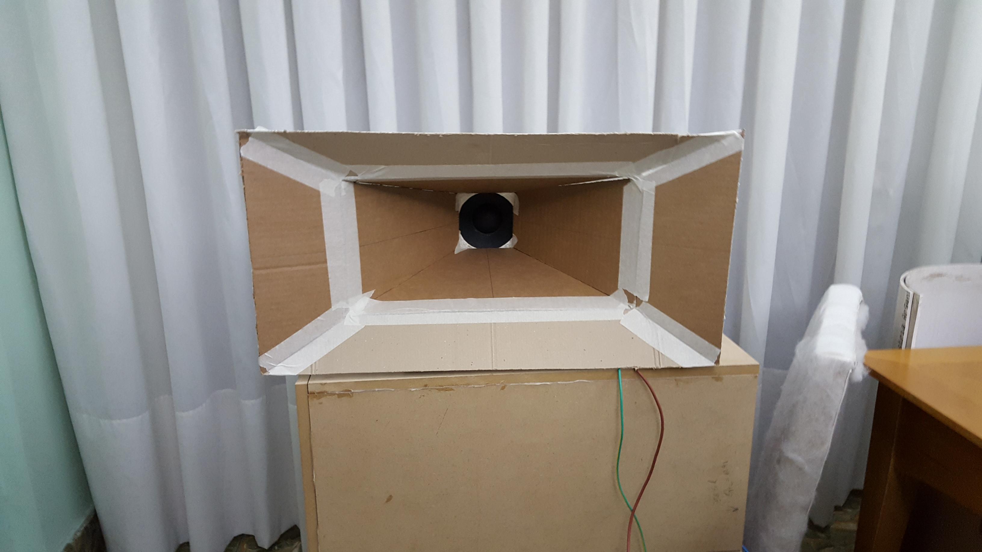

Update: conical double expansion
I've been having very little time to spend on the horns, but got around to assembling a conical dual expansion per bwaslo's spreadsheet and tried with two different openings in the mounting flange.
The horn is 60cm wide x 30cm high x 25cm long. The smallest part of the horn is 9 x 9cm, while flange 1 has a 7.5cm round opening and flange 2 has a 9cm square opening. The driver is a 5" (12.5cm).
First graph shows measurements for both, open back driver, FDW 5 cycles. Red line is large throat 9x9, green is smaller 7.5cm diameter. The larger reaches further on both ends. In fact this horn seems to go deeper than I need so maybe I can make it a bit smaller for improved WAF.
BTW, how do I insert an image inline here? 😱
Second graph is the same above 9x9 opening vs. my 2nd prototype (Tractrix Edgar-style 50cm wide x 35 tall x 31 long). Unfortunately the measurements weren't made at the same SPL level, but it seems the conical dual expansion has a less severe dip around 480Hz and reaches higher. The tractrix has a larger throat.
I'm thinking of sticking with the conical dual expansion, but maybe 5cm narrower and with a larger throat, maybe 10x10.
Opinions?
