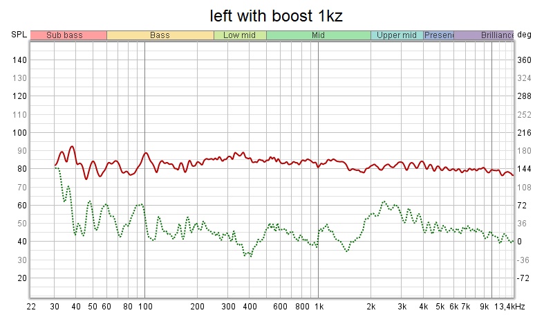

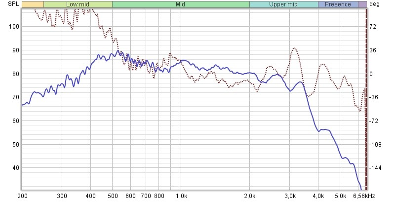

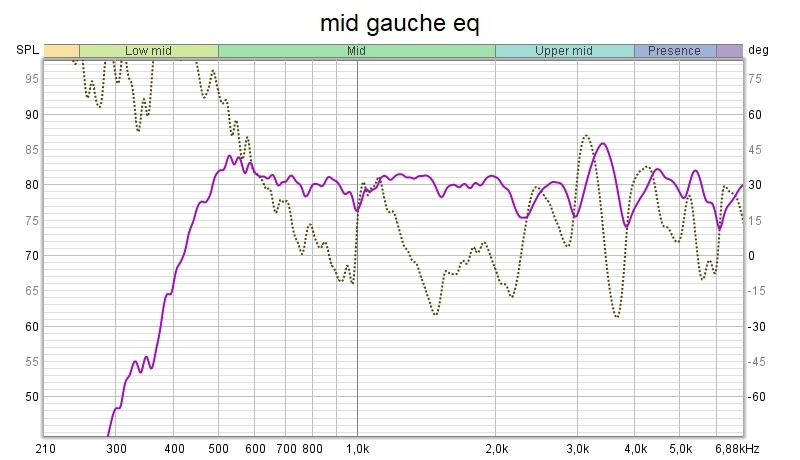

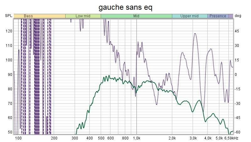

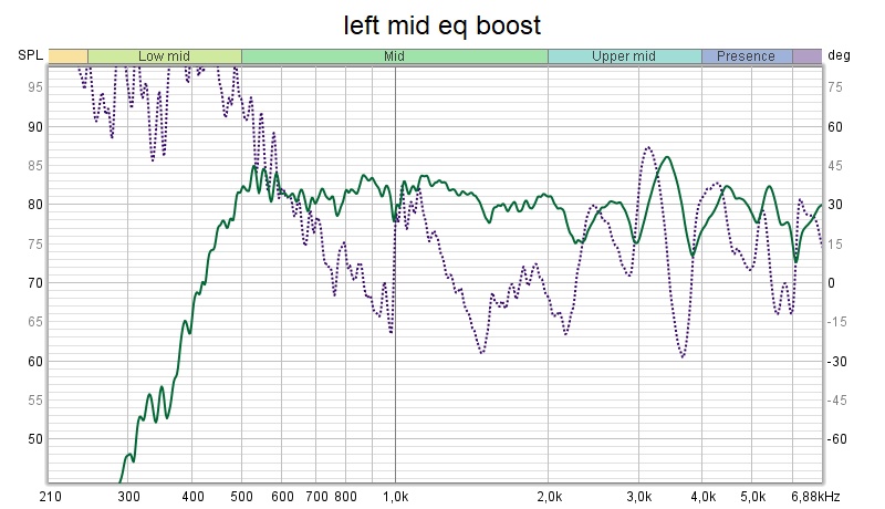

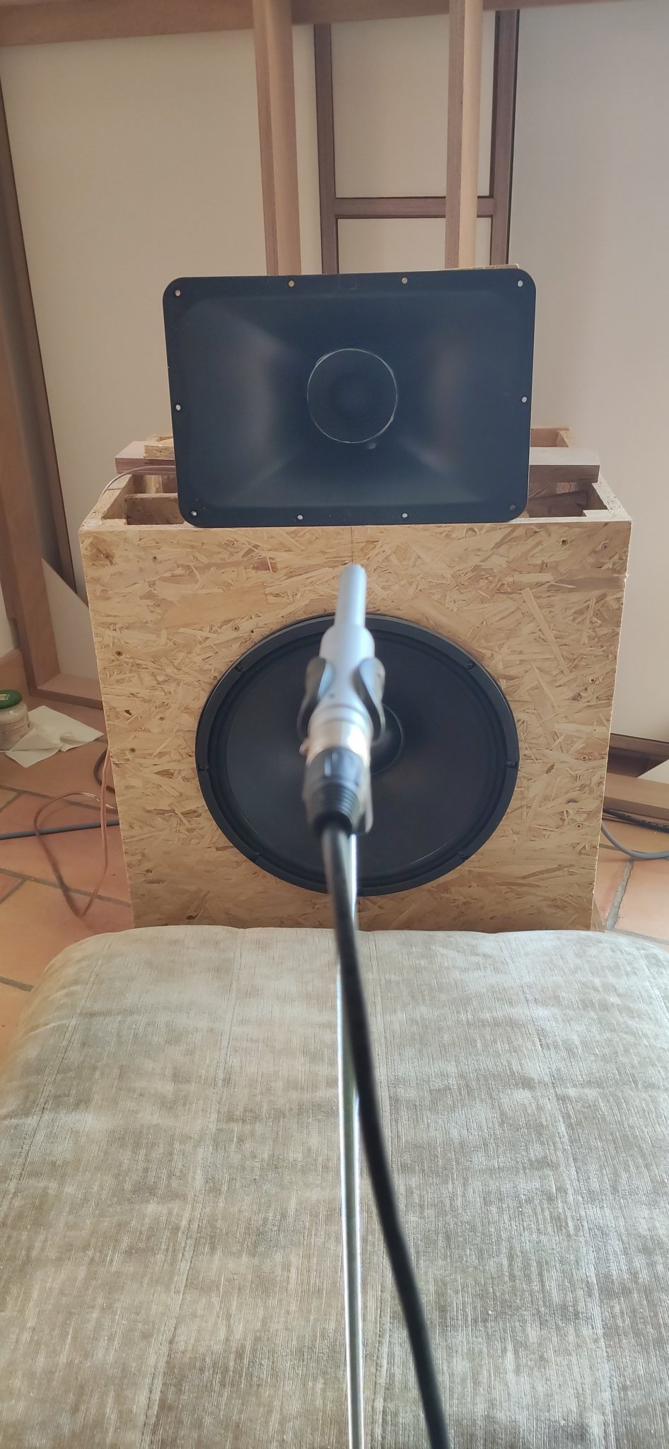

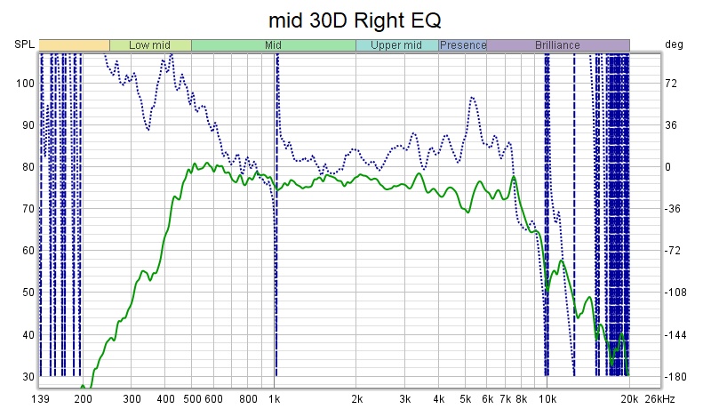

Hello,
I will be updating this thread instead of creating a new one.

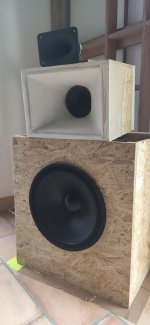

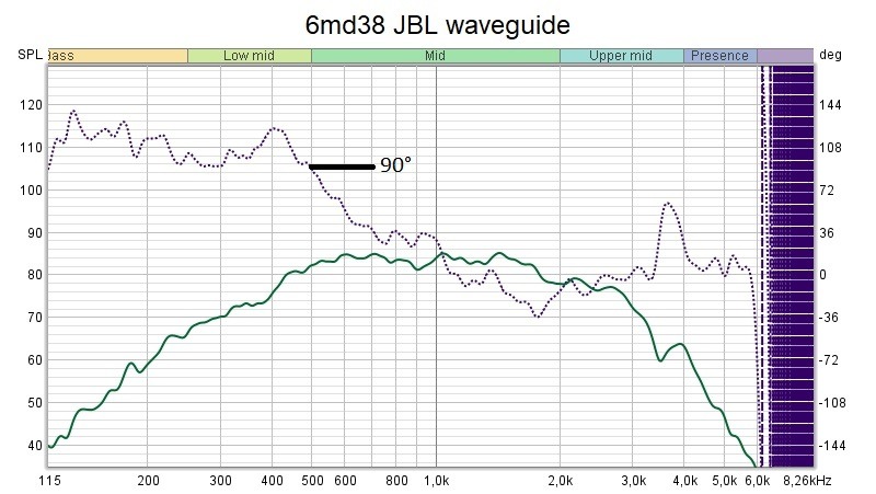

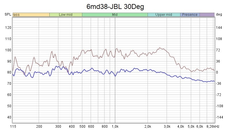

Inspired by JBL midrange waveguides I am designing my own waveguides.
Here is a first shot. What I did is that I did a first expansion at 60*30° and a second expansion at 90*45°. Then I plastered and smoothed everything.
I have some boost in the lower frequencies around 400-500hz and I have an accident around 1 khz.
What is good is that I can measure phase shifting around 500hz which might be theoretical.
I would like to design a bigger 60cm wide waveguide. I am not doing it for the gain but to avoid throwing energy to the room.
Should I go with a basic 90*50° square cone and then smoothen a little bit ?
Or try to approximate tractrix ou JMLC ?
Do you have explanation for the 1khz accident ?
Do you think using damping material at the mouth is a good idea ?

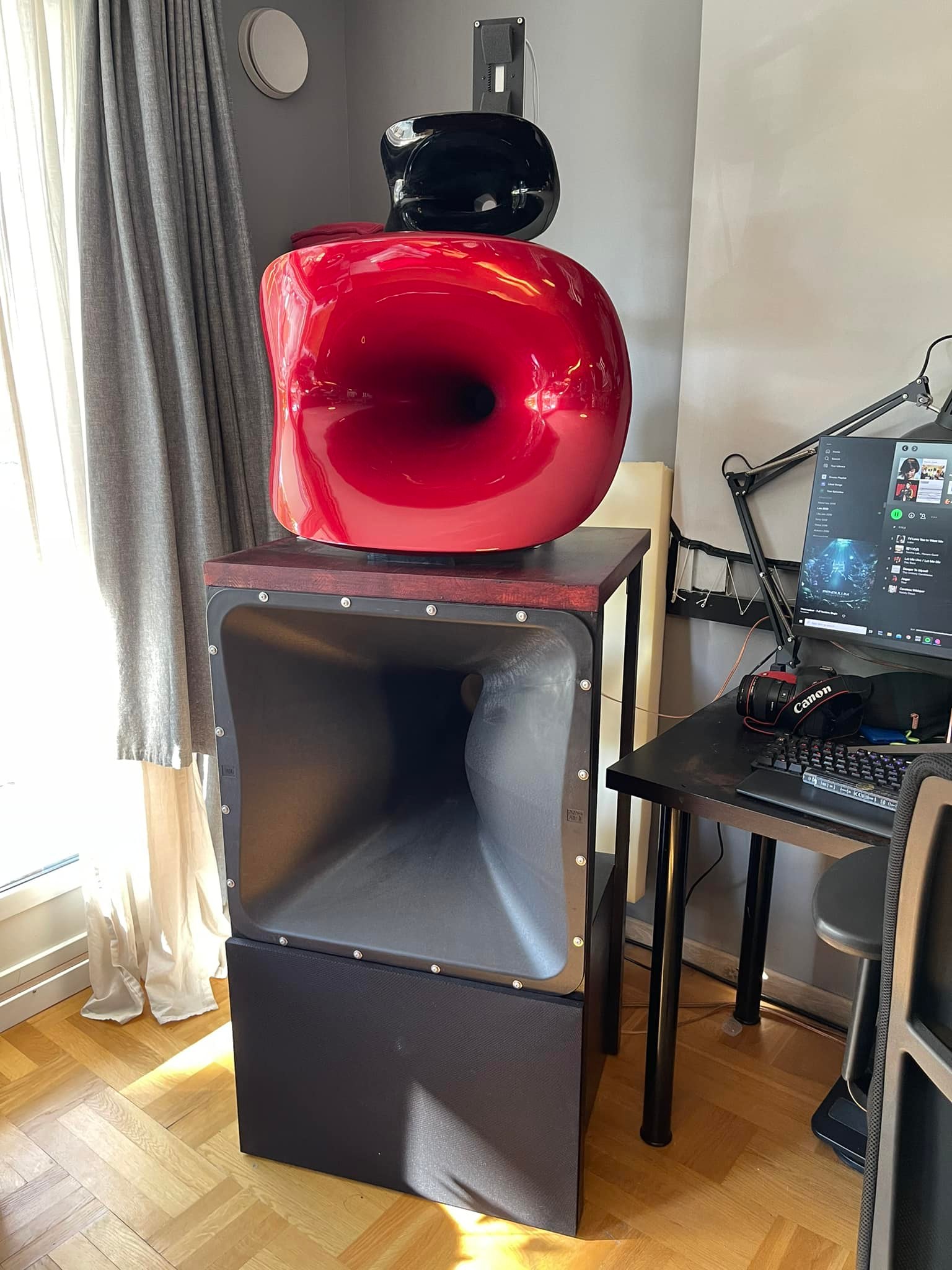

10cm diameter mouth is good. This somewhat shallow depth horn goes deep in the midrange without being so honky like a really deep horn would be when using a compression driver. I have been successful to push a JA6681B down to 270Hz. Super detailed, but not a relaxed sound. I think I was missing some other details.
