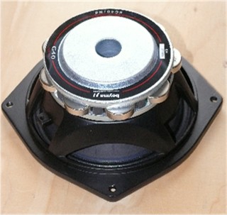

Yes Tinitus the Beyma is certainly a professional driver. Ma ny audiophiles tend to think that pro equipment is only about loud and there is a lot of cheap "pro units" around that are lousy. High quality professional equipment to the contrary is designed for users that work with music and their demands are just as stringent as the most serious audiophiles. This little gem actually is a beautifull hifi low/mid driver and very reasonably priced although produced in Europe with real high class finish.
Hmm.. I must say that this Beyma unit looks very interesting..... What's the typical price range for these units?
I dont like the design with all those small neo disc magnets...from a technical wiev its tricky to get equal contact surface to the pole plates...it looks like quality, but is in reality cheapish technology
driver could still be good though 🙂 might benefit from a bit of coating 😉
Impedance looks impressive, very smooth
Don´t have the exact price here, í´m not at work, it is in the vicinity of 70 euro in Sweden. Yes the design with neodiscs sets demands on precision, in my experience Beyma meets this challenge with very high repeatabillity, i´ve used a lot of their drivers and so far only replaced two hf drivers exposed to a clipping old Luxman amp.

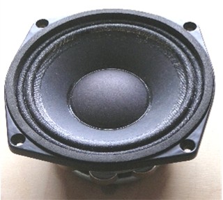

In short: yes. If you are really set on the Seas DXT, you shouldn't cross lower than 2,5-3kHz to maintain diretional control. Then an 8" becomes slightly too big, and you should look at 6" units. (Although I personally would consider a bigger waveguide on the tweeter and a lagrer mid driver. But that's only my opinion).
I have no personal experience on the Beyma or B&C units mentoned, though they look good on paper.
IMO, one of the best 6" units for your application is the Audax PR17MO. Do a forum search on that one. Lots of good info will come up. Is has been discontinued, but I think Madisound still sells them. Another good one, is the RCF L8S800.
Check out prices etc at http://www.speakerstore.nl/. They also have the Beyma 6G40ND.
