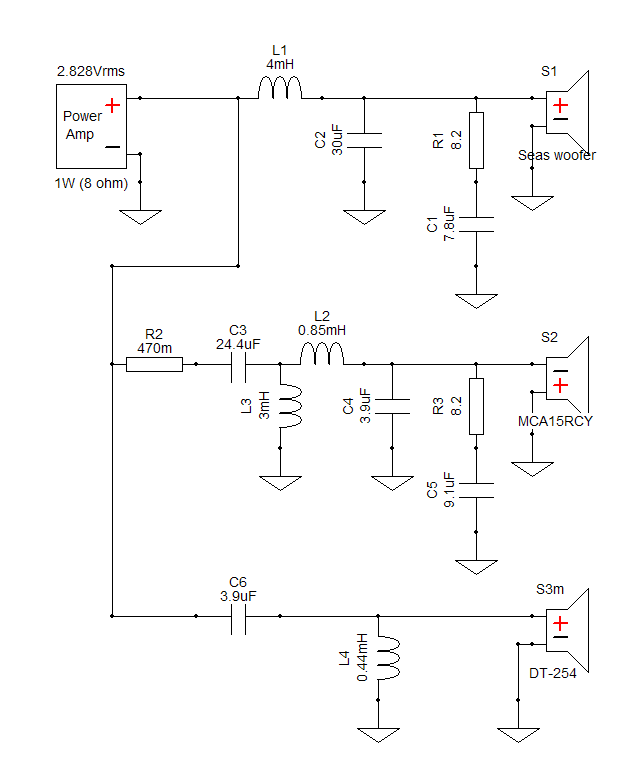

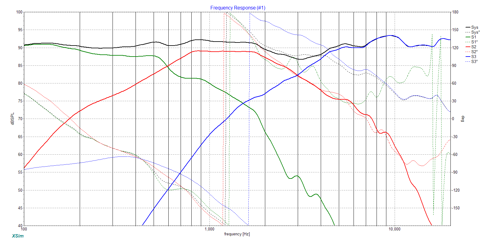

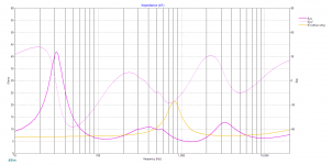

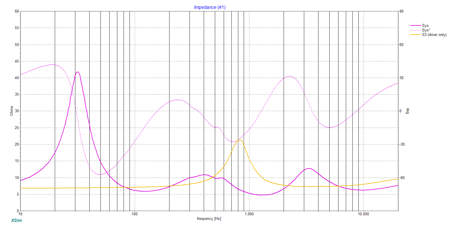

karoly, can you post an impedance plot for your tweeter and a schematic, this might be more instructive if we do a little simming.
Yes and sounds perfect.
L-pad seems best with 2.4/18ohm or 2.7/15ohm. I will decide later after a lot listening.
You said you only had a 22 ohm resistor available to you and we spent time considering that.
I wonder where the 15 and 18 ohm resistors suddenly came from?
I was just experimenting...I bought 2.7ohm, 15ohm and 18ohm Superes. At this moment we are listening the 2.7/15ohm version and not bad at all, maybe need less attenuate.
