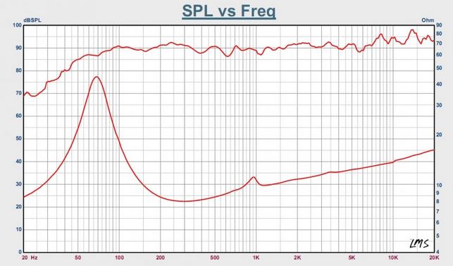

This W5-2106 driver looks like lowish inductance, but I can't find that Le voicecoil inductance to hand. Maybe 0.4mH just looking at the curve?
No issue at 320Hz. At 3200Hz it's becoming more inductive. But not too bad.
The rolloff filter at 3200Hz might need bit of resistance in the shunt. Hard to say. How's your filter looking so far?

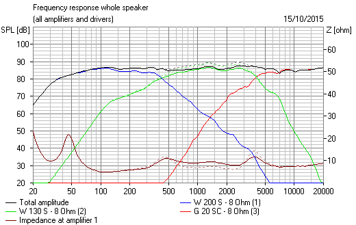

The modelling looks like below for something I had to hand. The first is the 2.2R in front. The second is 2.2R and 22R. Maybe the attenuator is doing more at the frequency extremes as expected.

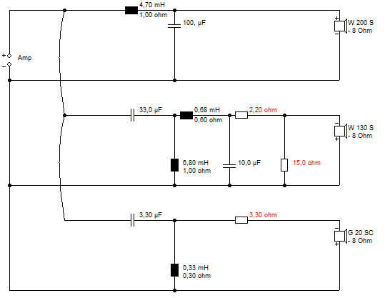

Let's give you an example. I just did a quick hack of this visaton stock HW 3/130 crossover above.
HW 3/130 NG - 8 Ohm
What actually works about right is the below circuit with an 8", 5" and 1", where I added some attenuation. In fact it's excellent with the right drivers. The W130S is like your tangband, but slightly different Le of 0.6mH.
1.5 and 39R might work just fine after the filter. What 1.5 db? Not very much in fact.

2.2R and 15R is about 4dB.
I was quite rough and ready with it.
3.3R and 22R would probably not have been much different, but higher and better overall speaker impedance.
In your mind you put 6 ohm DC speaker in parallel with 15R to get about 4.5R. then add the 2.2R for about 6.7R overall load, and the speaker gets about 2/3 of the voltage which is 4.5/6.7.
I ignore inductance.

Once you get the idea, you can use any similar drivers (similar Le is important) and fiddle around with resistors to get level right.
Boxsim has an optimiser. You mark components in red and the computer works out the flattest result. It's very neat. So just mark your attenuators, and it adjusts them.
