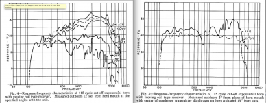

The spiral horns like the Sato or Western Electric can be good on axis, but off axis wildly different.Wasn't the gist of the thread some page's ago, that only a Sato horn fold or a Western Electric 1 fold horn would not be detrimental to the midrange 🙂
This thread kind of lost steam after Speaker Dave posted some measurements of Western Electric response curves in post #1010:
http://www.diyaudio.com/forums/mult...-how-far-have-we-come-last-100-years-101.html
On axis at 12 feet based on this graph the WE horns would be basically garbage in my room. I'm glad I didn't take that trip to Jersey to find out

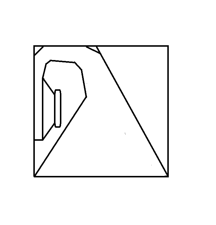

Well, I've been fiddling with bending the horn again, and I wasn't really that happy with attempting to put something like a Sato horn together.
Still, I tried the below, thinking that the driver chamber could function also as a rear support that could help position the horn at a more appropriate angle.
The kink is quite sharp, but I guess it wouldn't take much to add a small panel to the back bend, and something similar on the inside. Using that bend takes the linear length of the horn unit down to 58.55cm.

Using that bend will fink up the sound hard.I
Go back to 1984 when Dave Gunness figured this stuff out, substitute a parabola (you have heard of parabolic dishes, right) for the 45 degree angle below, and you will have something that works "much like" a straight horn.
Art
Ah, I understand. I'll have to play around a bit more with parabolic curves...
How much does the expansion of the horn affect this curve?
It almost seems like it would be better to have segments of the horn that are straight for expansion purposes, and then have a uniform curve at chosen points...

Right, for widest BW, a fibonacci spiral is the ideal, though it can be rearranged with excellent results when done right.

Maintaining the expansion of the horn through the corner parabola is the tricky part to lay out.How much does the expansion of the horn affect this curve?
You can use a piece of string to determine the arc and keep the path length the same.
Danley's patent below is similar to what you should try to accomplish, but the horn after the bend should only be a bit less in width than line "E".

Yes, getting the bends right is tricky 🙂.
The one you show results in two different path lengths, which will result in nasty peaks and dips, as well as an erratic polar response.
I see now what you meant to say by 'two different path lengths'
so that means asymmetric horn mouth should be avoided ... though, then there is the floor, or maybe a wall ...

I really should have wrote "an infinite multiple of path lengths", but it was easier to draw in just two.I see now what you meant to say by 'two different path lengths'
so that means asymmetric horn mouth should be avoided ... though, then there is the floor, or maybe a wall ...![]()
An asymmetric horn mouth does not have to have multiple path lengths, while in the Dave Gunness mode you could look up his "VariIntense" horns, which have narrow dispersion on top, and wider at the bottom to properly cover a deep room without too much side wall reflections and maintain even front to back intensity level.

my workshop is frosen, and no wood work right now
hmm, paraline you say ?
don't know
but not sure I would put my tweeter in there
but thinking about a paraline midrange
making it kind of like a compression driver
maybe MTM design could be a way to combine paraline midrange with small tweeter horn
btw, if your midbass horn is lifted from the floor I would not use any of what I suggested
only intended for placing directly on the floor
hmm, lifted from the floor ? ... maybe think about one with the driver mounted below

The ones I have will be 18" (45.72cm) above the floor, with a flat square panel in-between.
then maybe something like the first I suggested would still work
changed it a bit(drawing shows horn seen from above)
