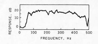

The Show Horn response is ragged, and has a hole around -20 dB at 475 Hz, right in the middle of voice fundamentals.
Bruce Edgar gives no technical reasons behind his folding, other than a cursory unvalidated dismissal of 180 degree bends.
I would not consider the Show Horn to be a good example of folding to emulate for smooth upper response.

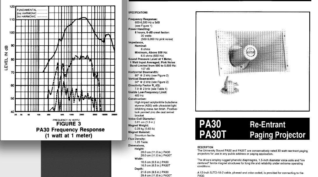

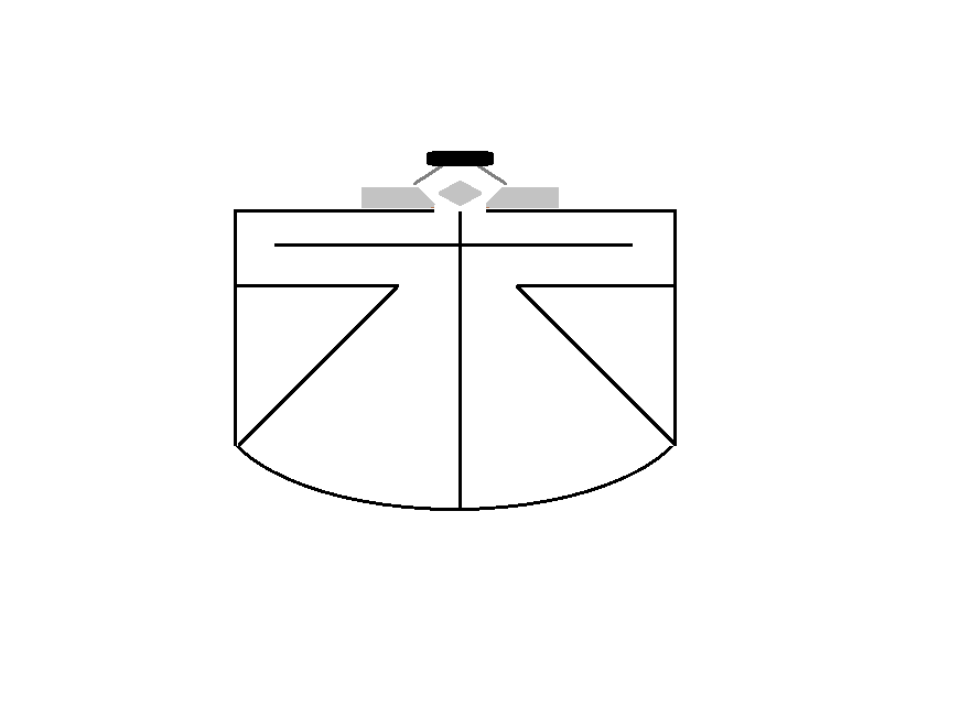

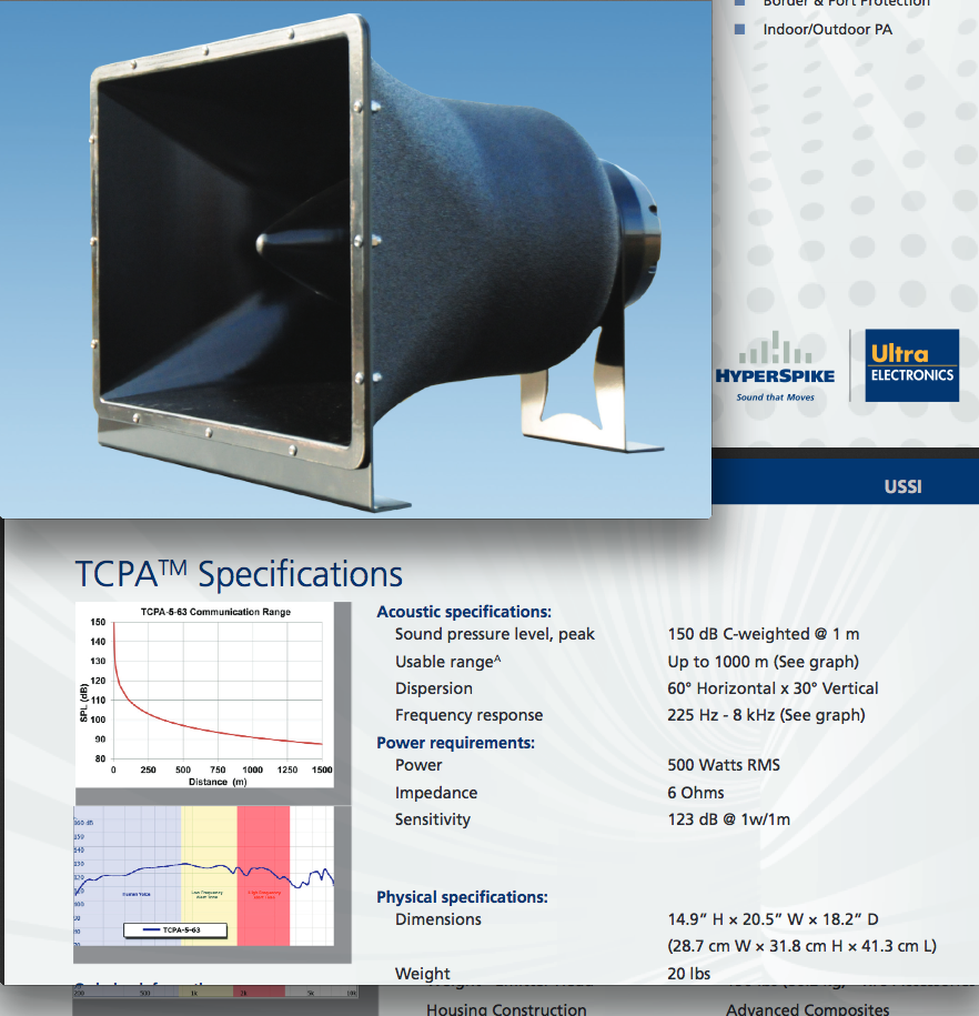

Curt Graber getting 250-8000 Hz relatively smooth response with a pair of his compression drivers at 150 dBC output from a 14.9" x 20.5" x 18.2" 20 pound unit is phenomenal.

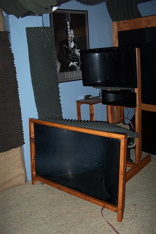

I can't figure out why you don't just build a straight horn with a 12 or 15 to cover your original 200 to 1000 cycle range and enjoy it. Why fold the horn when you don't have to to? a straight horn going to give you the best performance 😱
This system is whee I used a 6" diaphragm Emilar compression diver in a straight horn for upper bass and low midrange covering beyond your original 200 to 1K range. It sounded great.. but not as good as a simple straight horn loaded with a 15.
