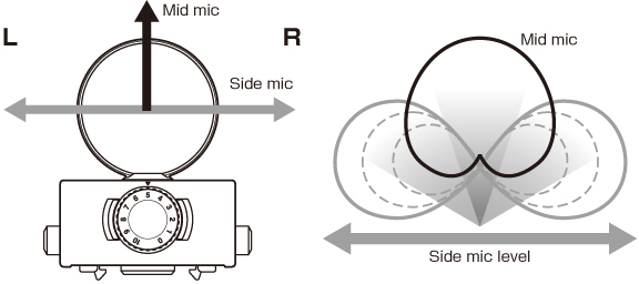

The link above is to an MS speaker project.
It's a perfect example of three speaker stereo that uses M, S/sqrt(2) and -S/sqrt(2) as its inputs - although one suspects the S channel is implemented with +3dB gain here instead.
The intention appears to be use the side walls as reflectors for the S-channels, in which case it is very "wide angle" stereo offering the worst combing effects possible (although only in the S-channel) and maximising the S-channel delay. The resulting 'ambience' I suspect is incoherence augmented by a lack of localisation of non-central sources.
Yet it is close to a system of much higher fidelity if the direct-to-listener paths had been optimised. Instead I suspect they were ignored in the hope of sitting in a "null" produced by loudspeakers with rapidly decreasing directivity.
Much better IMHO would be to produce a similar loudspeaker array that sought to maximise the reproduction of the recorded ambience with the most precise localisation feasible instead of relying on effects that smear the recorded information. The way to do that is described in the thread above.

Implementing HF S-channel compensation even avoids the need for the two or three band shelving filters in the MS matrix decoders invented by Michael Gerzon for wide angle/multiple listener set-ups.
If I get chance I will add more details. For now I would recommend reading up on the "stereo dipole" investigated by the ISVR and Gerzon's hierarchical matrix stereo decoders.
Both are published in AES Journal papers but I think both are also described in plenty of freely available web publications too. Edeko et al's equally seminal AES paper on conventional stereo is also recommended if you can get hold of a copy.
