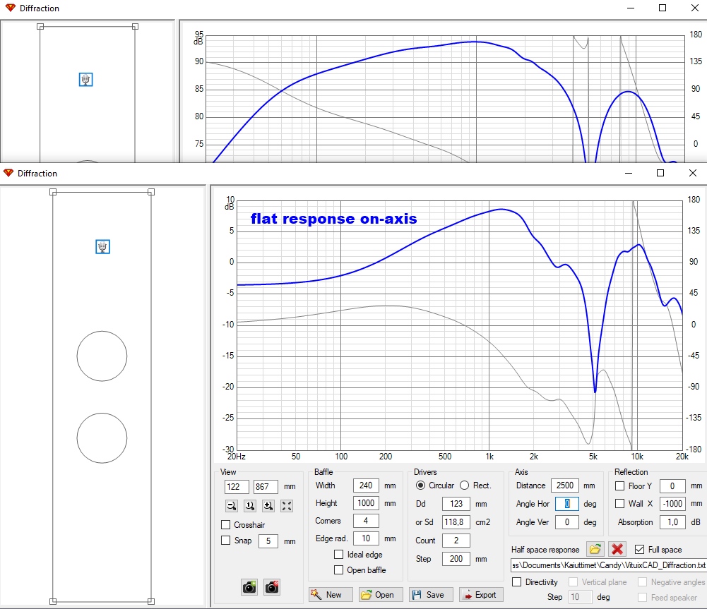

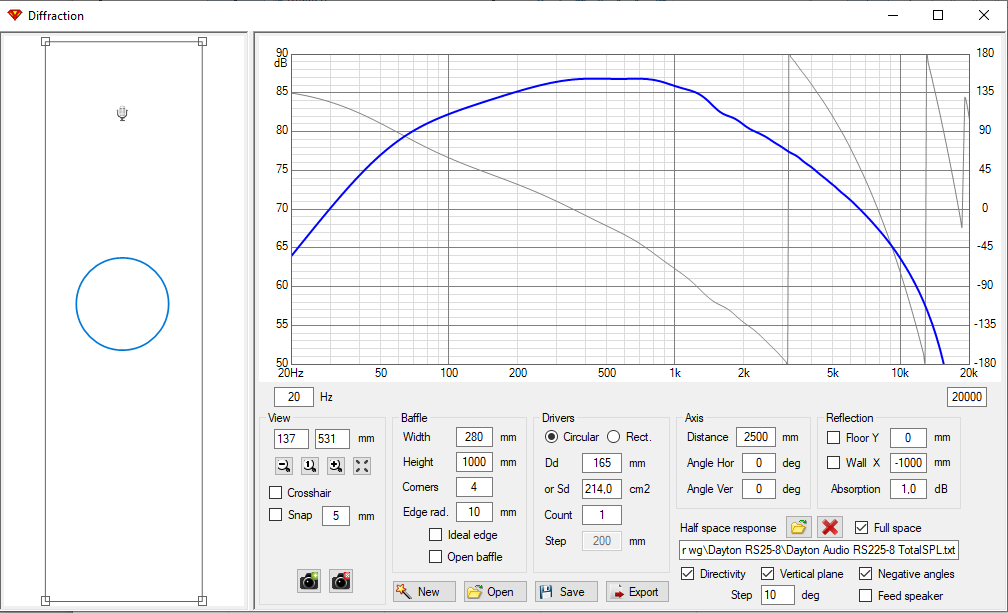

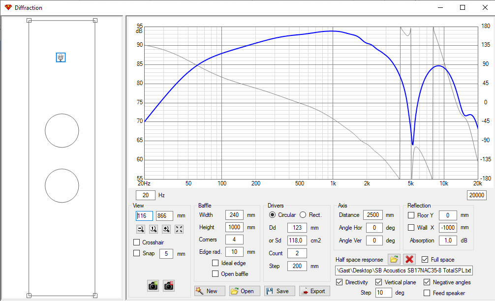

Here you go.
The sim is up to 60 degrees yes. It is limited because I use the infinite-baffle measurements SPL-traced from the HifiCompass measurements.

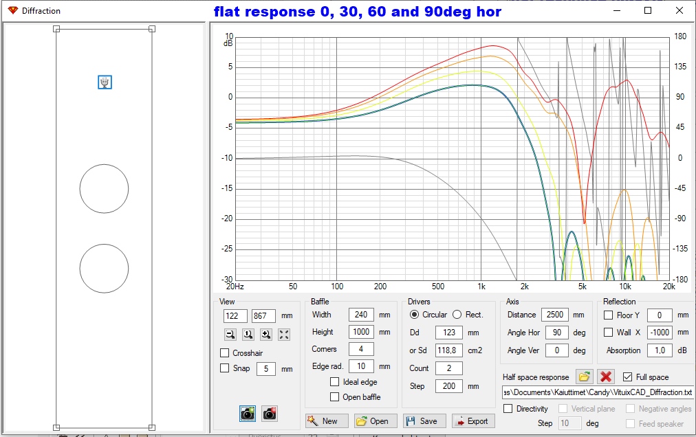

I did VCAD sims for the double woofers with ideal flat response, and VCAd calculating off-axis at 0, 30, 60 and 90 deg
Looks like using a 2" dome is not a good idea. The volt 3" dome in waveguide should be a fraction better.
A simulation shows response around 3-600Hz much better than indoor measurements!

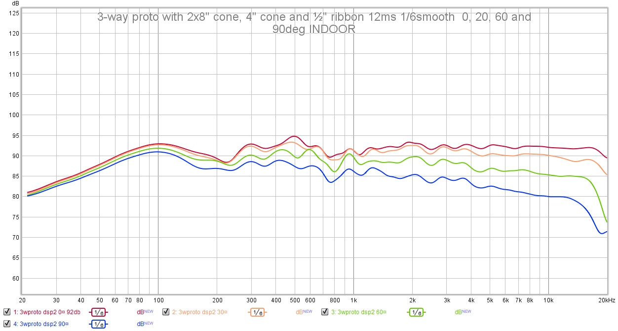

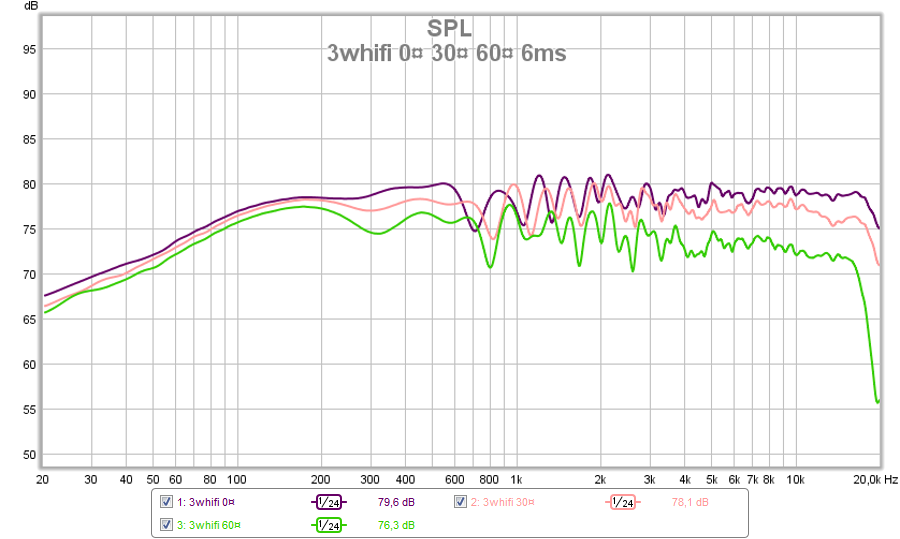

Here is my measured response of a proto with double 8" SS woofers, a 4" Audax HM100 mid and ribbon tweeter with waveguide (Fountek Neo3.5H)
Horizontal response smooth as can be! Wiggles come from recflections indoors- a simulation would look much better!
