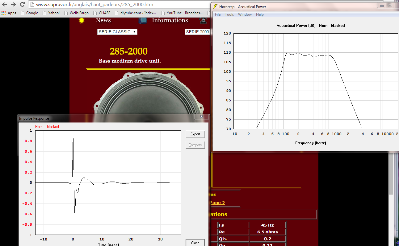

Has anyone simulated the Supravox 285-2000 in inlowsounds 80hz or 100hz horns. What dimensions need to change? I really like that driver and want to use that from 80hz to 350hz in a horn.
Here you go (without the adapter chamber):
Yeah, the supravox will need a very nice sub with good lower midrange. I.e., not the Eminence Lab12. Lab12 is good for movie explosions, but not music.

Thanks a lot Carpenter! Thanks for your sharing of knowledge over your site as well.
I am using 20hz eminence tapped horn (full scale 2,44m) with eminence 3015lf, klipschorns for midbass, Greg from Voltiaudio designed FC260 horn for midrange with BMS 4592nd-mids, and fostex t500amkII for tweeters. I am planning to change the khorn midbass with something lower in height, so I can get the midrange and tweeter closer to my ear levels and also get better response.
Do you think having 80hz inlows horn with the supravox 285-2000 will yield in better response than khorns midbass. What I mean by better response is more linear, with good detail and decay...

The Supravox will be more detailed and have much better snap in a front loaded horn then the Khorns. You may have a problem at the upper end of the tapped horn (80-100hz) as most do not sound too good in that range. You will have to measure the tapped horn frequency response and see what its upper limits are. I would definitely go for the 80hz horn over the 100hz horn. That extra 20hz could make a big difference in your particular situation and give you little wiggle room.
You might have found an awesome combo here!! 100-1000 at 110 is the bomb!
