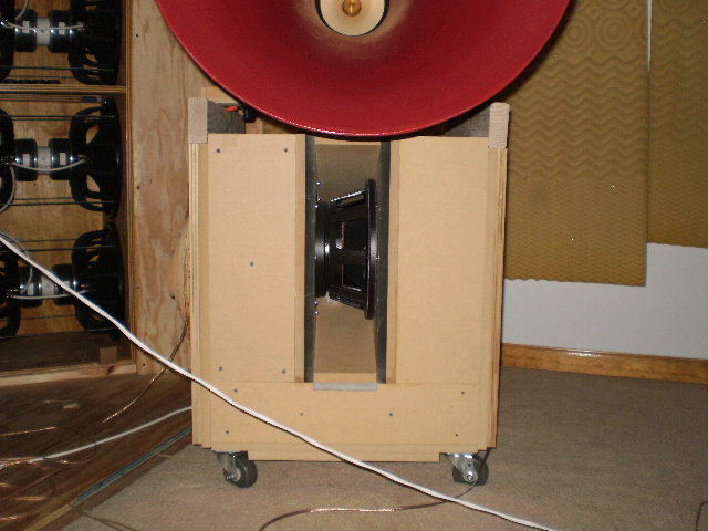

So, basically it is a large vented subwoofer with the driver mounted on the outside?
I remember seeing one at the BAF several years back. It belonged to Nelson Pass, IIRC... it was interesting. Seems to me it made bass and sounded pleasant.
How high can you cross this? 140Hz? 200Hz?
I am crossing this to the red round horn you see above it, at 250Hz 18db/oct.

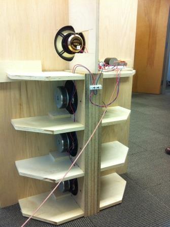

I would imagine you can cross fairly high. I can't remember what Nelson had to augment the woofer section; I'll have to see if I can locate those old pictures. If his mid-range was small, the the woofers would have to be crossed high enough to overlap.

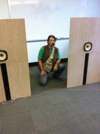

Here's a snapshot of Nelson's speaker affair. The crossover point could easily be 200hz. The fellow squatting between the two sides is my friend, Choky. 🙂
I saw and heard those at that BAF. They were paired with upper range (ticonal, I think) Lowthers and did work very well.
