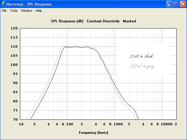

For the 80hz horn, I simmed a pair of the 2226 16ohm versions in Hornsresp and the results are similar to the 2240. The gentleman happened to have four 2226J units at his disposal, so it seems a natural to use them in this fashion.

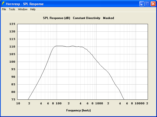

This is a sim of the 80Hz adapted to EVM-15L.
Yes, I happen to own a pair of those drivers, have the same sim results, and will build a pair for my neighbor as a show of gratitude for allowing me to use his shop. 🙂
Have you had a chance to measure your horn to compare to the predicted plot?
I've only measured it by "ear" and can attest to Hornresp's accuracy. It's a mean little critter and can easily outperform any other component in my system.

In my 80hz design, the sim looked favorable to me.

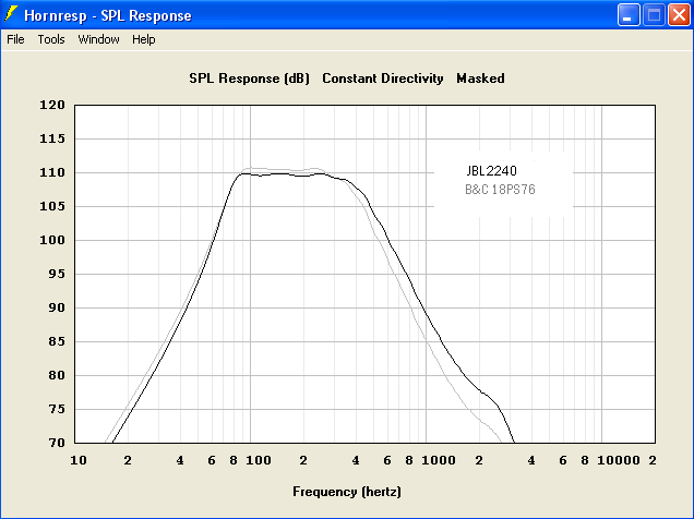

Unfortunately the 2240 is obsolete although they pop up on epay. Carpenters mentioned the 18PS76 but I notice its T/S aren't really that close. I haven't put the numbers into Hornresp to see how it'd differ.
The B&C 18PS76 is very affordable, that's why I bring it up, and it has favorable qualities. It's not as wide ranged as the JBL 2240, but is readily available.

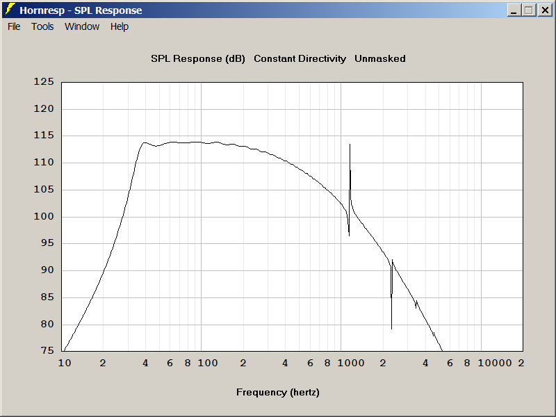

Did a quickie on the 2226 as Hypex basshorn. A 35Hz/T=0,6 looks good. Can give it a little more time. If mono is acceptable one could also run them as a pair and give you a shorter horn. Doug, please start another thread if you want to continue.
May we see the input parameters and the impulse response?
Earlier said the 2226 wasn´t suitable for midbass work. After simming the 35Hz I gave them a new try. Doesn´t work as a single but with two. Still can not recommend it. This as part of the sound of the original 18" will be the important factor of singlepoint direct-radiation.

This is the script of the 35Hz. Place it in Hornresp/Import and open it. I do not use Hornresp for designing the horns. Instead I use my own Hypop spreadsheet for proper anulling. As Hornresp, the spreadsheet is based solely on Marshall Leach AES-paper. Using it gives you full control of all parameters.
