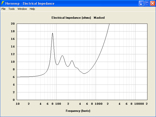

...do you happen to have an impedance sweep of that horn...[/url]
Here's the modeled impedance sweep:
Hi carpenter,
Based on his link reference and expressed interest in the effect of horn truncation, I suspect that JoshK might be referring to the throat acoustical impedance rather than the system electrical impedance 🙂.

Thanks David. That was my second choice and the graphic is waiting if Josh requires it, but you beat me to the punch. I like your thought process and it certainly makes sense considering the bit with horn truncation. All I know is your software is the "cat's meow!" This is the third horn I've designed using Hornresp and it seems to be dead on. The first horn being my huge tapped horn, and the second horn being my folded bass horn. Wish you and computers could have been around 30 years ago 😉
David, would you mind explaining the details of the graph you posted? I'm not totally up to speed on how it functions, or it's importance. I usually lean towards the SPL response and the Impulse response graphs.

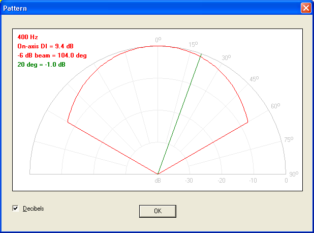

Hey John,
Nothing special about this. I took At, Am and length from your plan and assumed you used exponential expansions for the two "folding" points.
Used Exp in Hornresp and instead of using the, for a mid or high, less useful "Constant Directivity", I went for "Tools/Directivity/Response/Off-axis(degrees)". Did it just to get a picture of what will happen.
Think it would be a good idea to initially compare SPL from your horn and the Exp to see that they aren´t to far from each other.

Would you mind explaining the details of the graph you posted?
Hi carpenter,
The Hornresp throat acoustical impedance chart shows the resistive (black trace) and reactive (red trace) loads presented to the driver by the horn - either directly or via a throat chamber. While it is not essential for a loudspeaker designer to have this information, it can be very useful in showing how the load changes as horn dimensions are altered. It is of course a fundamental input as far as the Hornresp simulation model is concerned.
In general, for a constant throat size and cutoff frequency, reducing the horn length will increase the magnitude of the ripples in the throat impedance, making the overall SPL response less smooth.
Each horn flare type has its own characteristic throat impedance "signature". It is often possible to identify the horn flare type simply by inspecting the corresponding throat impedance chart 🙂.
To fully appreciate the significance of throat acoustical impedance, and its place in horn loudspeaker theory, it is probably best to refer to one of the classic engineering texts such as Harry Olson’s "Acoustical Engineering" or Leo Beranek’s "Acoustics".
Kind regards,
David

I'm having difficulties getting the directivity feature to operate on my version of Hornresp (I believe it's the latest version: 28).
I'm having difficulties getting the directivity feature to operate on my version of Hornresp.
Hi carpenter,
Don't forget that the Hornresp Directivity tools only work with single segment horns 🙂.
(That is why Lars is suggesting using a single-segment Exp approximation).

I just figured that out and am about to post a pic of the results. Thanks David.
I kept the horn length the same and only varied the flair from Conical to Exponential.
Hi carpenter,
At 400 Hz, the difference between 0 degrees and 20 degrees off-axis is only 1 dB - looking good 🙂.

From the master, himself, thanks David. I can't believe what a fantastic addition this horn has made to my stereo system, and I owe it all to you -- and that's no bull.
Thanks John. I am very pleased that you were able to put Hornresp to good use 🙂.
