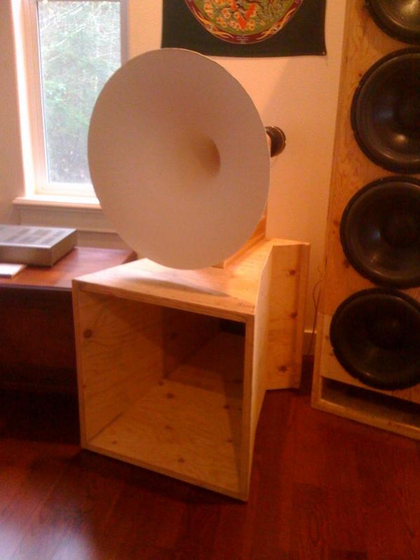

I've designed a great sounding mid-bass horn that's super easy to fabricate. I'm using a JBL 2240 18" driver, but have simulated (Hornresp) inexpensive B&C 18PS76 18" woofers that perform almost as well and cost under $200.00 apiece at Parts Express. I've posted info on my web page: inlowsound.com

My ony concern is that the horn is a bit small (theoretically) for 80hz loading. Have you measured the impedance sweep?
From your plans, I gather your horn is roughly 32" long and has a circumference of nearly 96". Typical horn math philosophy suggests that the mouth circumference be one wavelength and the depth is > 1/4 wavelength. The wl of 80hz is 168". 96"/168" = .57 wavelength and the depth is ~1/5 wl.

There will be no problem with this 80(75Hz) horn. If you look at Edgars 80Hz it is only ca 60cm long and Am ca 3000cm2 and that one works OK.
Here we have over 80cm length and almost 5000cm2 Am. The only concern could be the rather high Mms. But the sims says something else.

Thanks for the input, guys.
This horn hits the drum passages with power to spare and sounds excellent while performing its job. I hear very little distortion compared to the exponential horns I used to build. Hornresp has been such a blessing -- what an amazing age we live in.

FWIW, I am not critizing the choices made. These are certainly more reasonably sized then full mouth horns. My question/concern only has to do with what effects do the compromises have. I simply have no experience here and would like to ponder the issue.

If you have an excellent subwoofer section, then you will find this mid bass horn is just the right size. In fact, I designed it to tamp down the sub bass -- it always felt like a tank down low in that my system had gobs of power, but felt clunky. This horn gives plenty of snap and punch and takes my system from very good to excellent in the performance dept. It's no longer a Cadillac, but more of a Formula 1.
Edit: the horn is allowed a smaller mouth because of the plane it was designed to perform in. It gets the back wall and the floor, and perhaps even a bit of the side wall for the very bottom end of its spectrum. Believe me, there's more bass there than I expected, and because of the light cone/powerful motor in this 18" driver, the power is out of this world.
