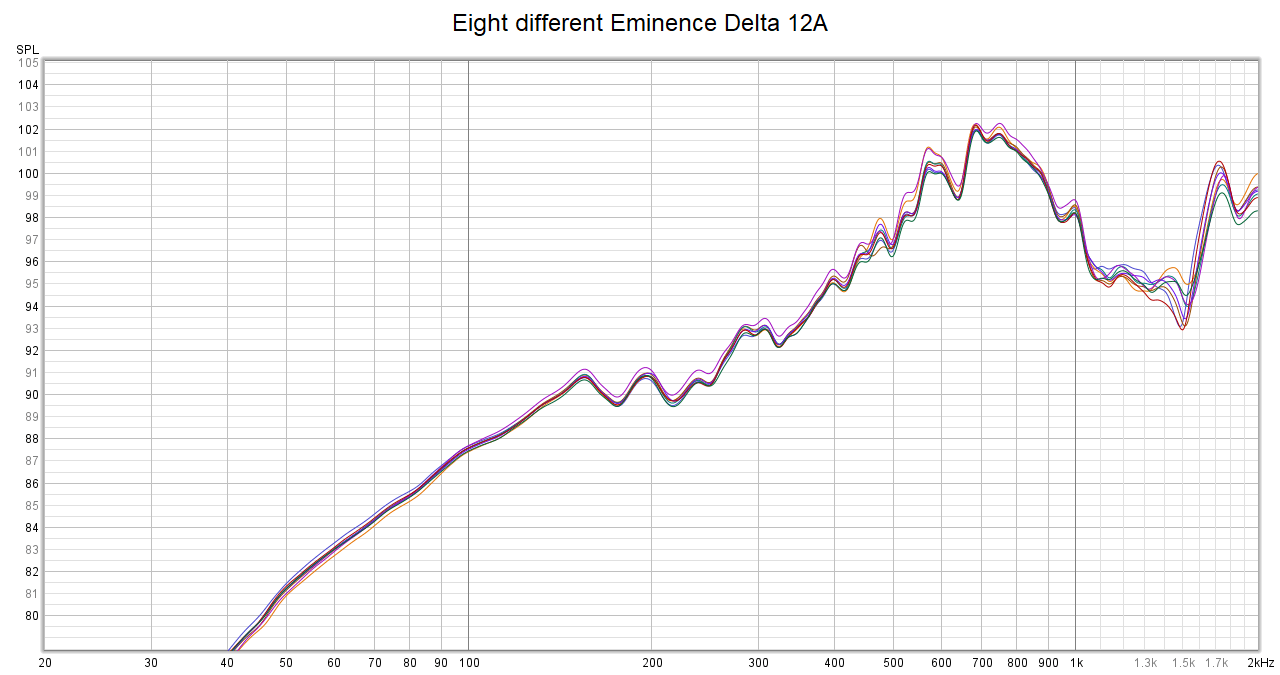

Even though not very expensive, Eminence do have control over their production. Here's a near-field measurement of eight Delta 12A's from two different production batches. Any difference may just as well be related to my measurement setup, as the drivers themselves. The drivers were laying on a table with the mic 20 cm above. I might have placed them slightly different between each measurement. Anyhow - they show very good consistency.
There's no excuse to not have good driver to driver consistency in this day and age or mass production. I've gotten some pretty sloppy stuff from eminence in the distant past, but I think they have their act together nowadays. I do see the occasional shift in VC lead ins not lining up with the terminals on the basket and skewed / crooked cone relative to the spider and basket. I expect accuracy in assembly for the money they now charge after their huge price hike recently.
