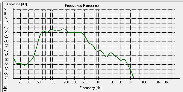

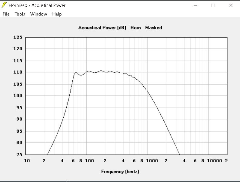

I'm building a 1.74m long (horn path) exponential mid bass pair at the moment.
Modelled this
Measured this early part finished (more layers to go) horn in workshop, so not ideal. At reasonably loud volume.
Freq sweeps aways sound so loud!
+/- 5dB is a good guide when measuring, I've found.
