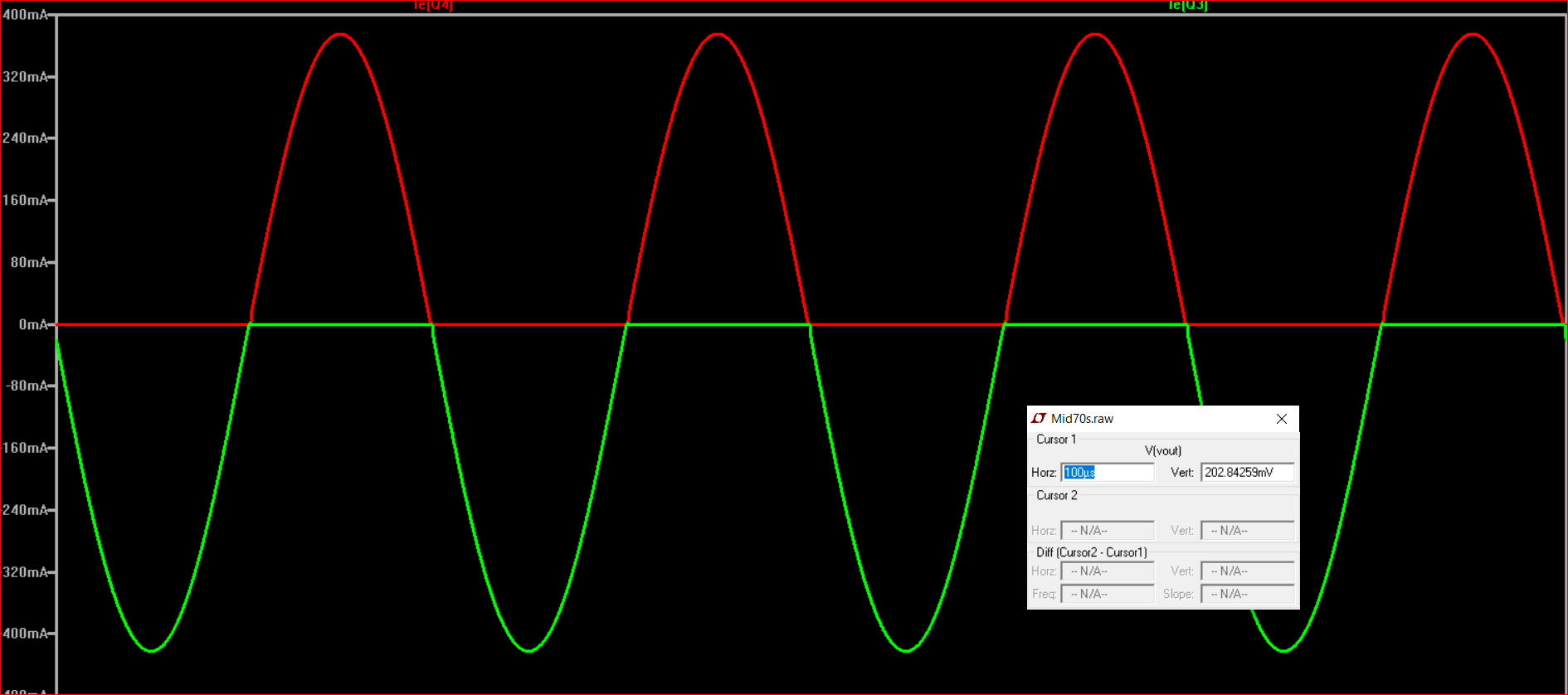

I drafted your circuit in LT Spice - a stab effort from what you provided. I have been flexible with some component values and types. The main difference between this and the circuit OldDiy posted is a resistor connecting the base of MC150 to the supply rail which I included.

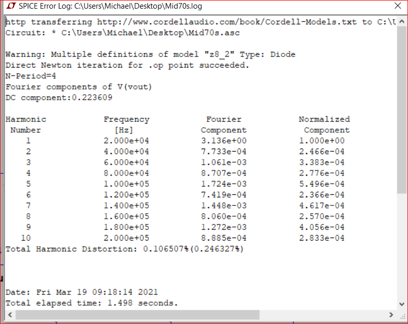

At low output the THD at 20kHz is amazingly good for such a simple circuit - 0.1 %. Actually the value of the input trimpot in the simulation is 347k.

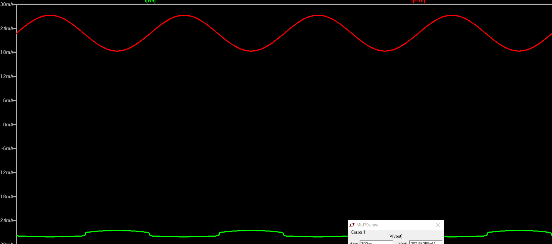

The .asc file and a plot of the emitter currents which shows the output transistors turn off virtually at the crossing point. Through that point R9 and R10 remain in conduction so there is hardly any notch distortion.
