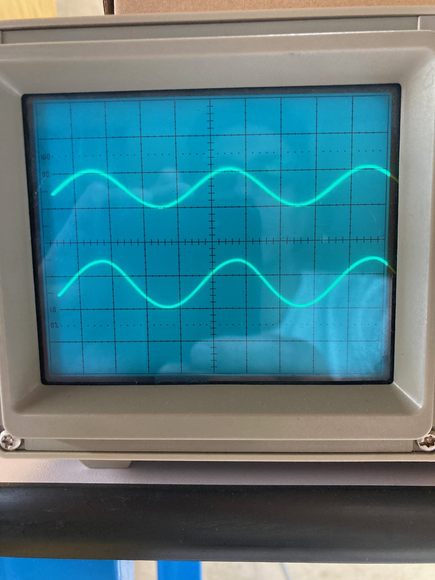

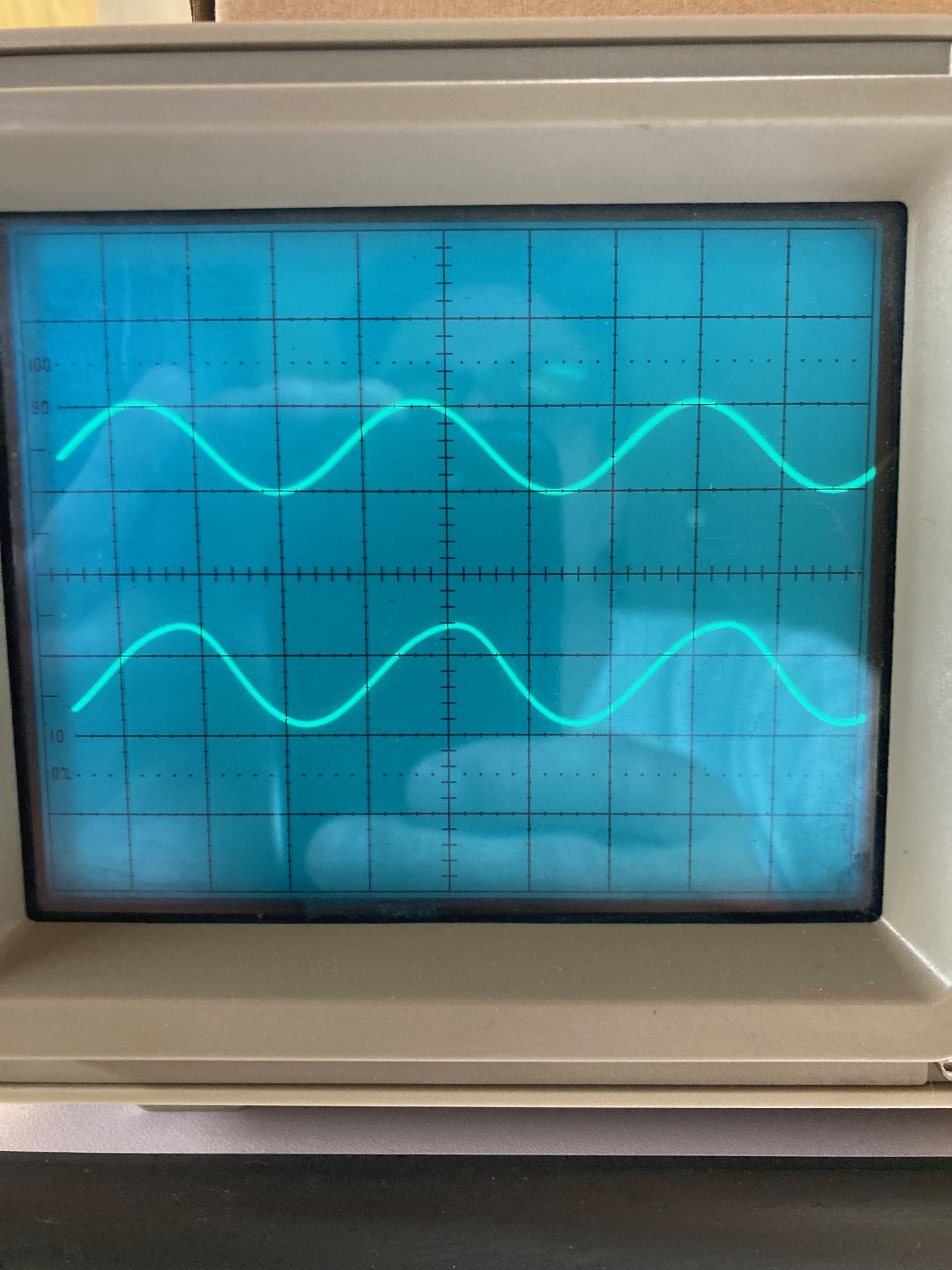

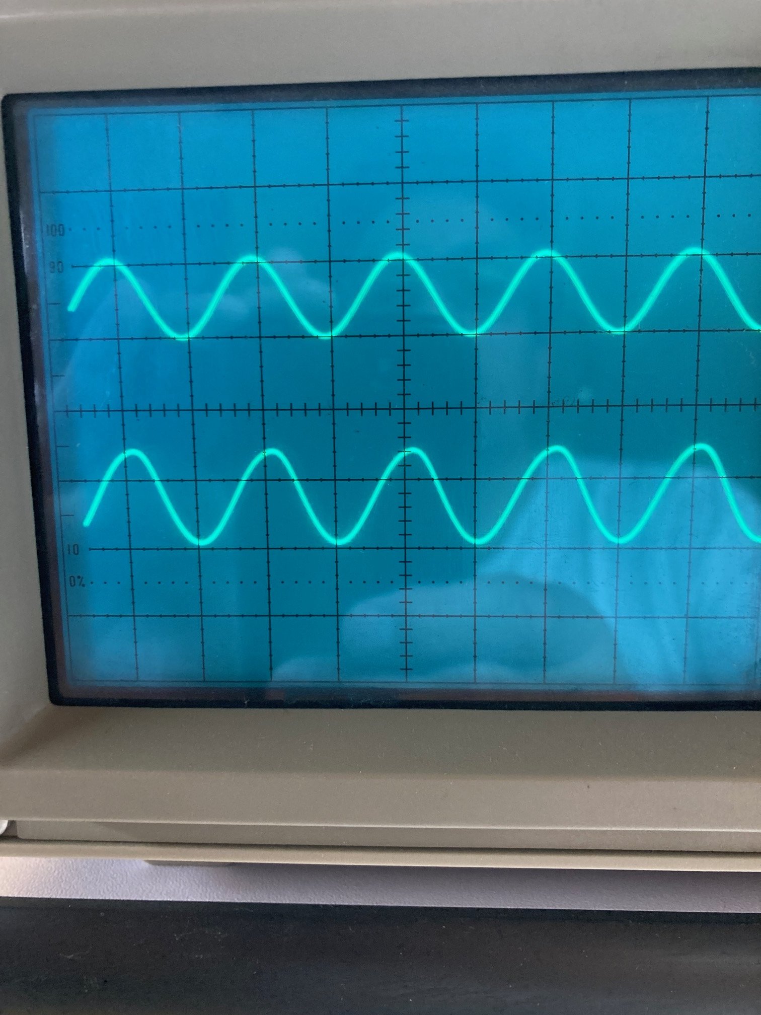

Below are traces from an Arch Nemesis, a MOSFET driving an 8:1 OPT made from MOT cores. Top trace input, bottom trace is output across the secondary, feeding an 8R load.

I wouldn't take post #5's results as generic until some better measurement data is presented.
