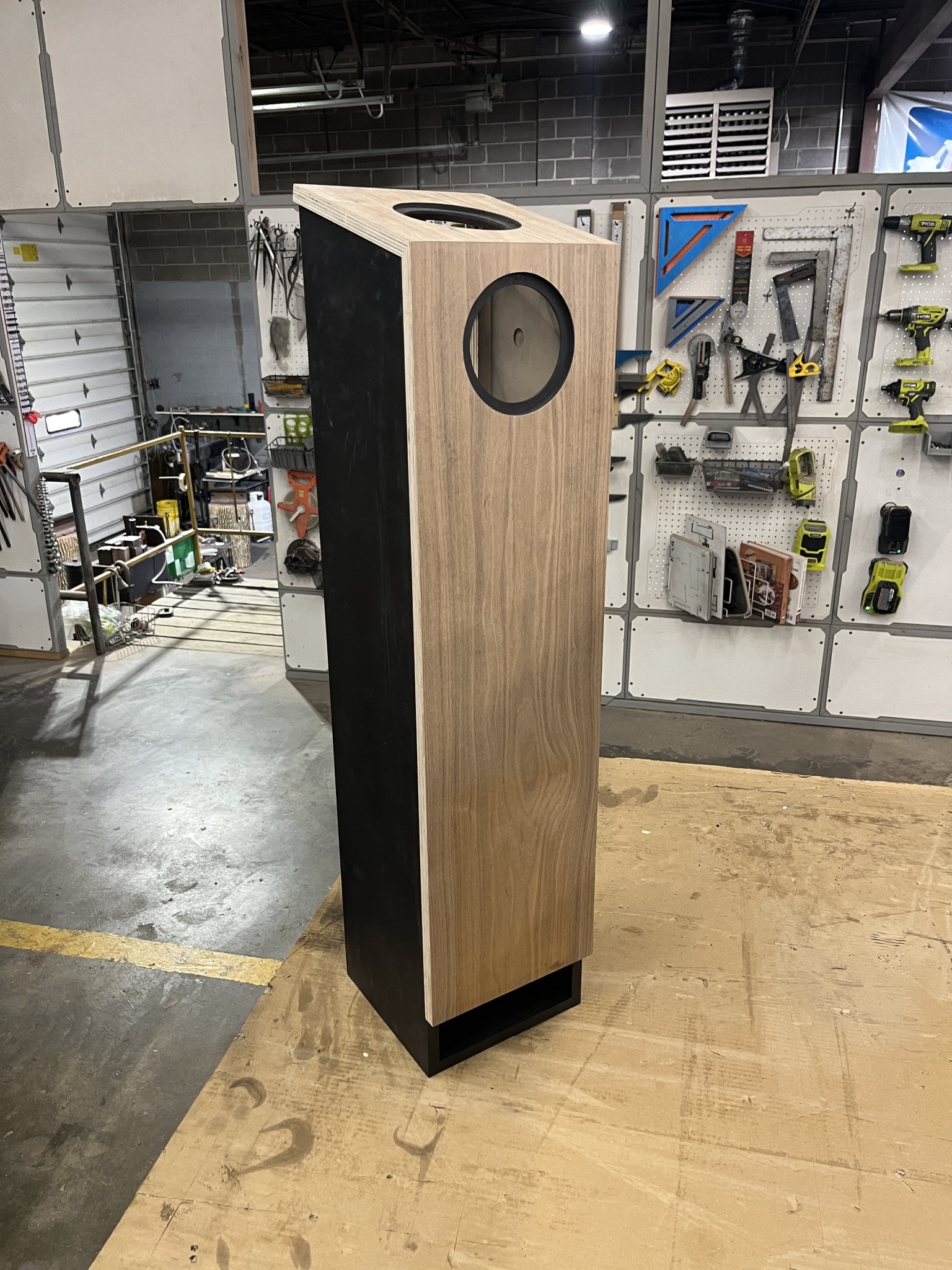

Progress shot of one microTower.
5/8” Baltic Birch with General Finishes Lamp Black and walnut veneer on the baffles.
If I recall correctly the MicroTower design has a round port exiting through the bottom panel?
The official version. There are versions of with slot vent.

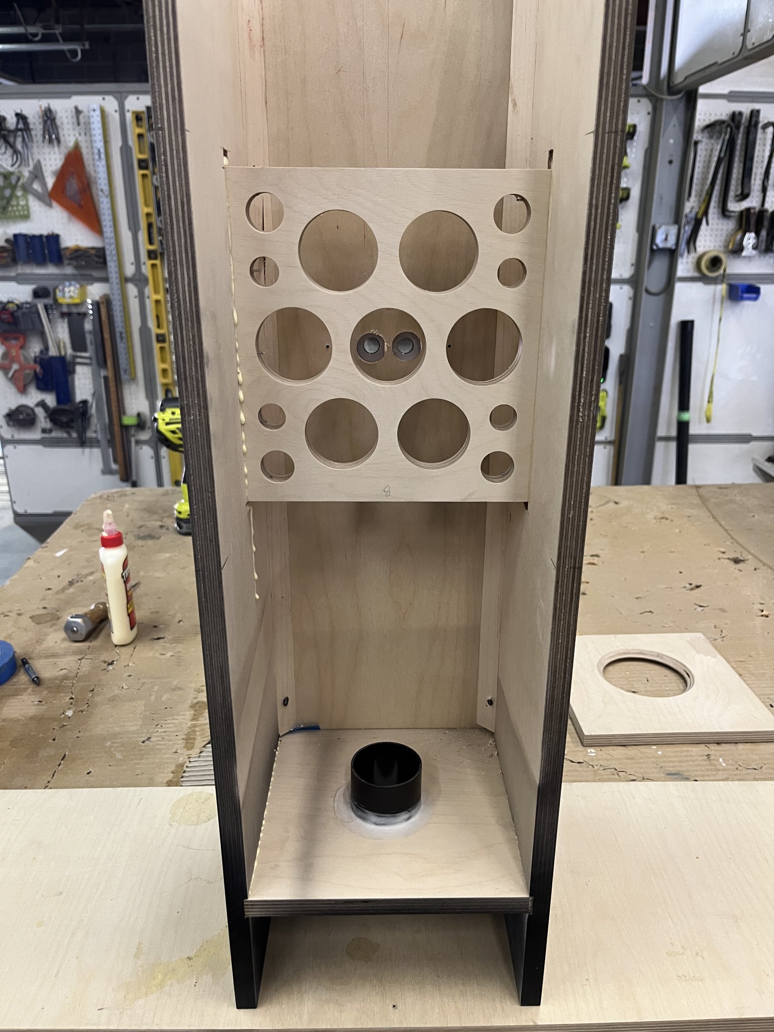

Progress.
4 oz of acousta-stuff damping material teased in the upper 2/3 ish (to bottom of brace) in one cabinet. Bass is slightly heavy and kinda boxy sounding. (Surprised by amount of pressure at the port at this volume).
Thoughts ?
Tease more and reduce amount of damping?
More damping?
Second box, I may hook up with only upper lagging and without acoustic-stuff to compare.
Thoughts ?
More damping?

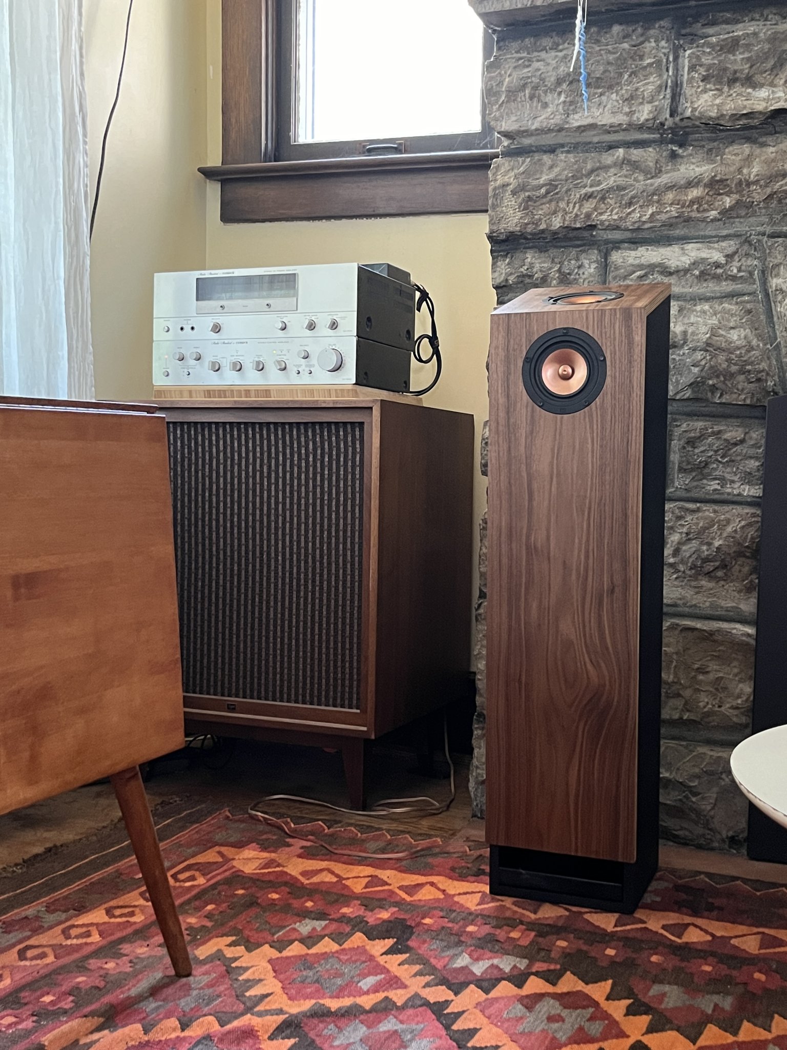

Another day, another perspective.
My golden ear son and I compared the 4oz fill with the empty cabinet late last night (+/-12” from wall, recently recapped 80s Fisher BA6000 - balance control was very helpful, and many hours on the drivers in temporary cardboard enclosures). In the shuffling around of cabinets and cords I lost track of which cabinet was which. We both agreed the filled cabinet sounded better…it turned out to be the empty one!
This morning I re-teased the damping material and redistributed with 2oz in each cabinet. I just moved them to my office to their permanent location. My office set up is a work in progress - a combo of Aiyima T9 Pro as preamp + Aiyima A08 Pro. Speakers about 12” from walls with parallel drivers.
I just played side one of Shane Perish’s solo acoustic Repertoire as the first listen.
The microTowers are MAGIC. I’m incredibly pleased with the results. Thank you @planet10 !

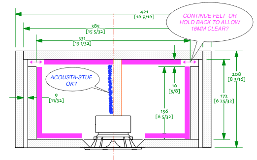

Would there be a benefit to having a narrower baffle, say in the range of 170mm-180mm, to reduce the height? I have plenty of space for the enclosure to grow deeper and/or longer. Shorter would be helpful.
I've noted two questions on the sketch.
- Is Acousta-Stuf an acceptable damping material for the face of the brace?
- Should the 12mm lagging be held back to allow 16mm of clear area before the slot ports?
John
