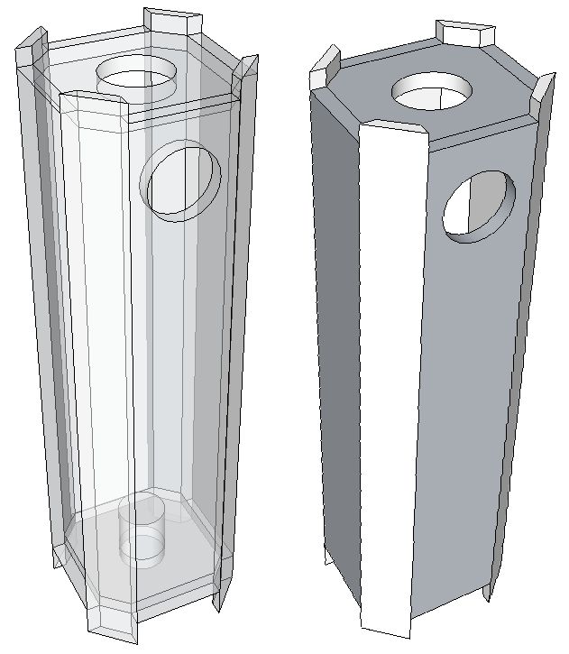

I would like to modify the design to make it more interesting (to build and to look at), but don't want to do anything that may decrease their performance. Is it simply the internal volume that should remain true to the plans? Are the width and height critical as well?
Here is a drawing I did, I think it's a pretty cool design aesthetically, and it accomplishes it's task fairly well. It would have two seperate grills, with the castle part on top holding the top grille slightly away from the actual speaker. At the right angle, you would be able to see the actual driver, which I think is kind of neat. The corner pieces could also be finished differently from the rest of the speaker, which would provide nice contrast.

I really like the look of beveled speakers, and if they help with the sound? Well that's just a bonus! The micro towers also require legs, to allow room for the down firing port, so if large bevels are being designed in, why not use those pieces for the legs as well? And why not continue the theme up top, to produce a literal "castle". Others may groan at that, but it puts a grin on my face 😀.I'm trying to encourage people to have fun with mutations on these, and bevels or roundovers are a very good one.

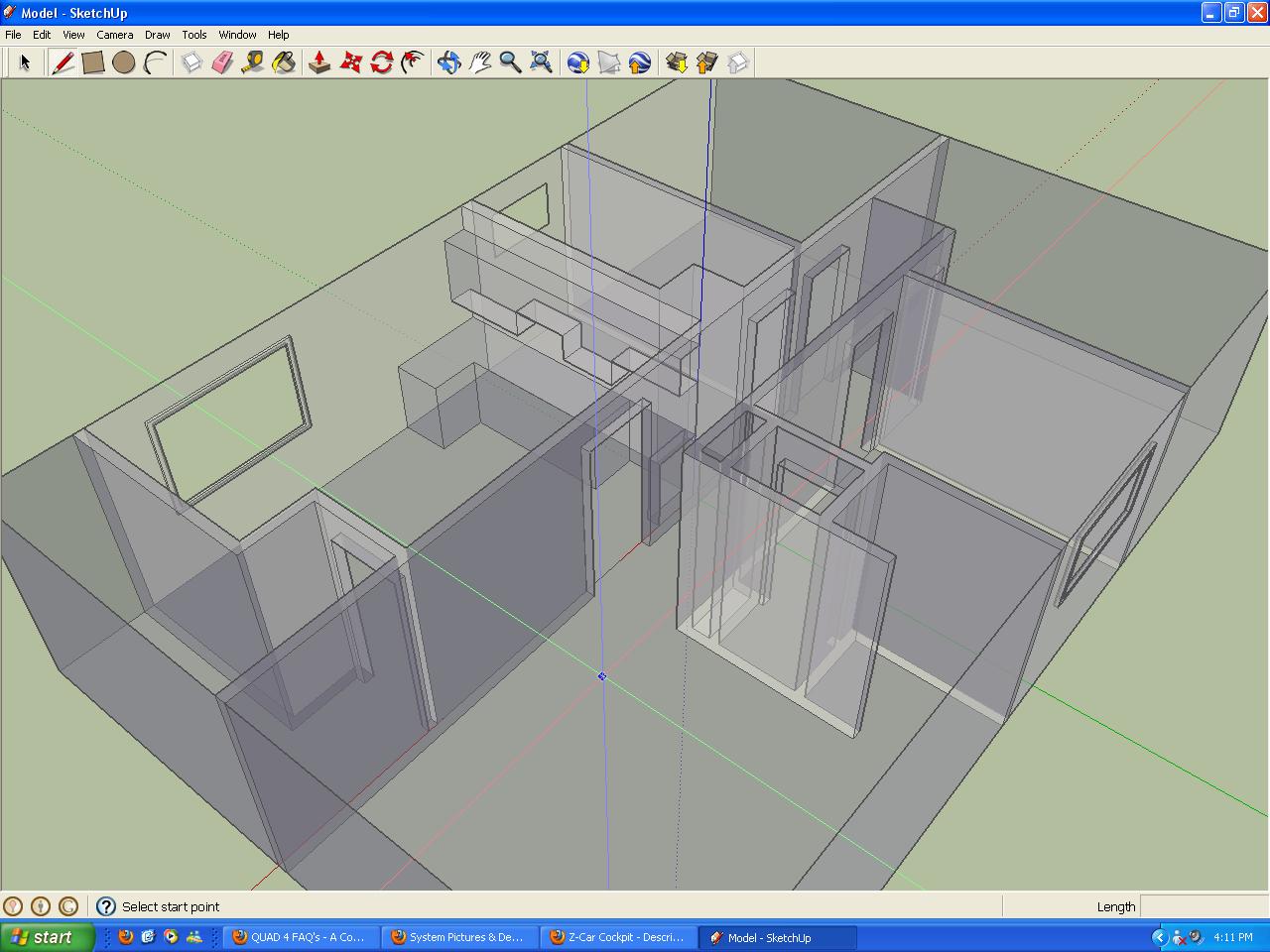

P.S. I created that drawing with google sketchup. I just downloaded the program last night and I absolutely love it. I spent most of last night running around the house with a measuring tape, and have so far digitized almost the entire main floor of my house! It's that user friendly!
No, I don't work for google 😛
Excellent. Mr Bastard 🙂
What is important are the column height & the cross-section.
dave
I like that beveled look. If you build them, be sure to post pics and share the plans!
Cute design - my only concern would be diffraction effects from the extended panels making the side bevels. Perhaps they could be chamfered on the inside?
