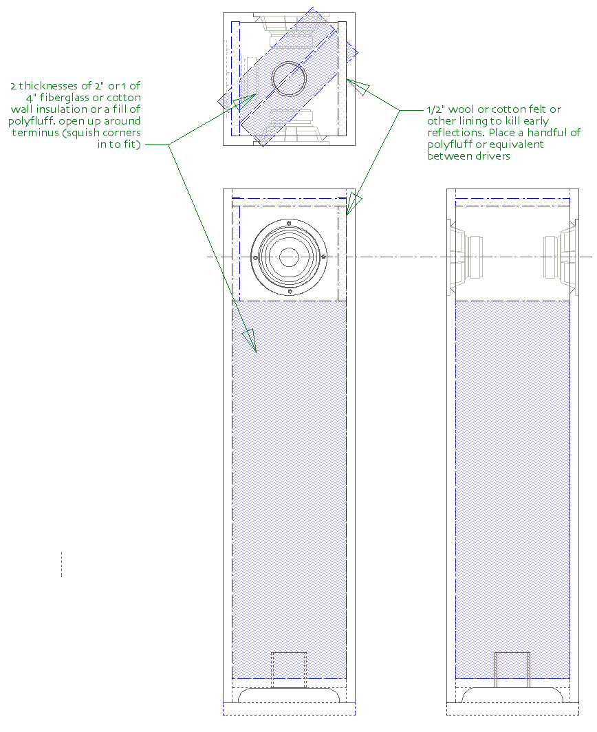

OK, so I get the "from just below the driver" part, but I'm not getting the "across the diagonal" description.
This idamping is based on that used in the original -- a single piece of 3" fiberglass insulation, placed diagonally across the line. The original did not have a restricted terminus so when you flipped it over it was clear.
We used a single piece of 3 1/2" Ultratouch, perhaps not quite enuff.
Attached is a quick and nasty drawing... one might want to tease out the insulation a bit to leave less open space. I've drawn it with 2 of the 2" thick pieces.

Some creativity is required to twist or cut to navigate past the bracing.
dave
The thicker fiberglass or rock-wool insulation can be a bitch to cleanly cut, but with a sturdy set of upholstery shears, the Ultratouch denim is pretty easy.
I notched the diagonal bat around the bracing- making for a very snug fit that required no adhesives or stapling (good thing, 'cause it's a tight squeeze to get tools inside these boxes) . A picture's worth a thousand words, but when I'm working alone, the last thing I have the discipline for is to stop to pick up the camera.
