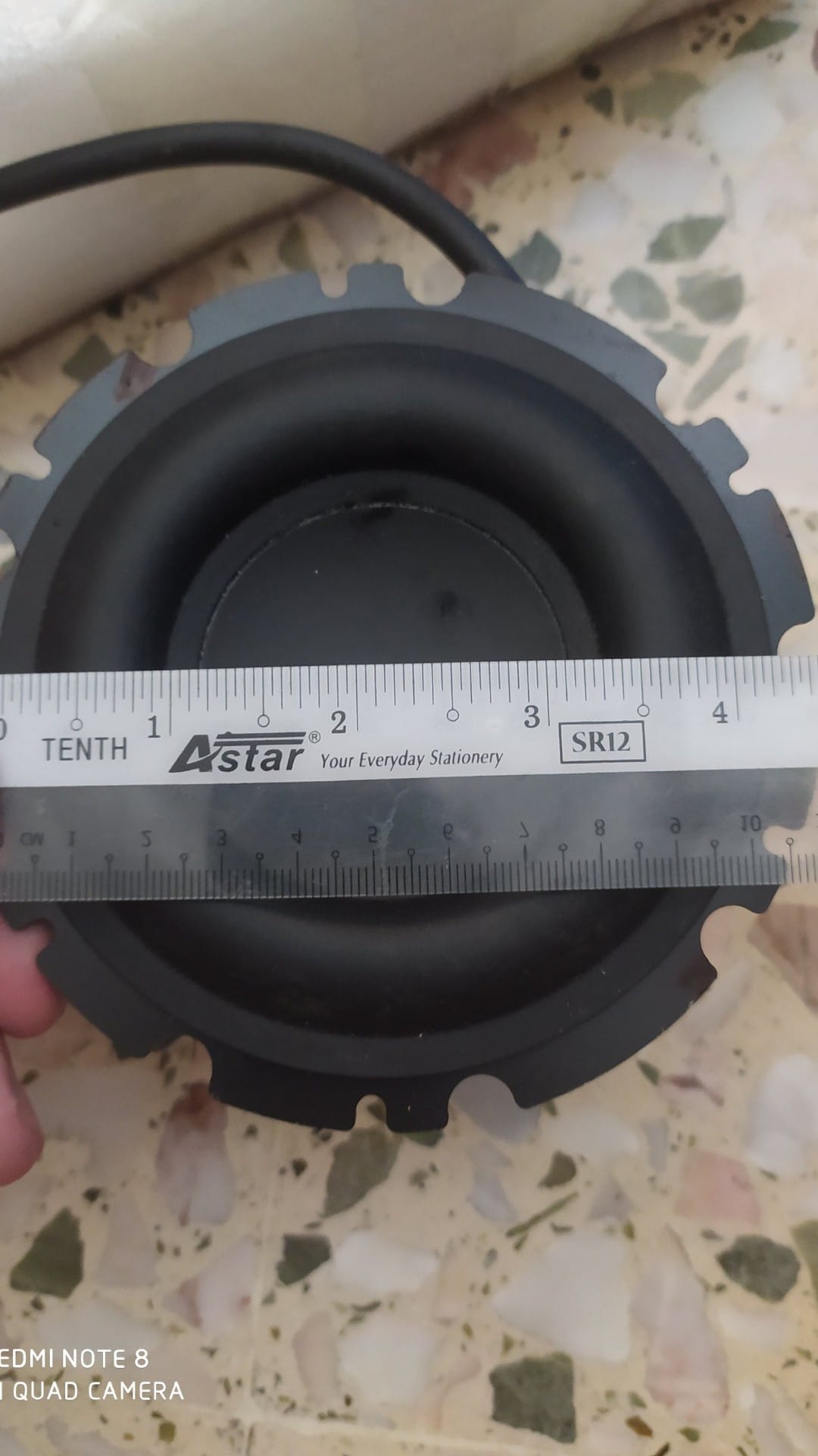

diameter 4.3inch
SD 14.57 inch
that is the best i could get and Vas i've averaged out after 3 times measurement.

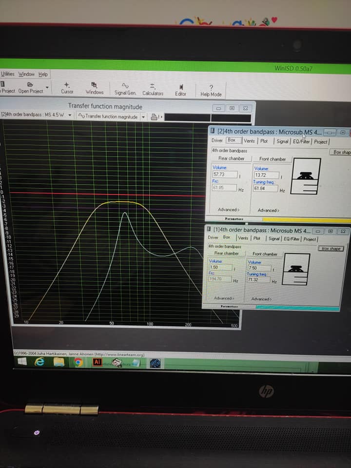

when i ran my simulation on WinISD ... it returns out results of suggesting very large enclosure size for this particular micro subwoofer especially it was only a 4.5 inch driver no doubt it has very low FS and fairly long excursion ... in my previous thread i did post a concern about the over excursion issue and therefore against the use of ported system and try something to control the excursion due to during listening test with my test box it slammed the back pole piece quite few times the cracking noise (50W driver powered by 300w amplifier)

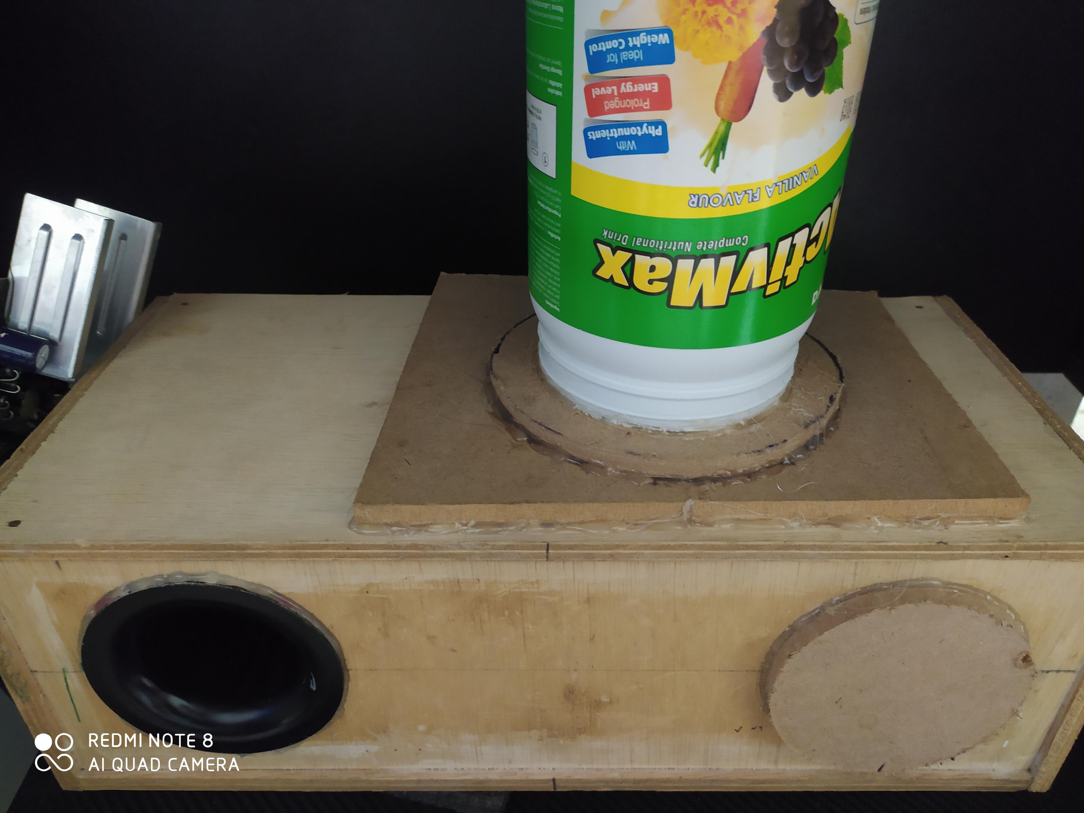

after simulation on WinISD was two graphs one showing the "RANDOM PROBBED TRIAL AND ERROR" 4th order bandpass design (light blue line) vs another one suggested by WinISD (yellow line) which was pretty large in box volume. I dont want to get it wrong again this time. And there was also a photo of the current garbage trial and error 4th order bandpass design ... what i've experienced peaking response around the midbass was accurately simulated by WinISD.
so the issue now the bigger volume suggested by the simulator is a good news or what? or might be something worse? i dont have much experience on 4th order bandpass system wish some experts here can help me out ... thanks

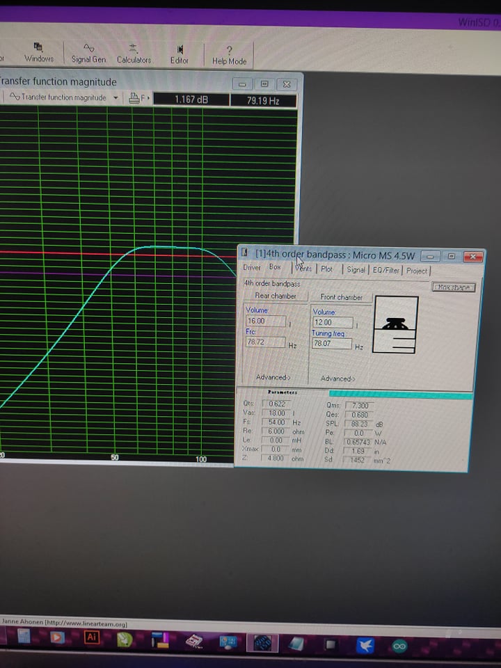

Assuming you have to control excursion using the box (i.e. you don't have an adjustable highpass aka subsonic filter on your amp), I recommend 14L rear chamber, 12L front, 80hz tuning. It should take the full 30watts without problems, but it doesn't use the potential of the driver as well as a different design (which counted on highpass filtering) would.
Ya that is the concern over here mainly more over the excursion issue as now i found that this driver has such low fs i am trying to get something close to its Fs (40hz to 90hz) pass band. Excursion issue i think that it might be something to do with the high Qms value (lack of mechanical damping) this cone is very easy to be pushed downwards using fingers
ok as what you had suggested i am getting to pretty much close to the results you mentioned ... around 78Hz close enough to 80Hz ... while passband around 48hz to 120hz ...
but it would be nicer to extend the lower passband to around 40hz 😀

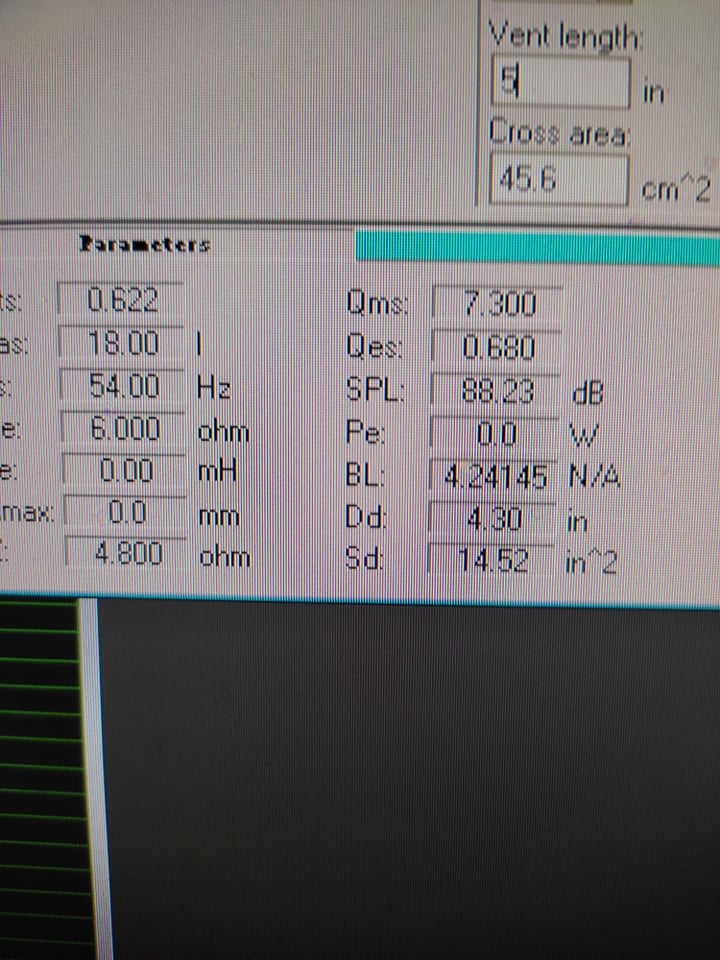

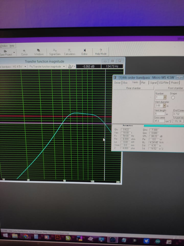

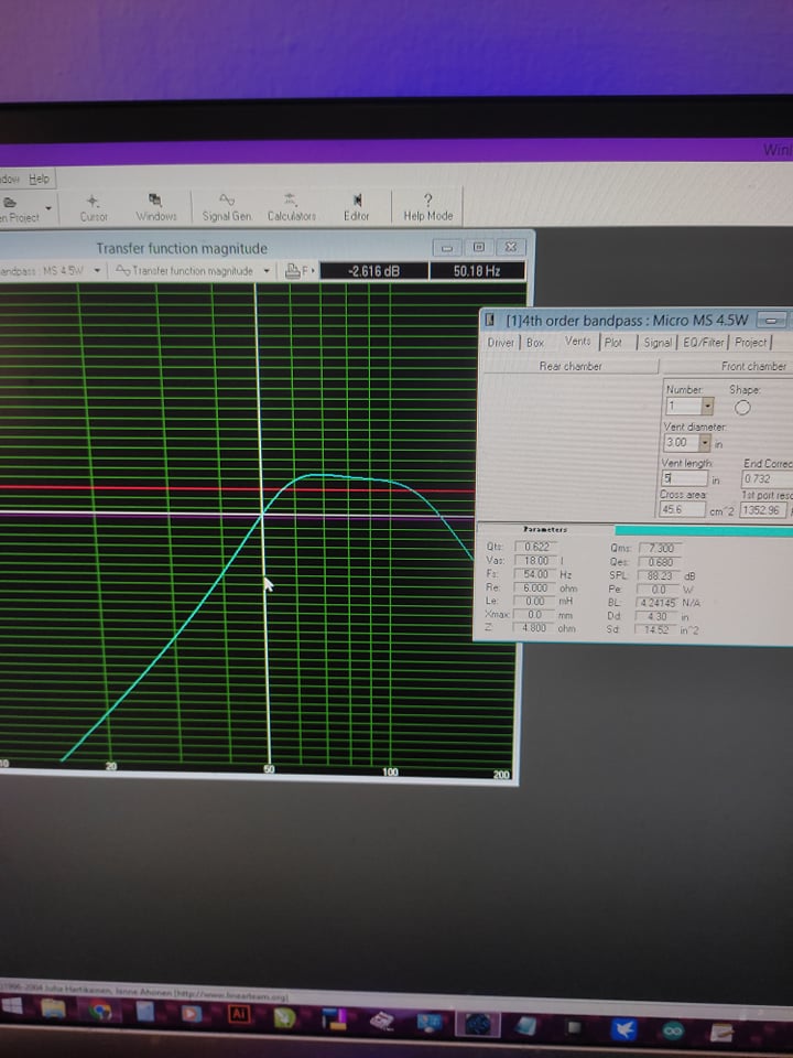

below another simulation with corrected data ... and the over excursion problem is still here ... the 13L sealed section simply not enough to prevent over excursion (passband 50Hz to 134hz) the upped passband was not too much a concern as i am using it with a subwoofer controller (Low pass filter) but it doesnt have a subsonic filter.

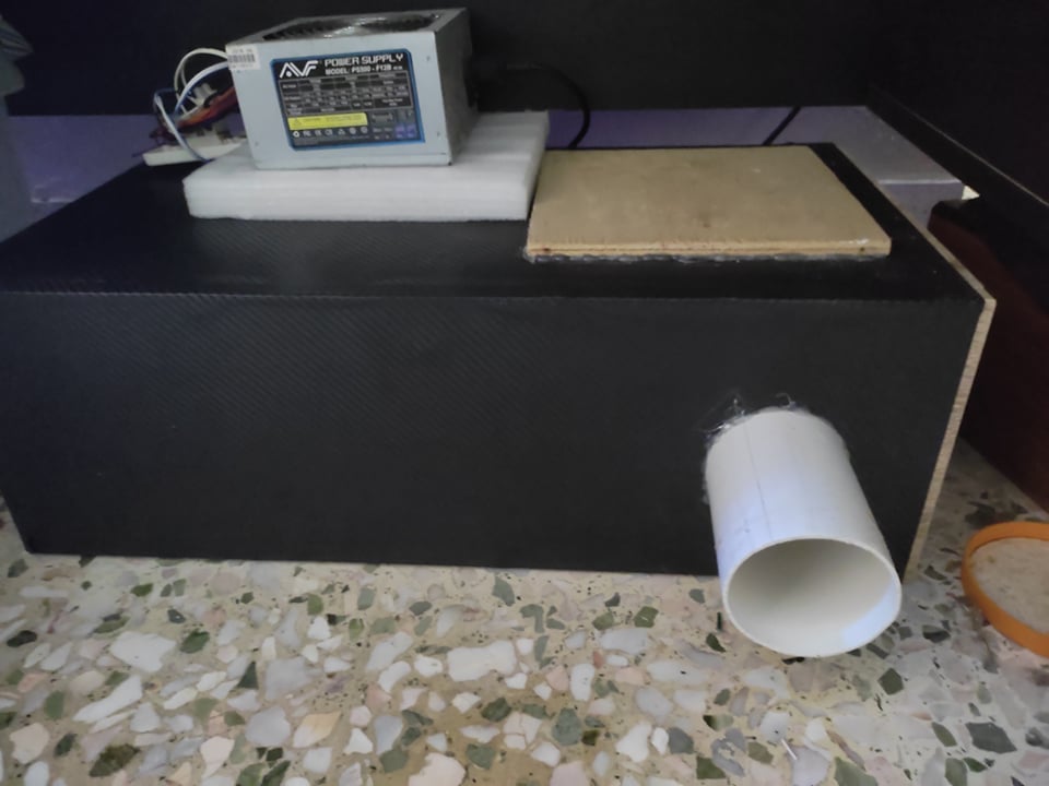

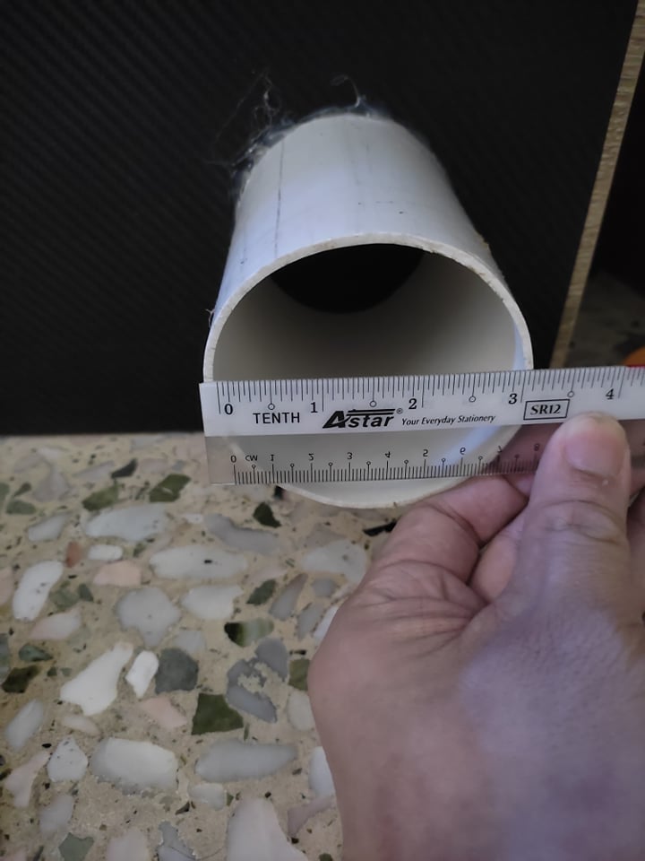

i've attached 2 graph from winisd with corrected data ... close snapshot of the parameters ... and there were 2 photos of a temporary test box of the 4th order bandpass enclosure salvaged from previous 4th order bandpass enclosure experiments. Sealed section 13L vented 12L with a basic 3inch pvc pipe as port extended outwards so it didnt affect the volume of the ported chamber. Over excursion and bottoming out still happens especially around 35hz to 40hz region ... uhh i thought that 4th order bandpass could control excursion problems pretty well?

With a Qts of 0.6 I think they require DSP to function best. Then the frequency response does not have to be flat any more and the cabinet can be designed as a compromise between primarily size and maximum output.
A 4th order bandpass box only controls excursion near the tuning frequency which is ~80 Hz. Expecting 35 Hz from a 4.5" woofer is realistic, though not at higher sound pressure levels than background music.
exactly what i am experiencing ... i dont have DSP but instead have a subwoofer low pass filter with modified shelving low end EQ ... when the shelving mode is turned on ... on certain bass tracks such as Bassotronics - Bass i love you = i heard even 35hz were reproduced and exiting from the port
but somewhat DSP or any bass boost approach is putting the driver in danger due to over excursion issue ... that is the point why i am against designed it in mind using a ported enclosure (my subwoofer controller doesnt have subsonic filter)
therefore i went into the approach of 4th order bandpass hoping that it will tackle the over excursion issue ... it did handle the over excursion issue better than ported but it still happening
Driver displacement increases 4x/octave, so small driver + low Xmax + high Fs = no low bass at any useful [peak] SPL without an incredibly large bass horn attached to it and even then it would only handle a fraction of a watt, though its base efficiency will of course be quite high.

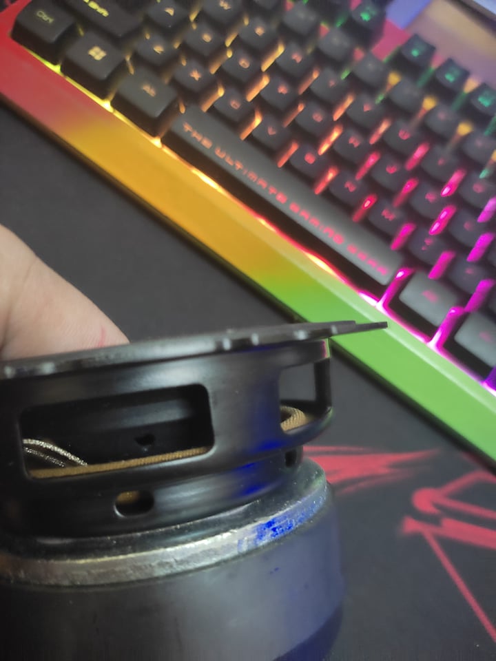

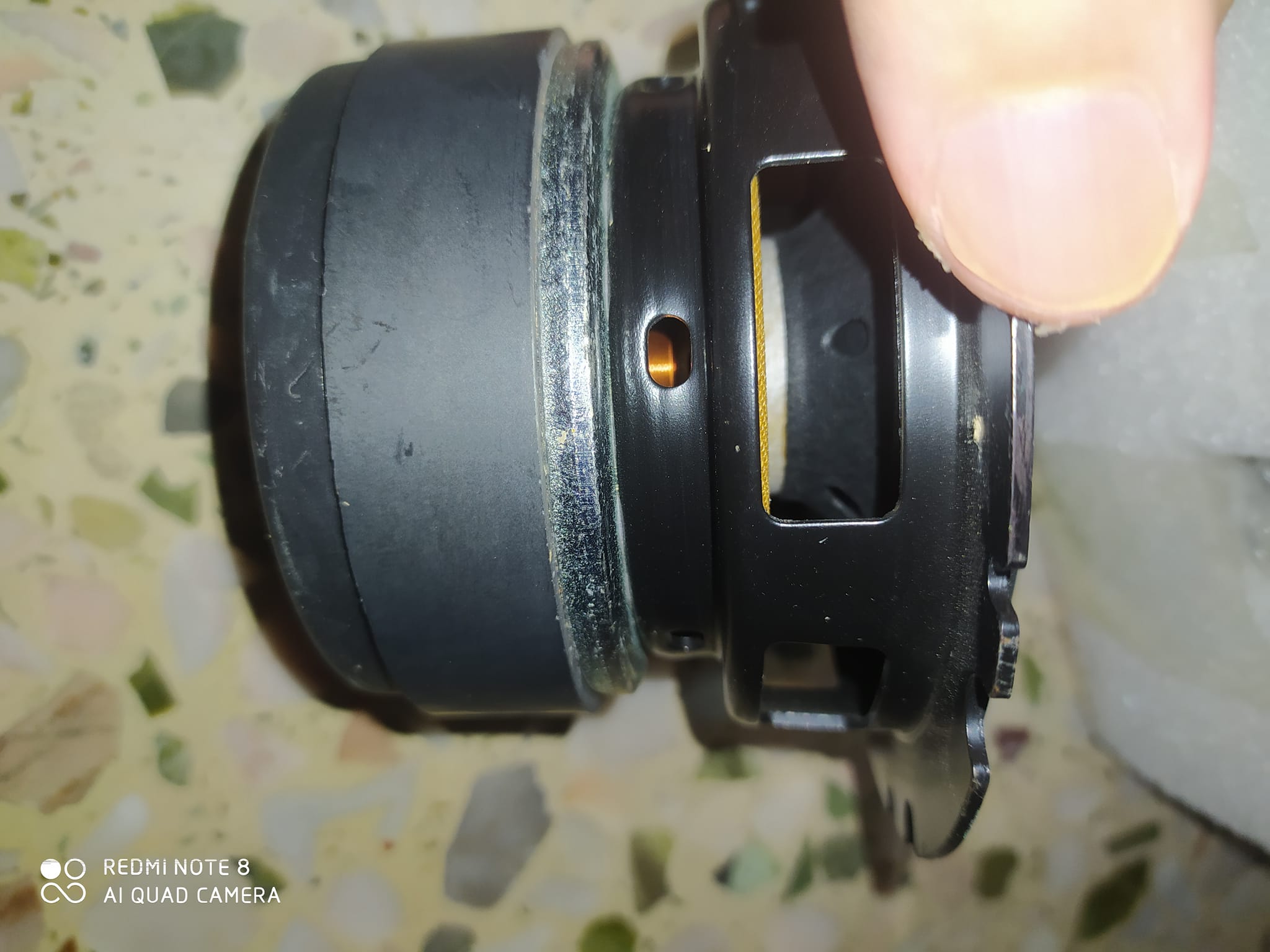

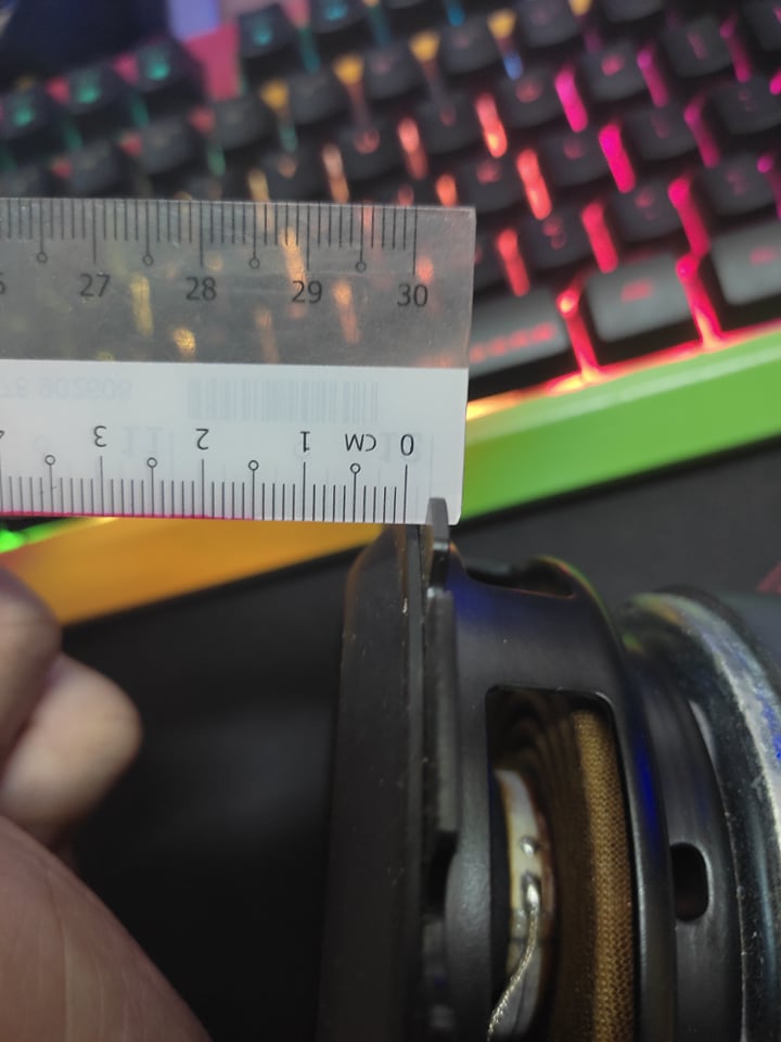

2 photos here ... one measured 5mm cone at resting position another one fully pressed inwards the surround roll is level flush = does it suggest one way xmax of 5mm? or this is xmech? this is another spare same unit ... the other one was inside the bandpass enclosure i guess it should be same the parameters

To test Xmax, I'd get the driver in free air, and hit it with a 20Hz sine wave. Start with the volume low, and turn it up slowly.
At some point, you'll hear the driver going "thud" at each end of the cone travel - that's a very obvious indicator that it's struggling to move any further.
Reduce the level to just below the "thud", and estimate Xmax from there.
It's not scientific, but it does give an idea of the capabilities of the driver. In the simulations, you'll know that exceeding that excursion is likely to sound bad.
Chris
Seeing what the xmax of this driver is shouldn't be too difficult. In fact you're half of the way there with this picture
971958d1628081864-microsub-redesign-4th-bandpass-enclosure-ts-parameters-208956123_3045678442312176_4005550138295215245_n-jpg
You can see the voice coil directly through the under spider venting hole. All you need to do is look through it and estimate how much coil length there is above the pole piece when the driver is at rest.
As far as I know, and this may have been mentioned before, this is the driver that is used in the original Apple Homepod. It uses a sealed box with plenty of EQ. I did read somewhere that the driver has 10mm of one way xmax but that seems a little too good to be true. Only way you'll know is to get looking through those vents.
