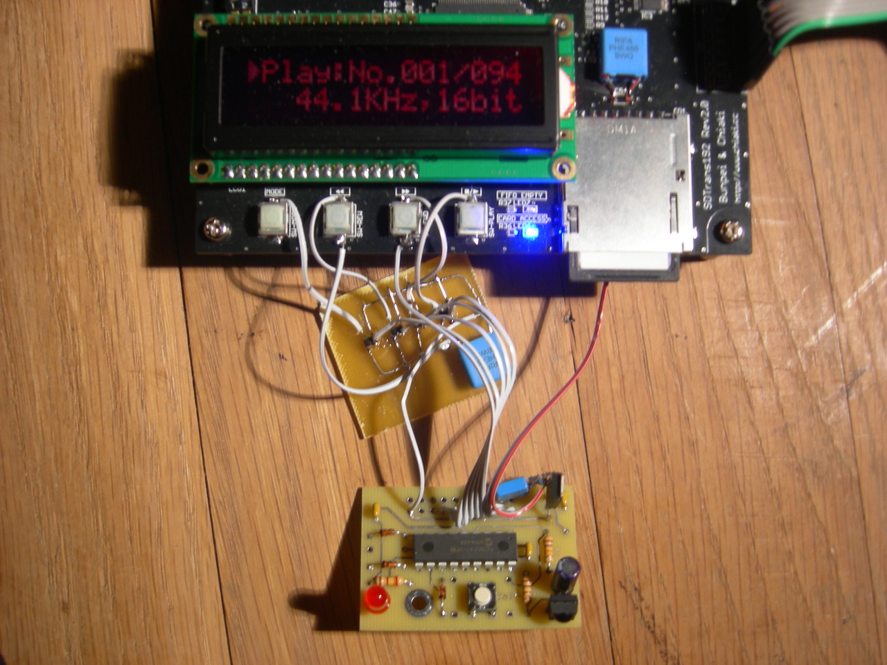

Yes, please hook one up and test it out. Would be much appreciated! Maybe you could take a photo of the setup that shows how you wired it.
I have a few remote controls from QLS Hifi that I used to use for the QA550
The remote control of/for the SDTrans are up and running..
Works great!
As the outputs from the TinyIR2 are low and pulses high a inverter to make a high that pulses low are needed.
I used the four small inverters seen in the picture.
A resistor will also need to be added in series to allow the buttons to work.
I used a JFET LU1014D as regulator at 3.6 volt (I run the SDTrans at 3.6 volts) - the standard regulator for the TinyIR2 cannot be used as it is 5 volt. A 3.3 volt regulator are needed to work with a standard SDTrans192.
I can post more information with component values and the configuration of the TinyIR2..
The remote control of/for the SDTrans using the TinyIR2 are configured with D2, D3 and D5, and uses outputs 4, 5, 6 and 7.
Connect the outputs via a series resistor (I will check value) to the buttons as shown on the picture. Hit the learn button on the TinyIR2 and program outputs 4, 5, 6 and 7 with the remote (buttons) you want.
Remember: Use a 3.3 volt regulator and inverters between the TinyIR2 outputs and the series resistors..
Dear Raytech:
I am very happy that you spent all this time and got it working:) Much appreciated!
Please post more info on component values and the config of the TinyIR2.
I have not used much time on this, but due to I myself controls the SDTrans directly from the uP that controls the DAC I needed to find some spare time..
I will post all info regarding this simple remote control of the SDTrans as soon as I have some time for it...
